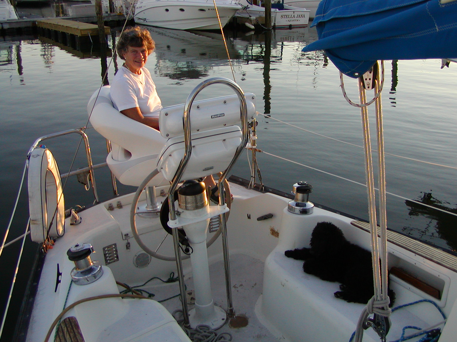

Not familiar with your boat but added seat to mine. Some of this may apply to your installation. Mounted my seat pedestal on the hatch cover. Seat slips on and off as needed to access hatch. Secured hatch cover by adding two more hinges and also two over center latches to keep the cover closed. Over center latches are from McMaster Carr.
Sep 21, 2020
124
Hunter 26 Lake Mead
That is beautiful. The issue with my boat is that the aft section is at floor level. I will have to find a tall pedestal or build something to add height.

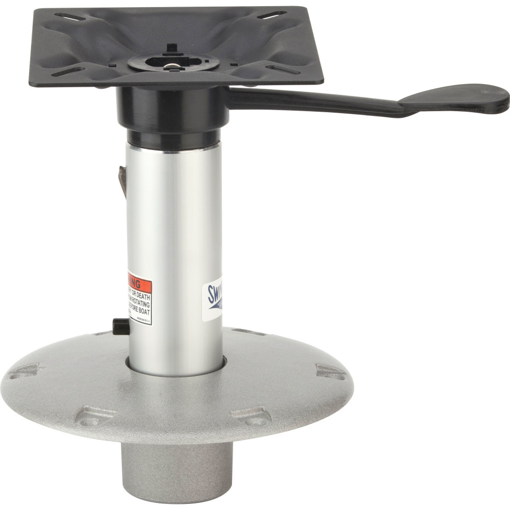

Do a google image search for pedistal mounted seat. I just now did one and found this right away...
The entire thing just slides out of the base.
