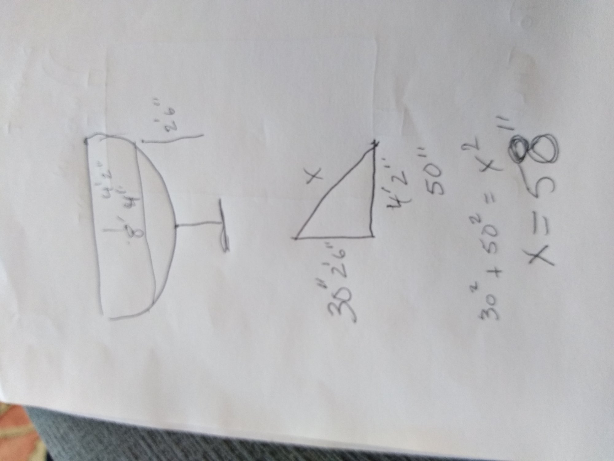

Hello All, I have a 94 Catalina 22 with a wing keel (not an MK II) that I am going to install an depth sounder. In order to program the sounder to register the distance under the keel vs. the hull I need to know the dead rise from the keel to the hull. This is given as an angle and the boat is in the water and It would be hard to take the measurements as is. Does anyone have the information concerning the dead rise on my boat?

Yes, I know the draft. However, this is not the "dead rise". The dead rise is expressed as an angle from the bottom of the keel to the water line.

OOPS, my bad. the dead rise is measured as an angle from the bottom of the keel to the chine, not the water line.

The wing keel on my Capri 22 is 18" from bottom of hull to bottom of keel. I believe it is the same keel, different boat. Ask Crazy Dave, he knows.
