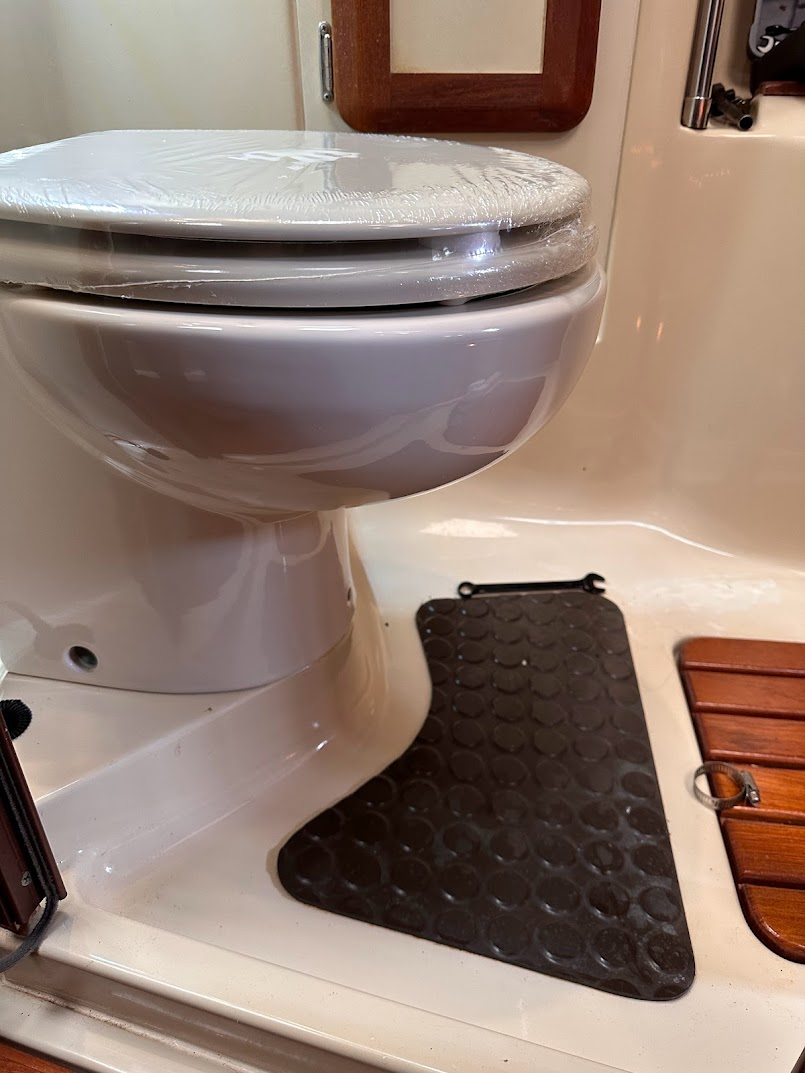

The toilet does fit in the forward bathroom fine. The aft overhangs the step by about 1in. I am in the process of making a wooden extension to bolt on to extend the step that 1in.

Here is the clearance for the forward toilet. You can also see how the bone color matches. You want the bone on this boat for sure.

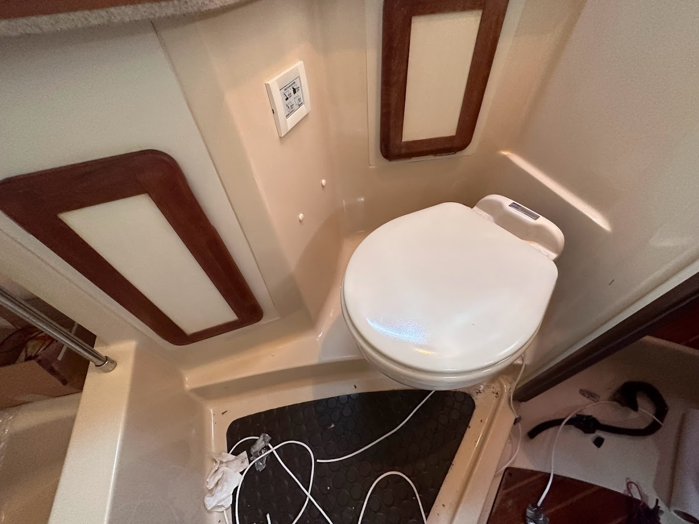

Aft Head

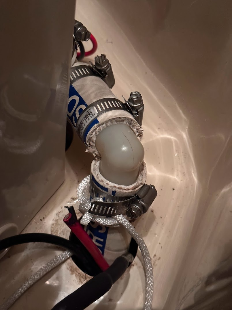

For the AFT toilet to KISS for now. I had to make a disaster of a fitting to get the plumbing to fit. The forward was easier than the aft.

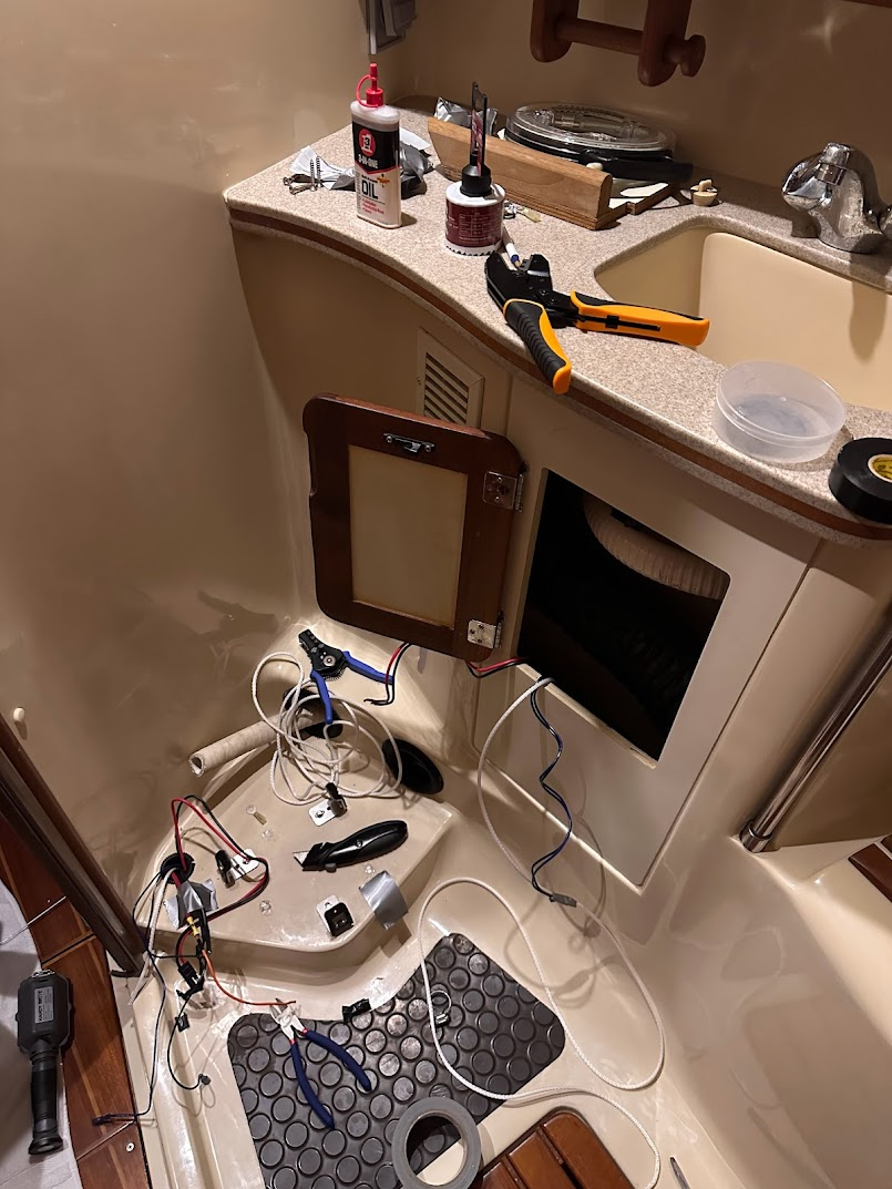

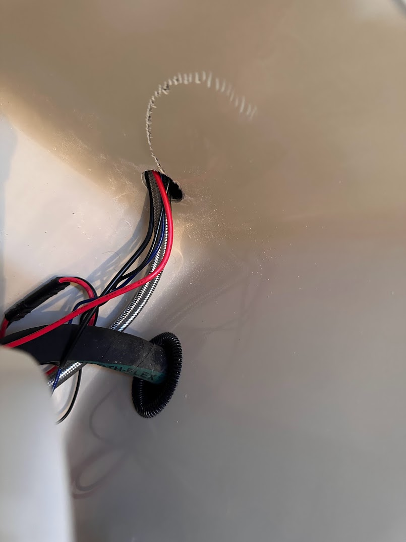

It was a real problem getting everything run / re routed. Both the power and the hoses come though this hole.
I ended up using glow in the dark fish-tape and a lot of patience to fish rope though to be used to pull lines though.
I ended up "U Turning" the power lines into the cabinet for the electronics. it was too hard to route wires directly. What i mean by this is I crimped on a length of wire where the wires came out originally, and ran that into the cabinet, almost making a crimped U turn. All oversized and marine waterproof connectors.
I drilled a hole next to the toilet for the fresh water and power. You can see I screwed up... Thank god you cant really see it.

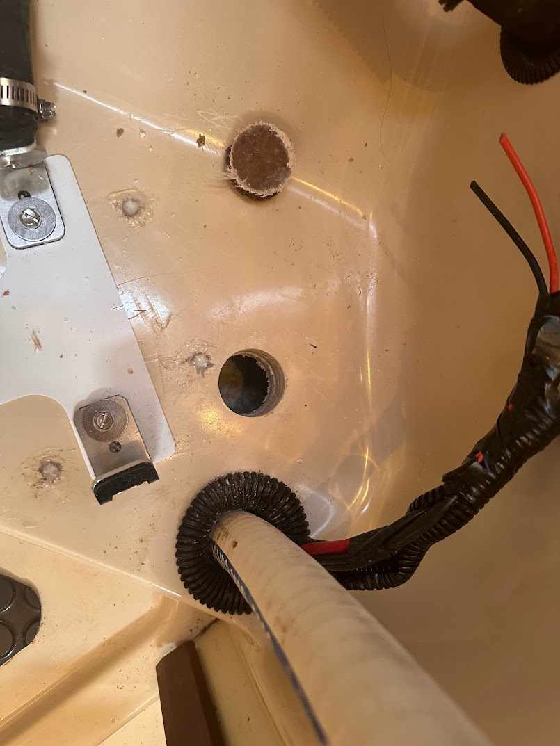

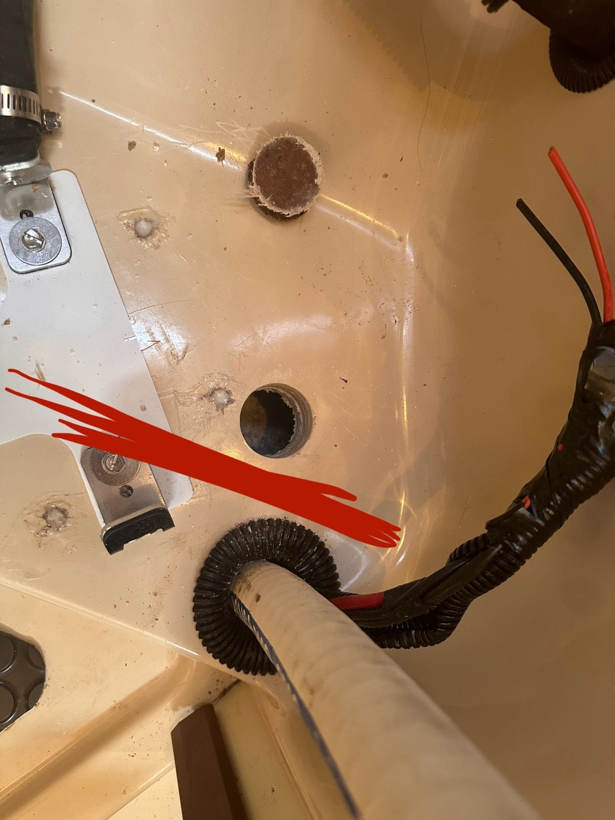

OK so this part for the aft toilet is really stupid... I mistakenly drilled a hole that lines up with the toilet properly... However... THERE IS A F**CKin BULKHEAD between the original hole and the new one... so NO you CAN NOT easily route the sanitation hose to where it should be.
So I ended up with this monstrosity for now. With a big sign that says. You clog it, you UN-Clog it. I do plan on revising this.
