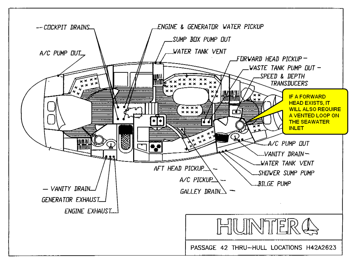

The previous owner of my boat replaced just the last 4 feet of his sanitation hose and I am going to replace all of it. Looking at the diagrams in my owner's manual I do not see a vented loop in either of my discharge hoses and of course not all of the hose is visible. Can anyone confirm if there is a vented loop?
Jan 4, 2006
7,223

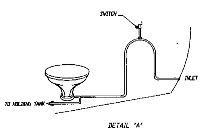

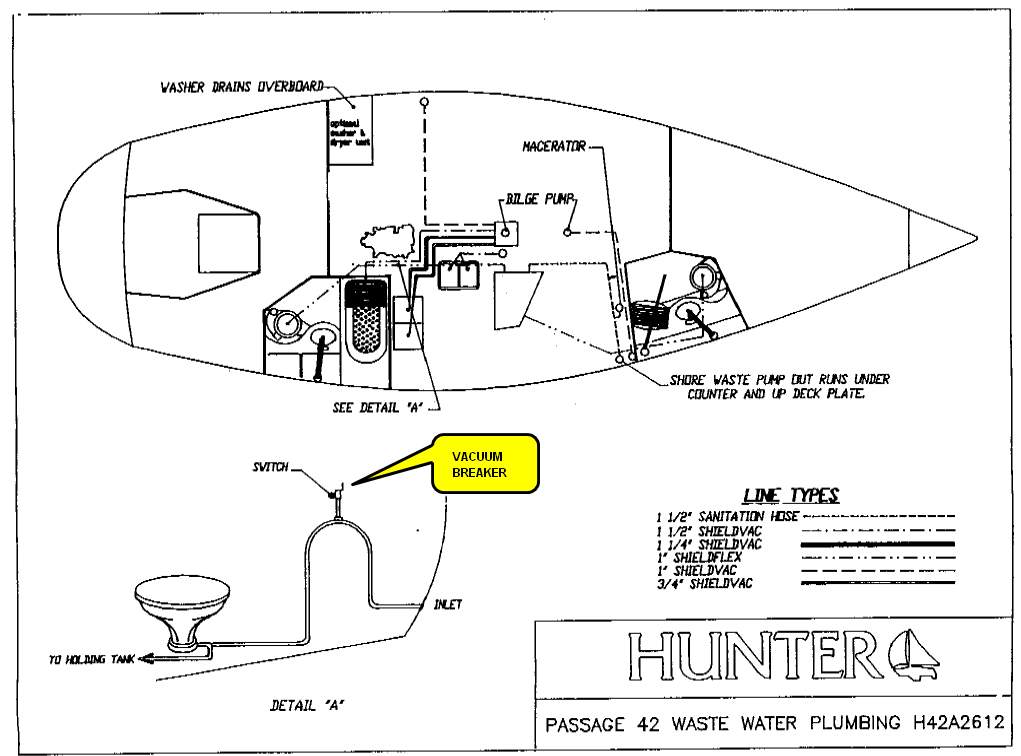

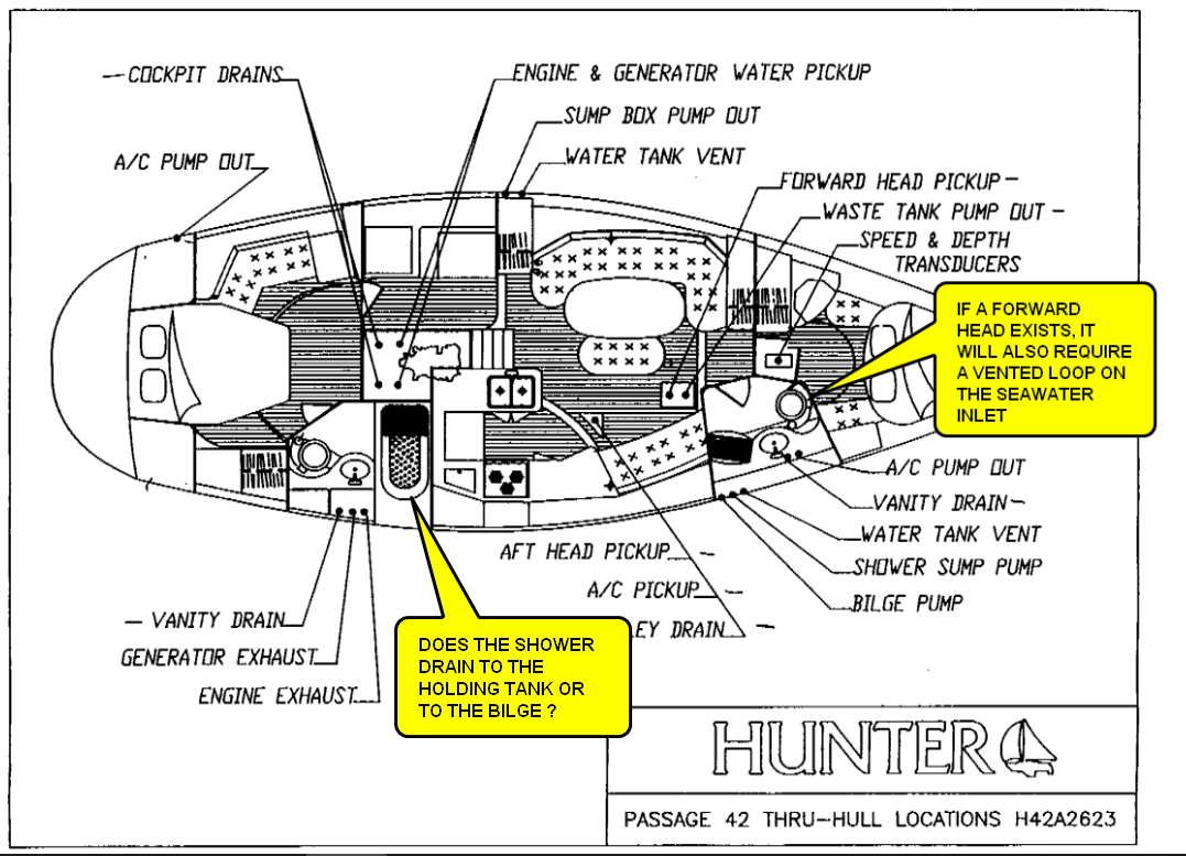

Looking at the waste water drawing :
................. the only vented loop would be for the sea water inlet to any head as it could find itself below sea level and the bowl is not a sealed vessel. It is not clear if a forward head is included in this model of Hunter, but if it is, it must be treated the same as the aft head with a vented loop on the sea water inlet :
The macerator pump does not require a vented loop as the holding tank is a sealed vessel.
The head sink(s) and galley sink(s) drains do not require a vented loop as they are well above sea level.

It flows into a "catch" in the bilge with its own bilge pump. The only lines into the holding tank are from both heads.
I did not think there was a vented loop anywhere but in the intake lines.
I am about to attempt to install a new sanitation hose starting with the forward head. I am guestimating the run at no more than 15 ft. Any help on whether I am accurate or not is appreciated

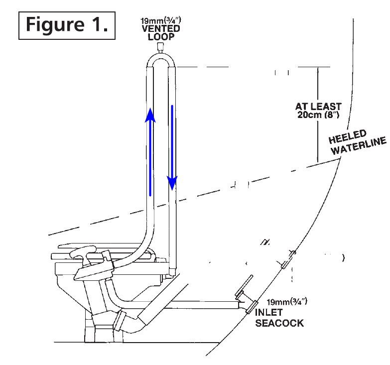

The intake vented loop is in the wrong place. As you'll see in the installation instructions for every manual toilet, it' belongs between the pump and bowl, which requires replacing the short piece of hose the toilet mfrs used to connect them two pieces of hose long enough to put it 6-8" above water line AT MAX HEEL, not just when the boat is at rest...which on most sailboats puts it 2-3 FEET above the bowl.
Ralph, I'm guessing that your waste water plumbing drawing shows a vacuum breaker instead of the air valve should be in that vented loop because it is in the wrong place and you--or maybe Hunter--found it necessary because otherwise it would interfere with the toilet's ability to prime.

Hi Shaggy! Vented loops are not needed in any toilet discharge line that ONLY goes to the holding tank. They are needed in any line that connects to a below-waterline thru-hull...toilet direct overboard discharge and/or holding tank overboard discharge and they need to be at least 6-8" above waterline AT MAX HEEL, same as the one in the toilet intake line.
No vented loop on the discharge lines (not needed IMHO), but do on the intake lines. The one for the forward head is located through a removable panel. Go to the most forward cupboard in the main cabin and on the left hand side of it you will see a removable panel. The vented loop is in there. The one for the aft cabin is in the engine room; and it is not the one on the starboard bulkhead next to our Genset. That is the one for the main engine.
As far as the length of discharge hose for the forward head, 15' might be a safe bet. I have replaced our aft cabin discharge hose due to a clog. That was quite the ordeal. And the aft shower drains into a sump box below the companion way steps.
The overboard discharge macerator pump does not have a vent loop and does not need one IMHO. Others might disagree, but as long as you keep the valve closed until needed, and close it when finished, no problem. If you leave it open it will fill the holding tank as it is below the waterline. Ditto the sea water valves for incoming flushing. Those I keep closed until needed.
Just typing faster than I'm thinking because my vacuum breaker is exactly where you describe it in the loop, between the pump discharge and the bowl.
My only other defense for this gaff is that I was in the process of breaking up a fight between our parrot and rabbit. The rabbit had a piece of apple and the parrot wanted the apple just because the rabbit had it first. Everybody has their own %$^#& piece of apple. Worse than little kids.
I see in the Passage 42 setup, an electric air inlet valve is required and NOT a vacuum breaker because obviously a vacuum breaker wouldn't stay closed on the pump intake in this application. A less than ideal setup IMO as it just adds another electrical device to fail. A vacuum breaker on the pump discharge would be a simpler installation. My loop is located within a back wall to eliminate the loop and breaker being LOCATED out beside the head.

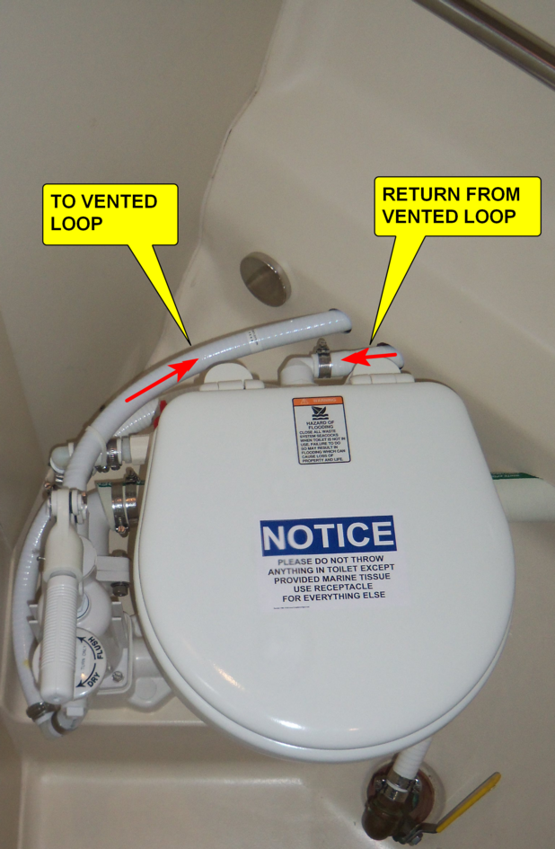

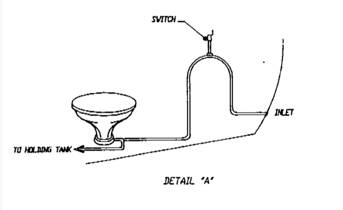

@Terry Cox , do you have the electrically operated air valve on your sea water inlet located in a loop immediately after the thru hull :
or is it a vacuum breaker located in a loop and situated after the pump :
Hi Ralph. I think so. Unable to say for sure, as I've never really dug into it. The forward head valve is in a difficult location and as long as the toilet works, no need to pursue its operation.
