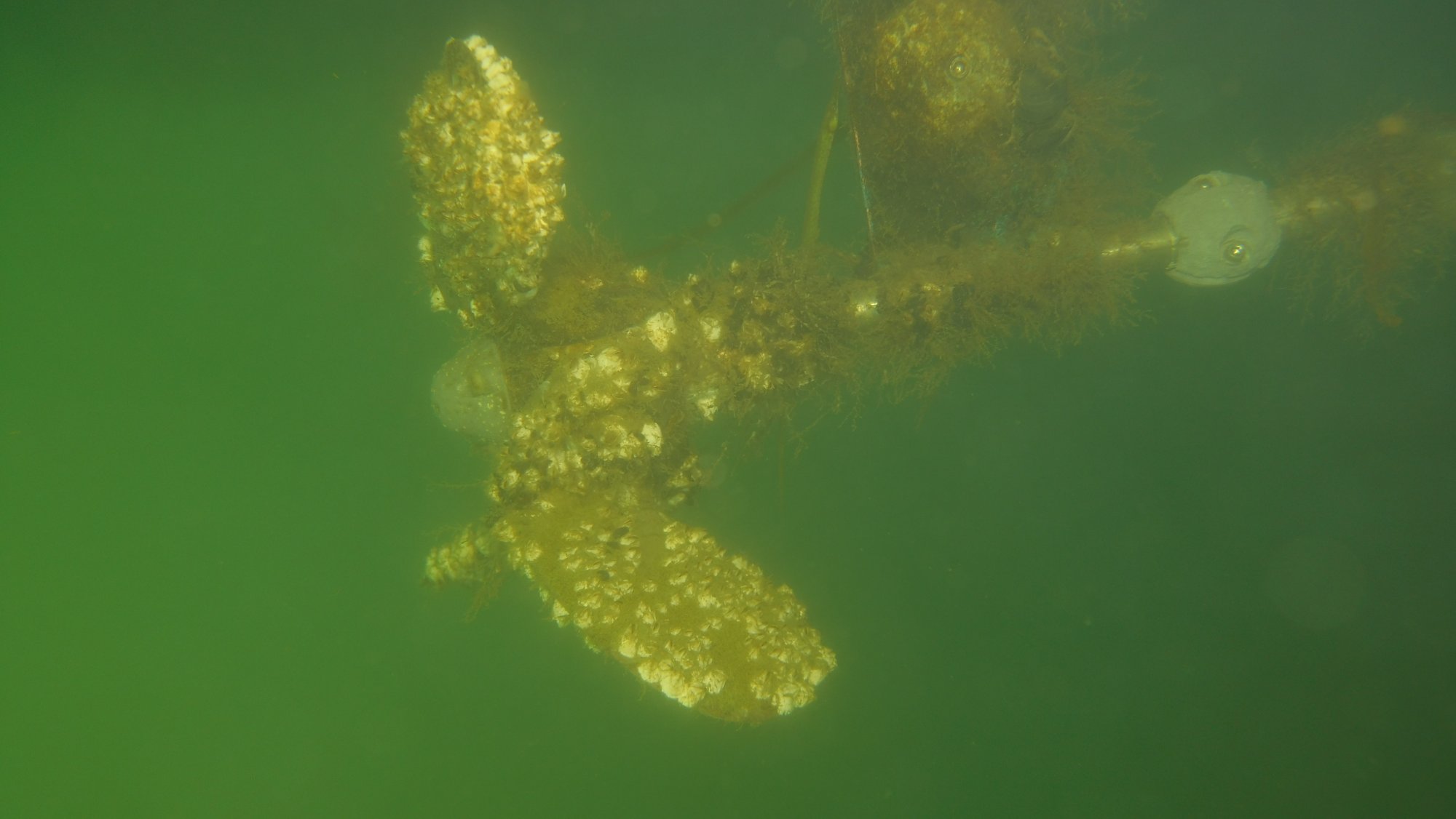

The fact that the owner pays someone to dive the boat every three months does not necessarily mean that the bottom and prop are clean. I speak only from my personal experience many years ago based on a quick dive to inspect the results of a diver when I experienced similar low revs and vibration. I guess he was banking on the assumption that no owners would brave our 55º water to check up on him.
That is why I dive my own boat now.

This is my prop 5 months after the last time that I paid a "professional" to dive my boat. The next time the boat was cleaned was 6 months later after the full summer of no use due to work obligations. With proper cleaning and removal of all of the white barnacle bases down to bear metal, the prop only have a very few small barnacles and took very little effort to clean.

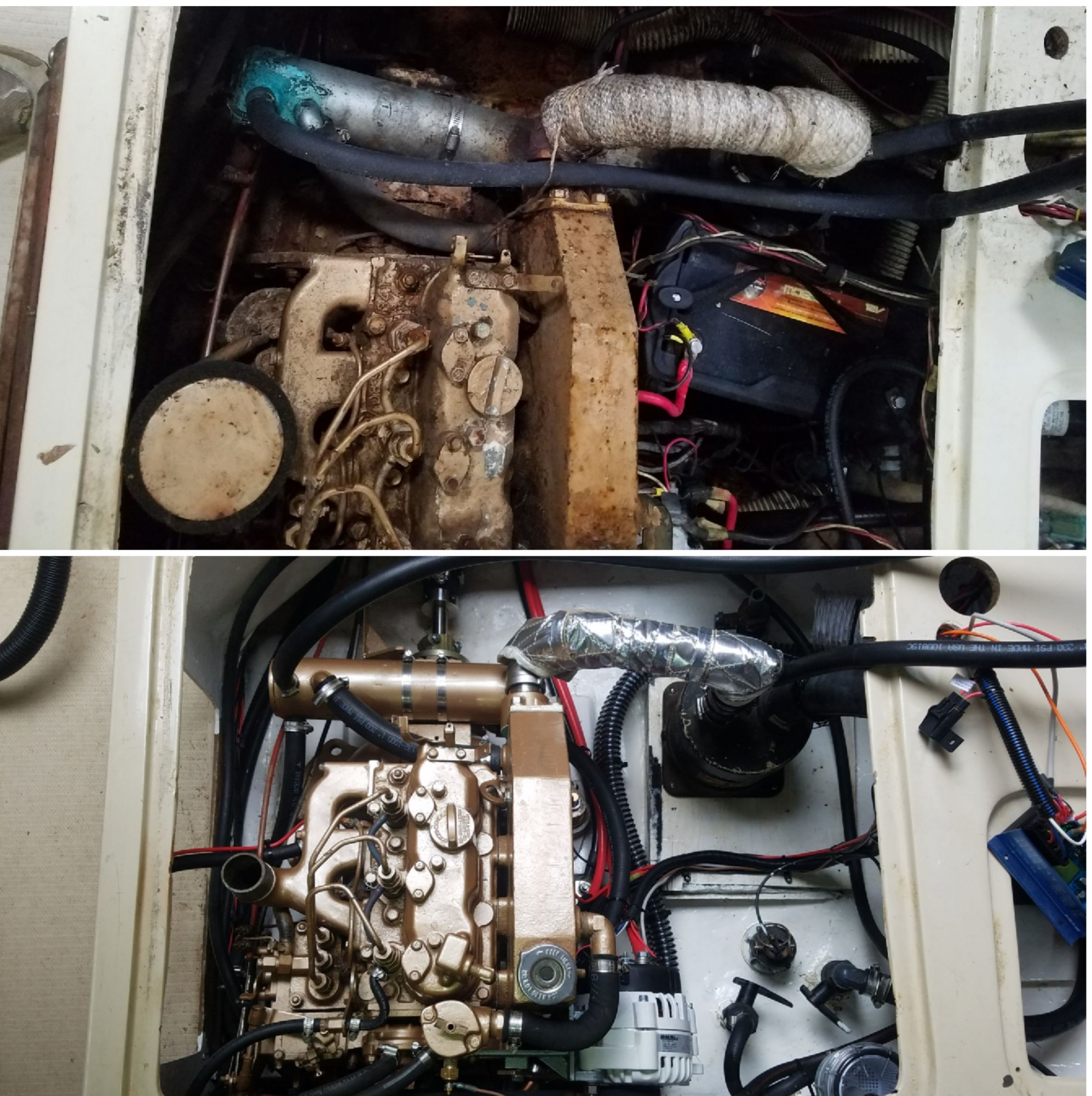

Don't be so fast to rush to a repower. My engine is a 1984 Universal M25 with 689 hours on it. I just purchased the boat a year ago, did some basic maintenance on the engine, upgraded the alternator, replaced the exhaust riser, rebuilt the coolant pump, replaced the impeller (all just normal maintenance stuff) and it runs great. I'd go through all the basics like you said, because as long as the engine has been decently taken care of it could last for a vey long time.
Jun 7, 2016
315
Catalina C30 Warwick, RI
This is a before and after picture of my engine. I also removed it and sand blasted and painted it, but if something that looked like this still runs strong and reliable you could be just fine.

Actually, 1000 hour engines of that age do exist, some people use their engine very little each year. I looked at two boats that age for purchase one with 75 hours and the other with 150 hours and judging by the condition of the engines, I believe them - they were immaculate with perfect paint everywhere and not retouched, all original. Super low hours like that may not be a good thing, depending on how often and how it was run. Post a picture of the engine if you get a chance, it should look pretty good if it has 1000 hours and was maintained.

It looks far from good.
The whole boat has had years of neglect. Whilst I can see thru the general grime and verdigris and am confident I can remedy, not so the donk.
As you say, if the engine has only been used to get on and off the mooring, then it has probably never got up to sustained operating temperature and raises the likelihood of cylinder glazing and other nasties.
