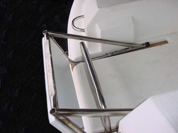

No transom??
I made it out of an old swim ladder. It required a little bit of reinforcing and modification under the swim platform, but it makes me feel better to know I have an alternate means of propulsion when I go down the Mississippi River. Normally the transom will be stored in the lazarette and the outboard motor will be on the sternrail or the dinghy.
