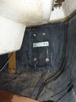

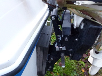

The previous owner had put a piece of half inch ply inside the hull and behind the lightweight motor mount on the stern of the boat. The plywood was beginning to show its age and it was a smaller footprint than apparently needed for the new motor mount. The newer motor Mount also need to be placed 2 inches further away from the face of the stern in order to operate the motor properly. Rather than building out from the stern with an elaborate waterproof plywood and fiberglass assembly I chose to just go with composite decking boards and longer bolts. That solution also allows me to take the new motor to the new three foot longer boat without changing the Mac from its original configuration.
