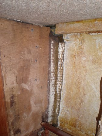

I bought a 1981 S2 9.2A this spring. Prior to purchase, the surveyor noted that both main bulk heads needed repair, due to leaky chain plates. The port side was badly damaged, while damage on the starboard side was more limited, with only the aft doubler needing replacement. Dennis did a good job and took some nice photos. The surveyor approved of the repair and we went ahead with the purchase. One thing not visible, is that Dennis sealed the edges of the plywood before installing. This design with the doublers (smaller sheets of plywood sistered to the main bulkheads) really allowed for a nice cosmetic repair as well. I could have done a nicer job matching the stain though ;-) I'll have to post some photos of that later.
