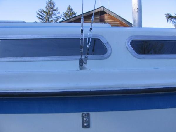

I did find these turnbuckles on Defender's closeouts.
But a bit of careful measuring to be sure they'll fit your existing set-up would be in order.
I've made a tool to allow better leverage on the shroud tangs than the screwdriver and marlinspike method.
It's basically a long-ish two-tined fork with bolts and wing nuts set in one end of the contraption. Distance between the bolts corresponds with the distance between the shroud adjusters near their top end.
From this thread:
