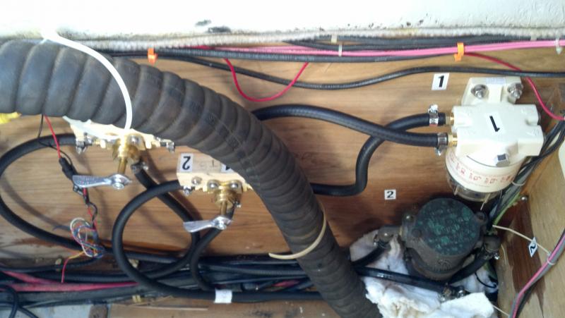

Added a 2nd parallel filter
I have an 87 LE, and have had gummed up (read engine stop) fuel filter twice in 2 years. Decided to end it. I removed the tank (had to cut about 1/3 of the bulkhead in aft bunk) and cleaned it out (there was some crap in the bottom). I got a Racor spin off and 2- 3 way valves. Now my fuel comes out of a clean tank, and runs through the Racor. if the Racor gets clogged, I can switch the 3 way valve and run through the pre-existing Groco. I have spares for both the Racor and Groco. I placed a 3 way valve before and after the two filters, so I can isolate them.
BTW, the only shutoff I could see was on the return line at the top of the tank.
Hopefully, my days of a dead engine due to fuel contamination are over....

Mickstr6 - I see you mounted your new filter close to top of lazarette. I've read that diesel engines require a downward angle of fuel line from tank to engine. I'm assuming a gravity fed fuel system, not a vacuum fed fuel system. How does your's work with filter mounted high? OK...? I'd like to place mine higher than the Groco (now removed), but didn't know if that would affect fuel delivery (my first diesel system of any variety - boat, car, tractor or anything). With higher location, I wouldn't have to stand on my head to mount or service the Raycor (or cut through teak panel to get to lazarette).
Testbeds - tank is empty of fluid. Not sure what else is there. Took off Groco and no liquid came out of fuel line. Think I'll leave it at that w/o tryig to flush/polish. Raycor will catch anything coming through. Rough weather sloshing fuel to stir up trash - I don't go out when winds are predicted to be over 15 mph. Also have extra fuel filters in case they do get plugged. Raycor has see through bowl so sediment should be visible.

Well Cbourne200, I haven't fired the engine up yet, but I don't anticipate a problem with the height of the fuel filter. The fuel system has an electric fuel pump, so not gravity fed...Guess I'll find out! Have to finish a deck repair and then I'll be splashing...

Yes, realize there is a fuel pump w/filter on engine. Didn't know if that would overcome lack of gravity feed, but assumed it would. Have not been back to boat in almost 2 months (mom's b'day, birth of 2nd grandson, brother has COPD so need to visit often before he's gone, and grand daughter's 1st b'day was 5/25). Want to do it 'right first time' so I don't have to redo it. Hanging upside down in lazarette is not my idea of fun. With filter at your placement, would be much easier to install, see, service...

Mickstr6 - hope you're splashed by now and know that your setup works great! I followed your advice and mounted it high (easier to see/drain/replace if necessary). Had a little trouble getting the 1/4" fuel line from tank over the 5/16 barb, but think I have it far enough to not be a hazard. That was on the fuel shutoff valve I also put at same height as filter. New 1/4 hose went on 5/16 barb without a problem.

I've had it out a few times. Had a few small fuel leaks at the valves, which were mostly fixed by tightening the connections. The two last small dribbles seems to have been fixed by adding a 2nd hose clamp on the fuel line to 3 way valve fitting. Overall very happy I added the 2nd parallel filter. Gravity issue you referred to seems to be non-existent.
