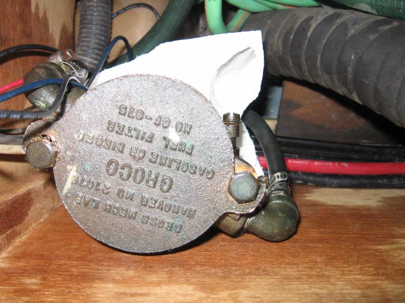

I took Groco body apart earlier looking for a filter, and found nothing inside. It definitely is connected to fuel line - lost about a cup of diesel into bilge since I didn't have a fuel shutoff valve. Was told later by other list members that this filter cost about $50.

From the pictures, it looks like where the Groco filter housing is would be a good place to install a new Racor filter/water separator.

Can't say I've ever seen a groco fuel filter like that, but it must be a water separating filter. I did a search on the net and found you a filter element for the Groco filter for 35 bucks. It looks like you already have what you need in your boat and don't need a new filter, you just need to put a filter element inside the housing. The housing has a plug on the bottom to drain off any water, so you should do that regularly. I never knew Groco made a filter like that so I stand corrected, learn something new every day. Note the Racor elements are about 22 bucks so this is a better deal for you to just get the element, you can change it for twenty years before you'd eat the cost of a whole new filter assembly from Racor.
Groco Filter Element For Gf 375 GRO-GF376
Groco GRO-GF376

Replace that Groco with a good Racor. The Groco's are simple filters not water separators. The 120 series would work fine but I generally prefer the 500MA series.. Use a 10 or 30 micron in your new primary filter..

I have an 87 272 and in the lazarette is the groco water fuel separator, and there should be a filter in it:
Original part number : GF-376 (link: http://www.groco.net/07-heatex/gf-376.html )
2-5 micron filtration separates water and sediment from fuel.
It's 3.5" high x 2" Dia. with a 0.5" dia. hole on top.
You can find it online at most marine supply stores

That Groco filter/seperator though bronze is a pain to deal with. Elements are expensive and it is hard to get new O ring to line up in groove before putting on cover. Mine leaked air into the system and prevent the engine from starting. I plan to replace it with one with a see through bowl. Also there is a shut off on top of the tank in the pick-up line. Stupid place! I removed mine and installed one just up stream from the Groco filter.

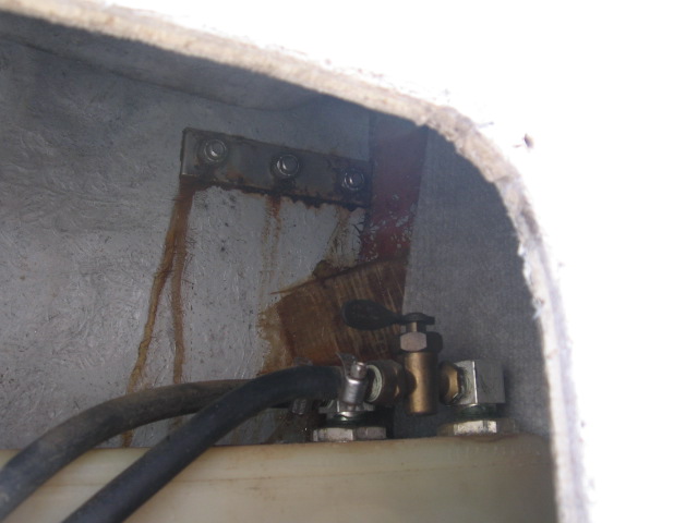

Fuel Shut Off..........I've found you! :dance:
With camera in hand I removed the instrument panel and clicked a picture. There is a fuel shut off valve on the top of the fuel tank in the 272LE. I think I will follow the suggestions made here in earlier posts and change the bronze Groco filter to a Racor and I will add a shut off valve in the same area. Now, should the valve be after the filter or prior to it?

My plan is to do same Tedsbeds. Thanks for the help.
Phil - I would place shutoff between tank and filter, so when you need to change filter, you can shut off fuel flow...

While Groco describes these as "water separating" filters I don't personally consider them as such. I suppose because they put a drain plug in the bottom, and use a treated paper, they feel that qualifies? I consider a water separator to have the filter media well out of or elevated above the bottom of the filter housing where water will collect. The Groco element is nearly the full container length and as such can sit in water. Water is bad for this filter media and can eventually cause it to break down. Another issue I have seen with them is the metal end caps of the filter element rusting when water gets into the bowl. This can make a real mess. Perhaps they've changed that design by now????
A Racor 120 or 500 series has no metal in the filter element. With no sight bowl it can be very tough to discern whether or not there is water in there and it becomes a real crap shoot as to when to "drain it"... With no easy opening drain valve, as Racors come with, you are forced to remove a threaded plug to drain the bowl. This can make a huge smelly mess if not very careful. Ideally these should be fitted with a drain off valve, but most are not.
Also the cost of the filters is quite steep. With a bad batch of fuel you could easily spend darn close to what a Racor costs, or more.. Even on sale at Defender the Groco elements are $40.50 and a brand new Racor 120, with a filter is only $70.00... Add a new filter and drain off valve and you've just paid what it would cost to buy a good Racor filter with sight bowl...
