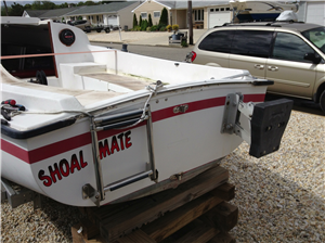

This is a picture of the VP of Communications transom.
Mariners have a hollow space between the outer transom and the cockpit transom. The 192 may also. Backing plates are strongly recommended.

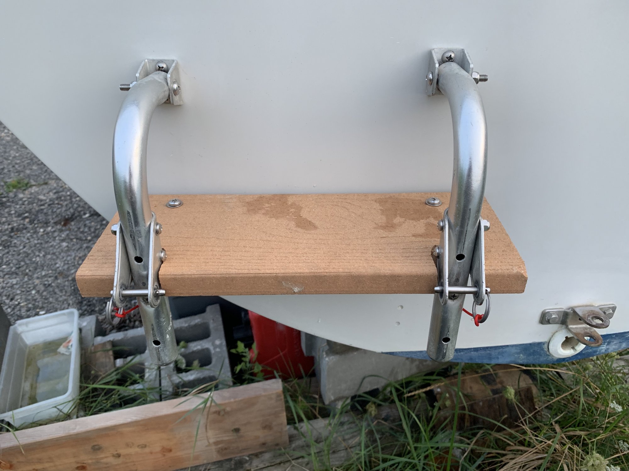

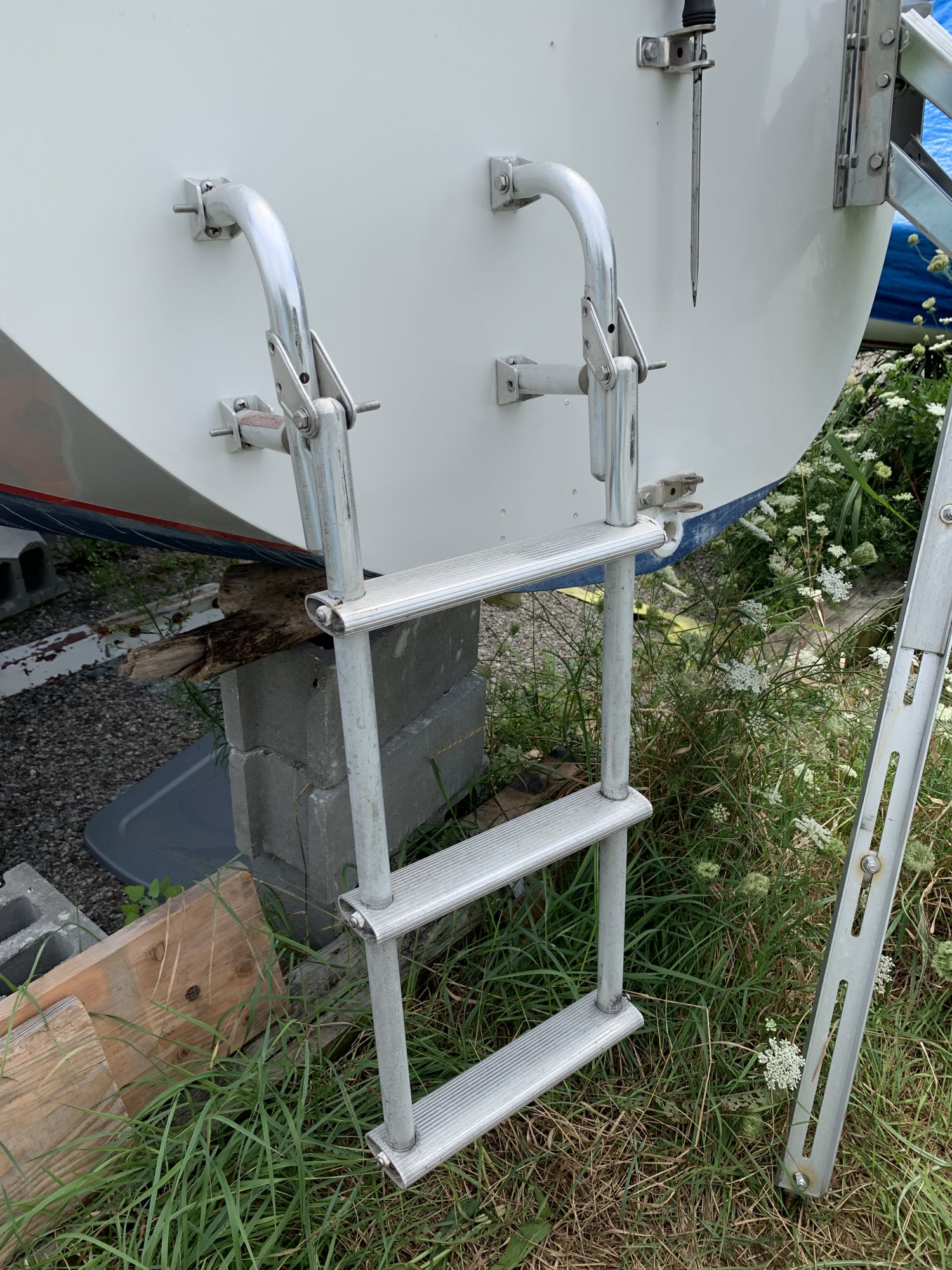

I made a mini swim platform with a detachable ladder on my 192. The little step / platform is good enough most of the time but the ladder is attached with quick pins if I’m in deeper water or have someone not as nimble trying to get back in.
Original ladder:
Version 2.0
