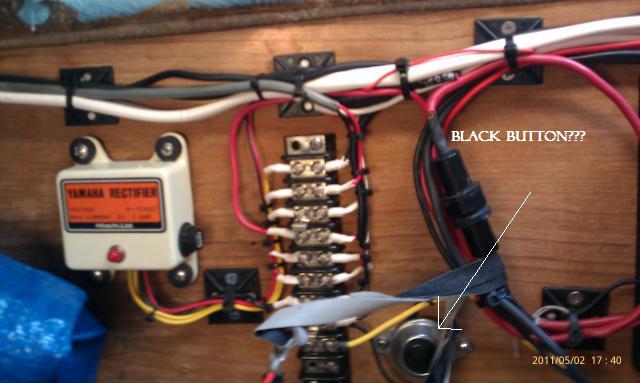

In one of the attached pictures I have included on this thread, you can see a black button next to the yamaha rectifier and the set of wire connections. What is this black button? What does it do? It is just a standard spring resistance button. You press it in and it comes back out. It does not click into place when you press it or anything. Just a simple black button.

I'll take a shot at guessing, but to know for sure you'd have to trace the wiring or turn on the power and see what happens.
A momentary switch like that might be used for a horn, or it could be for an electric bilge pump, the pump may be wired for automatic operation direct to the battery but you may also have ability to manually turn it on with a switch like this. It could also be to empty a holding tank with a pump. You want to only be pumping while you activate the switch. Can't think of much else you'd want that kind of switch for. Anyone else have other ideas?

By the way the rectifier works as follows...the alternator on your motor puts out AC current. To charge a battery it needs to be DC. The rectifier converts the power from AC to DC.

Those are pretty good guesses, Jibes. We will find out what that button is good for whenever I setup power in the boat.
I guess for the rectifier to work, I must plug in the charge chord that is attached to the outboard, into the charging port that is on the back of the transom on the boat.

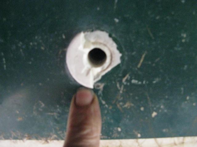

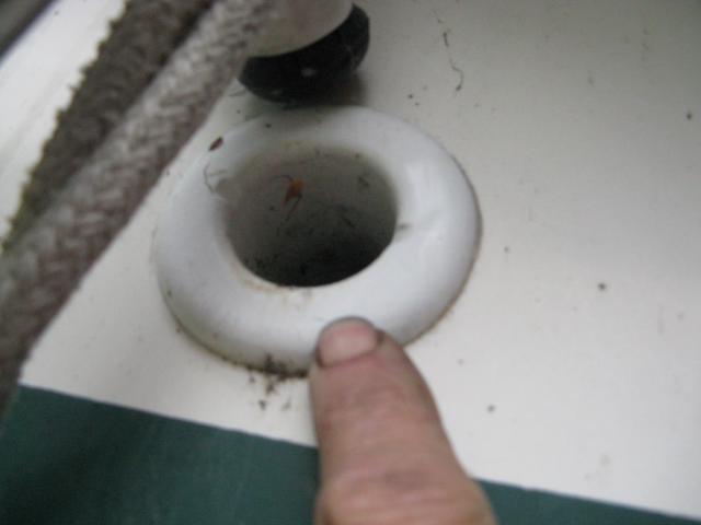

Hi RL. Just as the name implies they are fittings that go through the hull. My 27 has ten years on yours but has been in a cloudy northern area. Here are a couple of pics of one intact and one busted due to UV sunlight brittleness. They have a nut on the back to tighten them to the hull and a serrated end for connection to a hose. Take JK's advise and pick yourself up some new ones for peace of mind.

RL, on my friends 272, the ones below the waterline were fine. It was the one above the water line that was subject to UV damage that gave us an issue.
However, it is really good practice to inspect the thru hulls and the seacocks regularly. If you PM me your email address I can send you a copy of a pre-launch checklist I have with all of the things that should be checked each year. Most of the items should apply with the exception of the diesel stuff but you have similar things on the outboard (like changing the impeller and lower end oil). In the NE, we pull our boats for the winter and that gives us the opportunity to check some things that you might not have access to while in the water but most of the things can be done in the water. The others you can do every couple of years when you pull the boat for bottom painting.

My bilge pump through hull that goes out the transom was made of plastic and it had almost broken completely off after about 10 years. Real nightmare to get at it. I tried to replace it with bronze but the angle and limited space under the swim platform wouldn't let the bronze one fit so I put a new plastic one in. Good idea to keep a close eye on these.

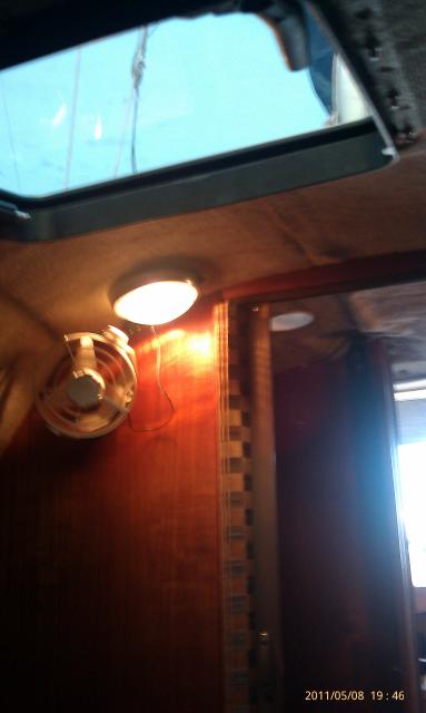

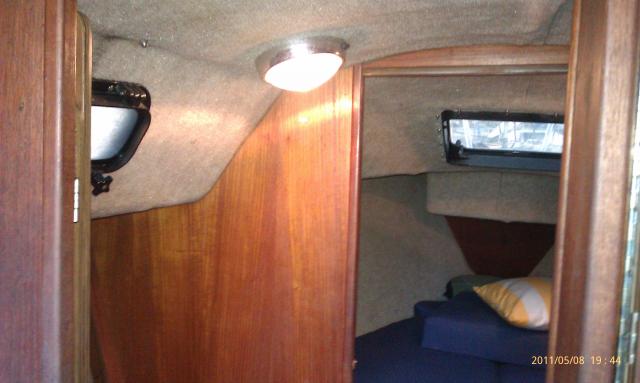

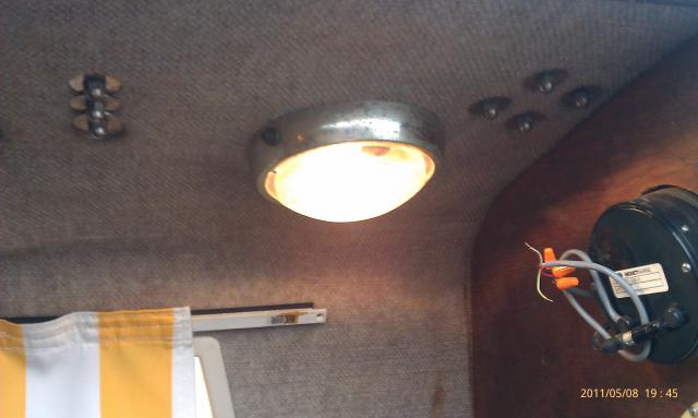

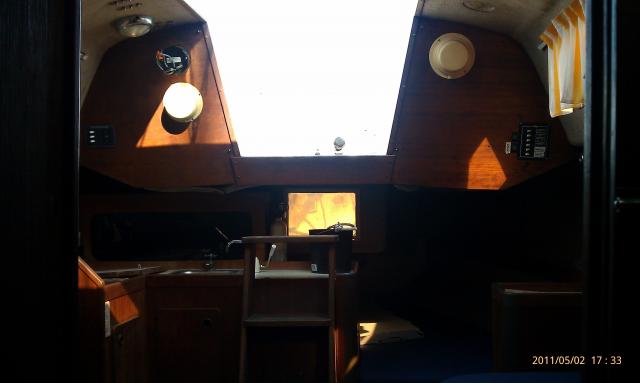

Well, had a good weekend with the boat. Took the mom out on it for mother's day after treating her to lunch; then I made some headway in restoring power to the boat by going out and buying a new battery. I discovered the old one on the boat was completely dead. So, I shopped around for the cheapest marine battery I could find, WallyWorld, for about 60 bucks; Swapped it out with the old battery, connected all the necessary wires and wallah, I have power in boat now. See attached pictures of the dome lights working as a result. All other running lights work now, too, including the deck light, as well as other things like fans and cd player. So now I can take my girlfriend out at night for a romantic time of stargazing without having to worry about getting back to the marina before sunset. It's going to be a great summer.

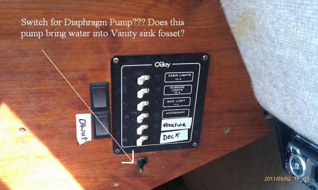

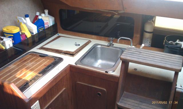

However, despite the good news, I'm quickly learning that as one problem is solved on a boat, a new one is brought to light. So here come some more questions of concern. Once I regained power by hooking up the new battery, I turned on a switch that's located on the bottom of the port aft cabin bulkhead panel (see attached picture), and discovered that it evidently turns on a "Diaphragm Pump" that is located in the starboard settee by the water holding tank. My thinking was that this "Diaphragm Pump" pulls water from the water holding tank and delivers it to the vanity sink fosset. So, I filled the water tank with water and turned on the "Diaphragm Pump" and opened the vanity sink fosset expecting water to flow into the sink. That did not happen. Shortly thereafter, water began to flow into the bilge from somwhere. So, my questions are this: Is my assumption about the "Diaphragm Pump" correct? If not, how do I get the vanity sink fosset working? And where on earth could the water have drained from that ended up flooding my bilge?

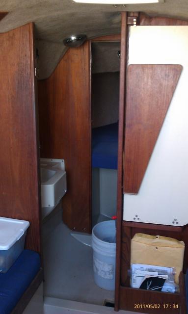

I'm attaching some more pictures of the boat enjoy.

Hey RL. You should do a thorough inspection of every locker and system on your boat to start with. Often to winterize a boat the water is drained from the tanks and the hose to the pump disconnected to prevent residual water from freezing and rupturing the hose. See if the hoses are all attached with clamps where they should be. Of course you could also have a leaky tank but even with a leaky tank you should get water pressure at the sink until the tank drains empty. A pressure water pump should cycle to create pressure then shut off automatically until the pressure is reduced by opening the faucet. Typically a boat will have two pumps on board, one for the fresh water and one to empty the waste holding tank for the toilet. This is called a macerator pump. Only use this three miles outside inlets in open ocean or you will be in violation of the law.
So inspect your systems and try to get a feel for how all this stuff works. Go to the west marine web site, they have all kinds of tutorial information about boat systems.
