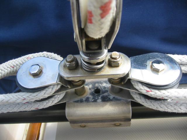

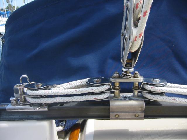

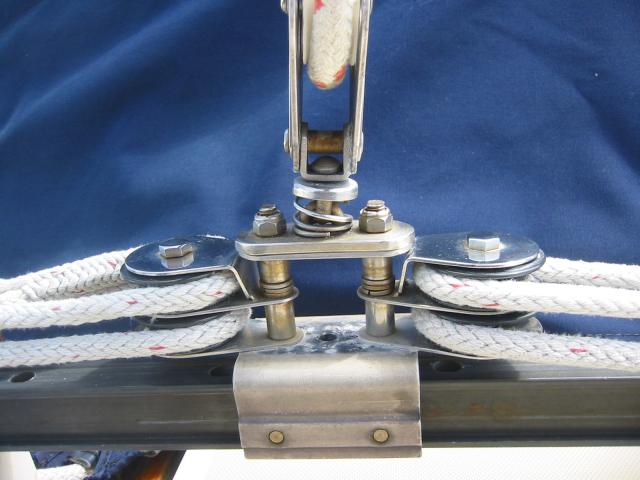

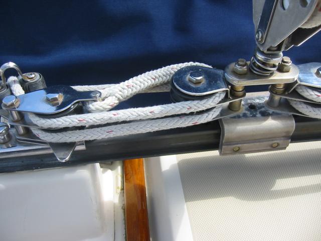

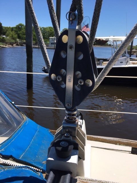

I did use my original track, traveler car and mainsheet block. I purchased the four new blocks I needed from Garhauer (two control end blocks and two cheek blocks for the traveler car).
If it was me I'd go with Garhauer again. I only added that link to the traveler at Defender because it looked like a good deal. If the components fit your track you could just put them on without using the track that comes with the kit (which is probably too short anyway).
If I was you I'd measure the width of your track and call Garhauer and then maybe send them your pictures and see what they can do.

That's ok. Thank you for trying. Going to measure my track width tonight. Looks to be Nicro Fico X track. Sure would be good if I could get away with only buying 4 blocks, no rip out etc.

measure height as well, then take pictures to help described the shape (groove). Good luck!

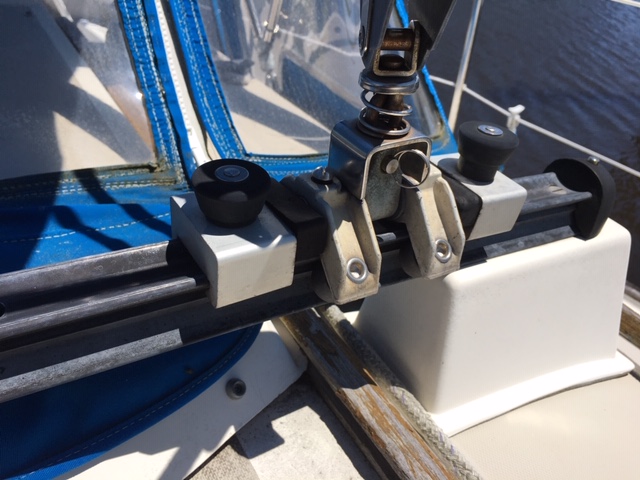

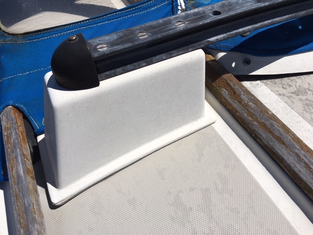

Well I think I have identified what I have and anyone in the trade fo a few years will probably recognize if they also have the photos. This is a Nicro-Fico 610 1-7/16 (37mm) X-track with an NF 587 traveler and 611N Rubber stop with a pin in it (not sure how the pin removes!). There were parts from NF to do what I want, but NF and their parts are long gone apparently. Next stop is Gerhauer I guess. No suggestion resulting from Schaefer's referral of me to Rig-Rite.

Richard: Did you have to remove your track to do the install? It kind of sounded like you did not, but that seems impossible as you had to slide those end blocks on at least, right?

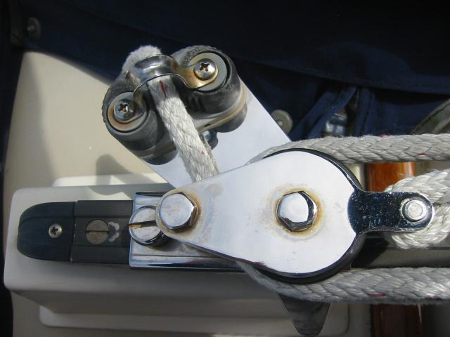

I did not remove my track. Those "permanent" stops at each end of your track should unscrew and come right off allowing you to slide off the old pin stops and slide on the new end control blocks. The traveler car should also slide right off. At least mine did.
In one of my pictures you can see the small phillips screw holding on the end piece. Your's looks a bit different but I think if you take out the one screw on your end piece it will come off and allow you to slide off the stops and car. That should be an easy thing for you to check out.

Thanks again, Richard. I wrote Gerhauer last week enclosing my pictures and stating my needs. No answer back yet. I see your end stops have screws, mine have pins apparently, but one way or another I am sure I can get them off when the time comes. Much obliged, sir!
