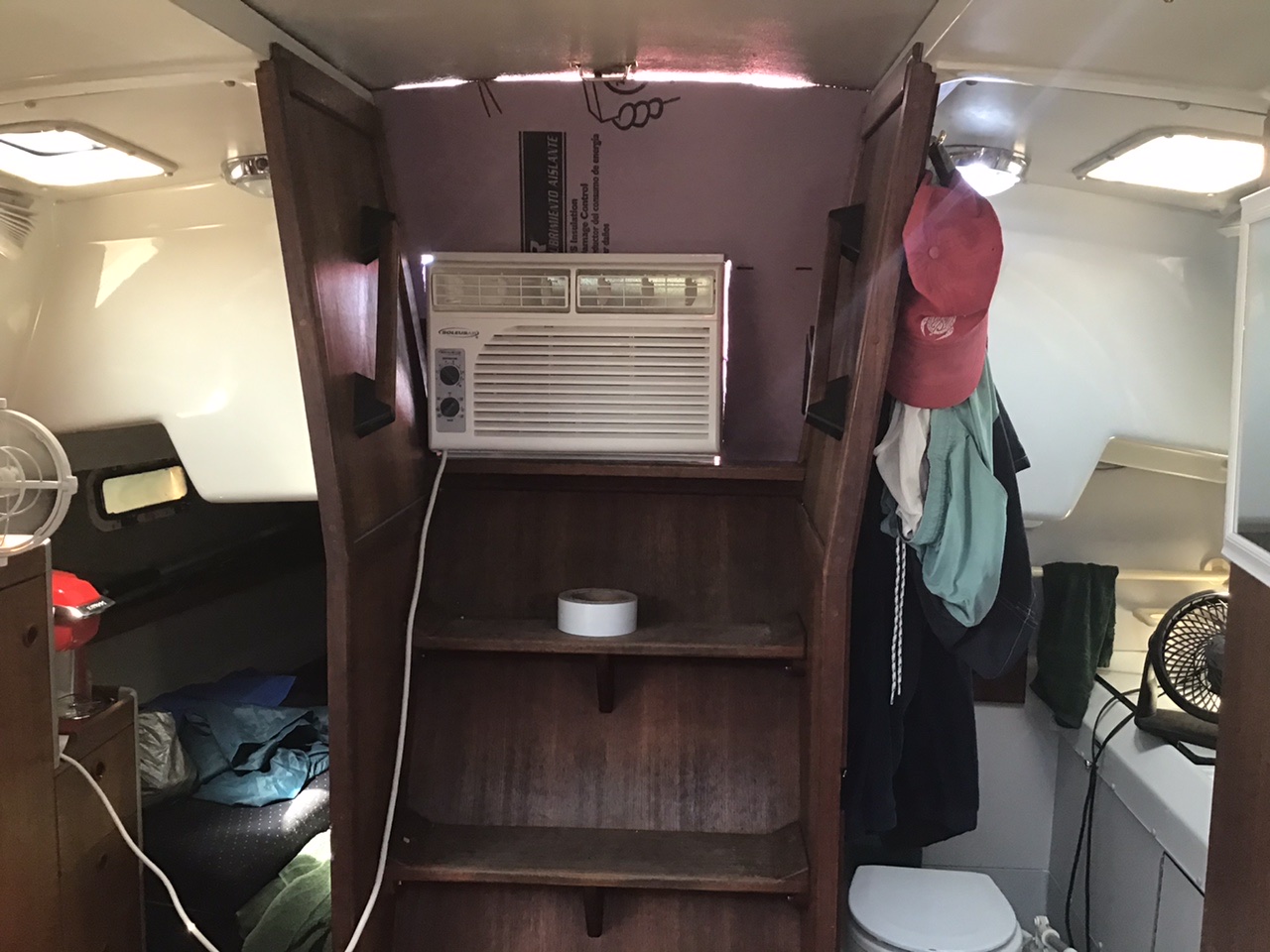

I installed a used 5,000 BTU window air conditioner in my companionway today...
not the best, but a cheap way to cool off the cabin and drop the humidity level some while at the dock.
going to be 93F on Monday, so will see how it works.
