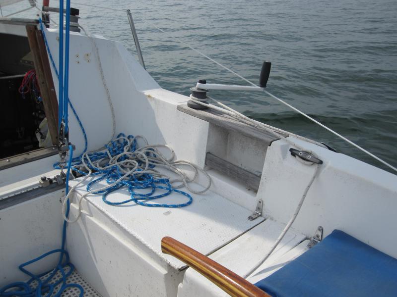

SeaTR - rule number 1 with foresails is NEVER cleat your jib/genoa lines. in an emergency you won't get them undone quick enough. I was surprised that Hunter put a cleat there for that. Add or replace the cleat with a cam cleat for your jib sheets.

Inarathree,
I agree with your #1 rule ... don't cleat the jib sheets. A while back I installed cam cleats on the teak just aft of my jib sheet winches. I usually lead the jib sheet to the windward side cam cleat, even though it creates extra obstacles in the cockpit, thus making it more convenient to access / adjust. (see the attached pix)
The original Hunter jam cleats are soley used for my poor man's "otto helm" (3/8" line looped on one cleat, 3-4 wraps around the tiller, jammed on the other side's jam cleat). thus, if I don't want to heave-to to get something done while single-handing (which is most of the time), I'll lock in the tiller with the 3/8" line...
I was just noting the original configuration that Chasemixon probably had (has). The pix that I posted earlier in this discussion was an old pix, but I posted it as it was the only one I could get a hold of in the short term for him.

For my Otto pilot, I attached a couple mini cam cleats about a foot back on the tiller. I then run 1/4" line to the toe rail. They can be cleated and released quickly.
Another trick is i bring the jib sheets back to the cheek block then run the sheets run to the opposite side of the cockpit for when i am single handed sailing. That way I don't have to reach to the low side to adjust the jib sheets, the working sheet is right next to me.

I for sure need to pick up a few of those cam cleats. Thanks, and yes I have the factory hardware, but I am ready to start modifying!
