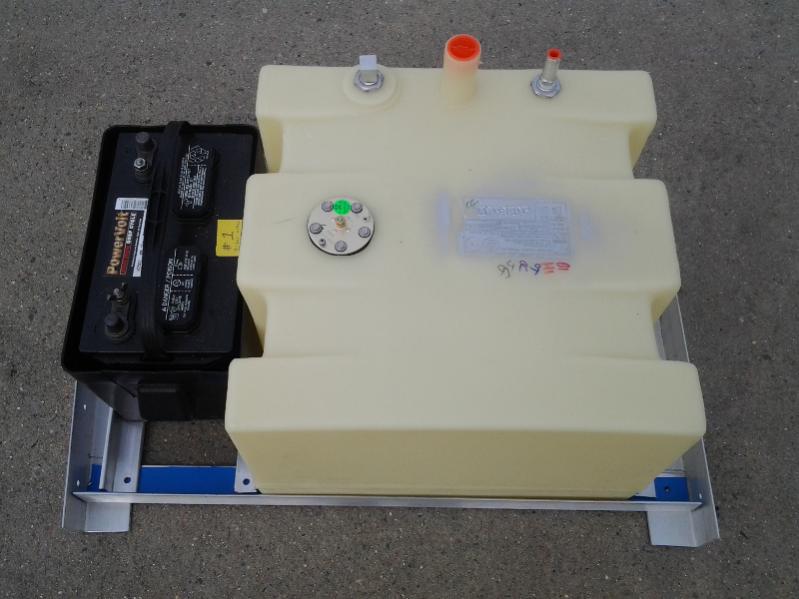

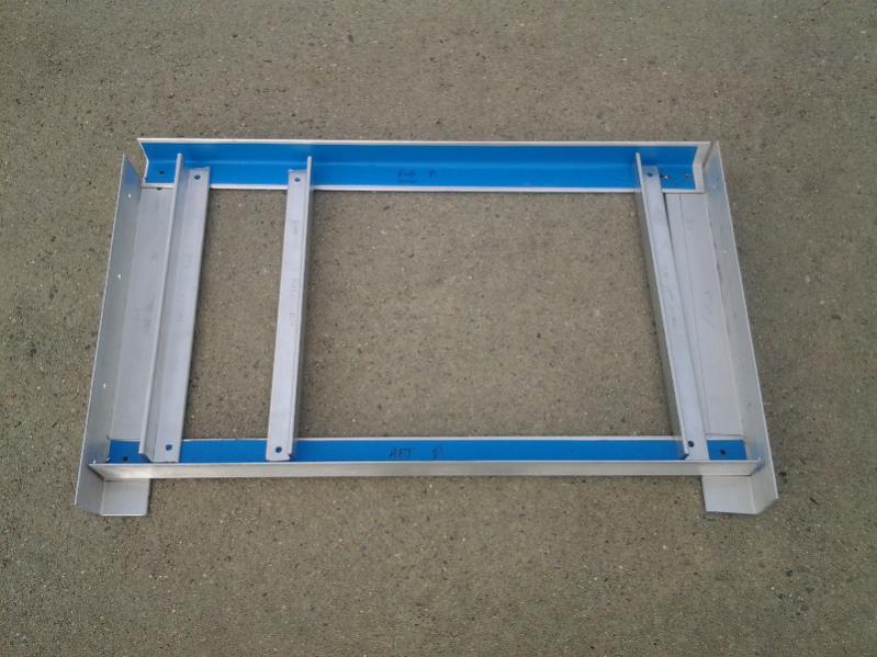

WHAT A MAJOR PAIN THIS WAS! I removed the old 18 gallon tank last weekend and installed a slightly smaller 15 gallon poly tank this weekend. I also removed all the older wooden structure and used all new aluminum angle for new mounting support. Next weekend i will put some fuel in and se how it goes.

I share your pain. Replaced my tank last year. Interesting approach to use the aluminum. I made a wood frame and used a fein style tool to sculpt the bottom to fit the hull then epoxied it in place. So far it works well and the poly tank has nice clean out openings in the top to pump it dry and polish the fuel. These tanks are pretty cheap and can be easily replaced though you'll probably never need to.

Didnt get an email, but i bought the moeller 15 gallon model number 032515.
It was 3 gallons less than the original tank but not to bad to maneuver into place.
The diesel smell was bad at first but i cleaned the bilge 3 or 4 times, wiped all the surfaces that were coated with fuel and removed all the cushions for a air out,
No issues so far other that the tank sending unit that came on the tank is not what i would have installed but fuel level is visible now from just looking at the tank rather that the aluminum tank as before
Bought from amazon
