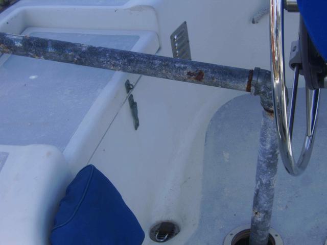

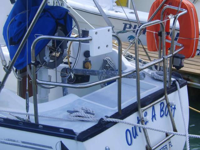

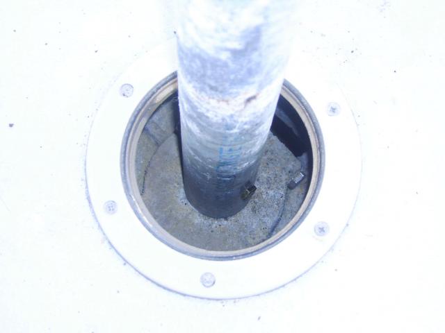

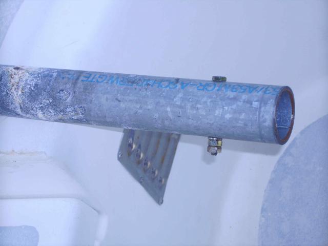

My fast, easy, cheep emergency tiller. Four or five years ago the cable slipped off the quadrant and stranded me out in the Gulf. After getting back, having an emergency tiller was at the top of the list. It was easy to make one out of 2" pipe. Cut a length 2' for the vertical and 32" for the horizontal legs. Put a cap on the end of the horizontal leg and a 90 degree elbow attaching the vertical leg on the other end. On the down end of the vertical leg about 2 and 1/4 inches in drill a hole for a stainless steel bolt 1/4" I think but measure the slot on the rudder post. That's all there is to it. Pictures below. Also without saying, put the steering system on the annual check sheet.
