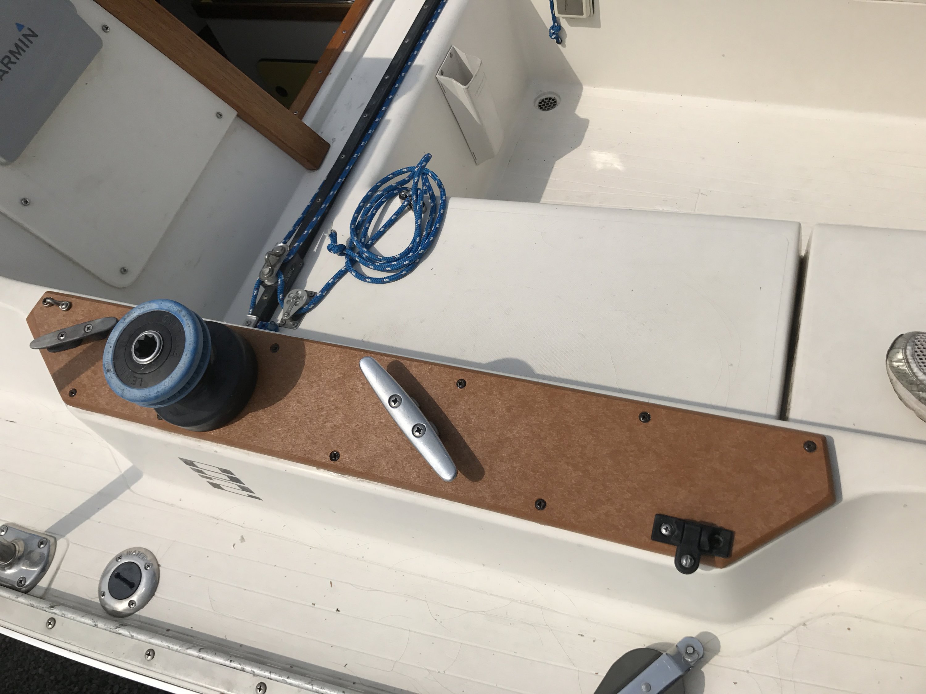

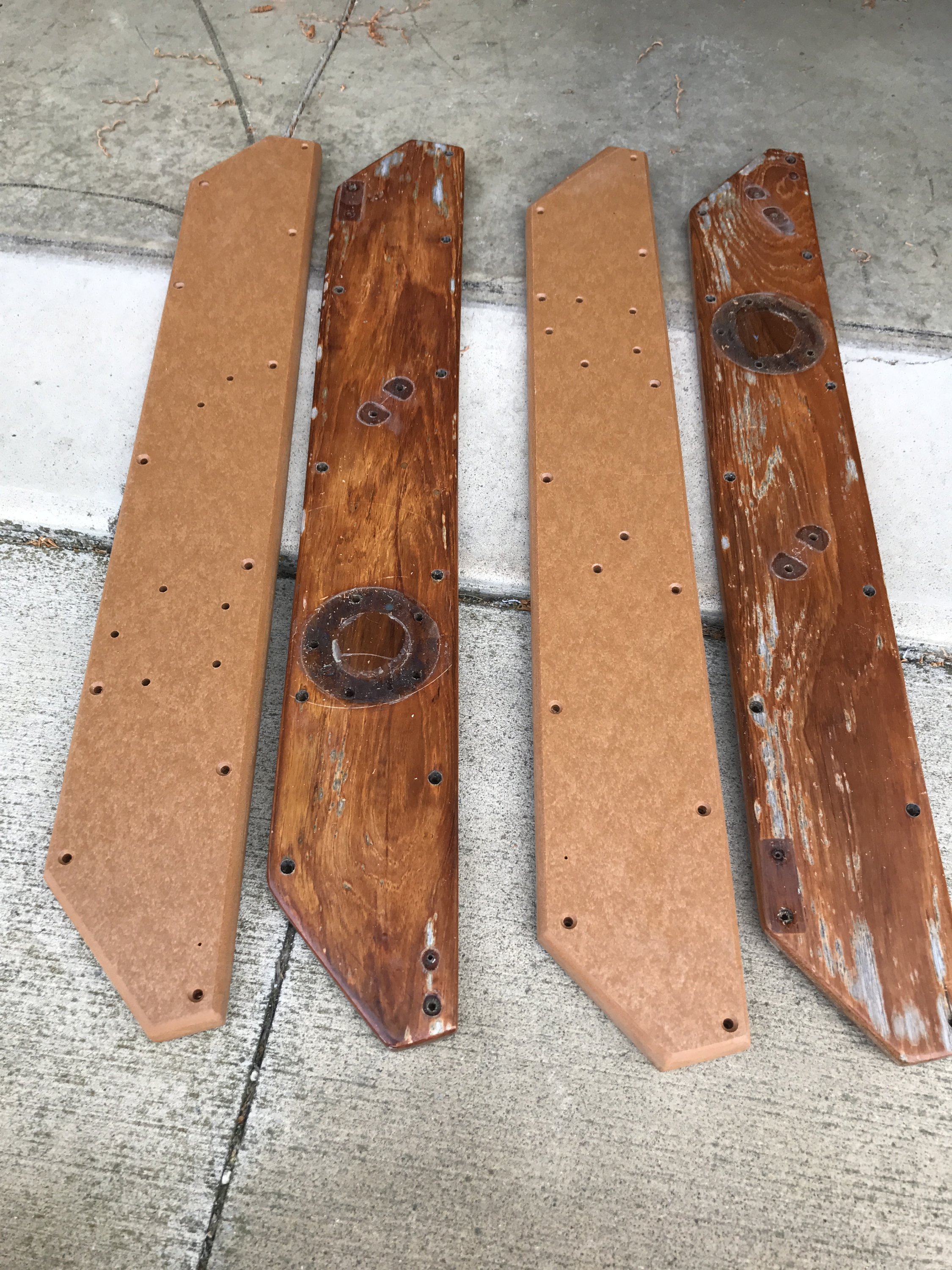

I replaced the Teak boards under my winches, port & starboard.
Anybody want the old ones? They need sanding & re-varnished.

What material did you use, I like the way the color goes all the way thru.
Jul 8, 2013
9
S2 8.0A Port Clinton

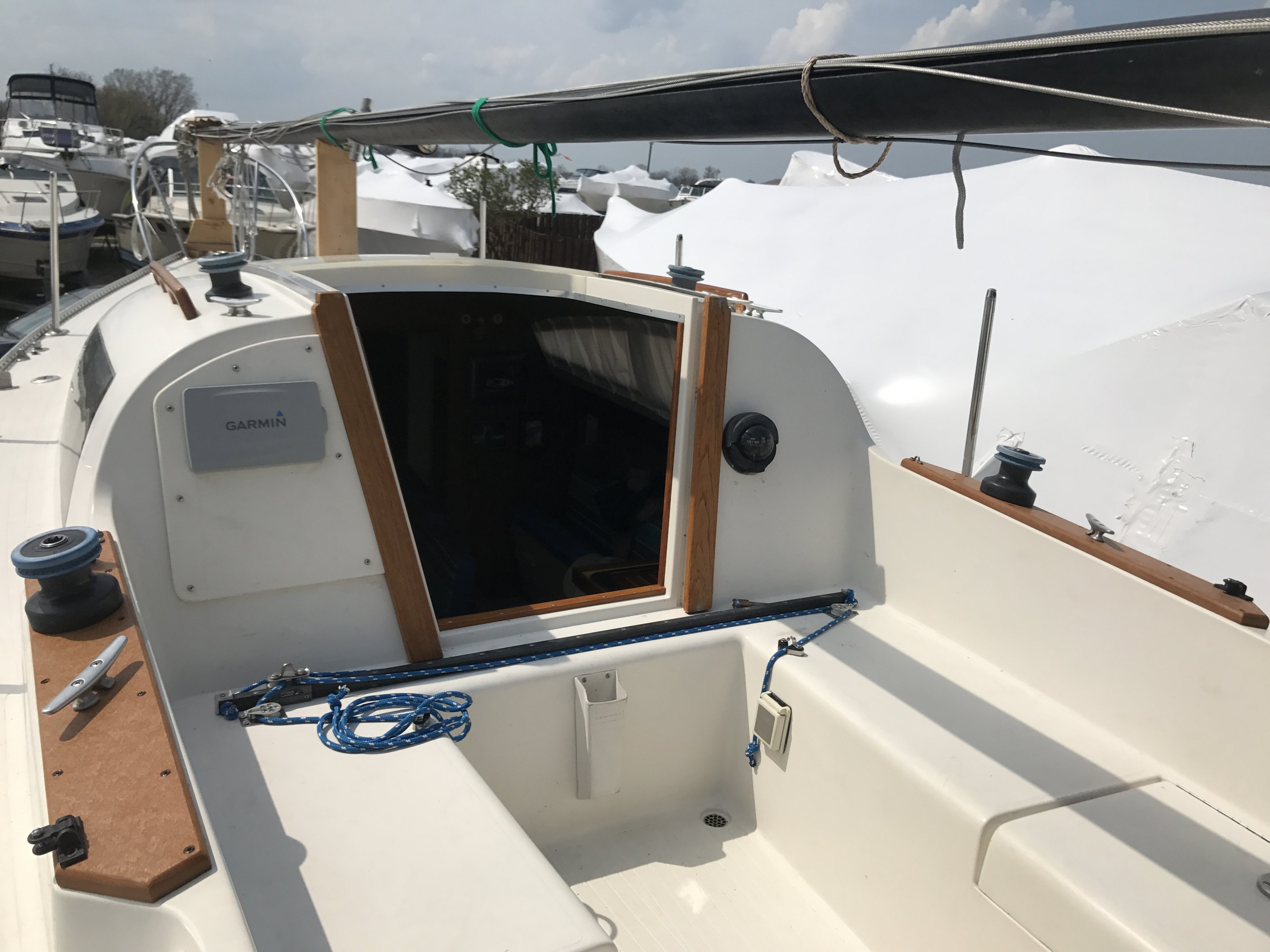

I used a product called Plasteak, and it's nicer than wood to work with. They make a lot of different shapes & sizes. I also replaced the slats in my companionway opening with some 1/2" product. For the sawed and routered edges, you just hit it with a small torch, and the color darkens right back to the "natural" surface color. Go to plasteak.com
