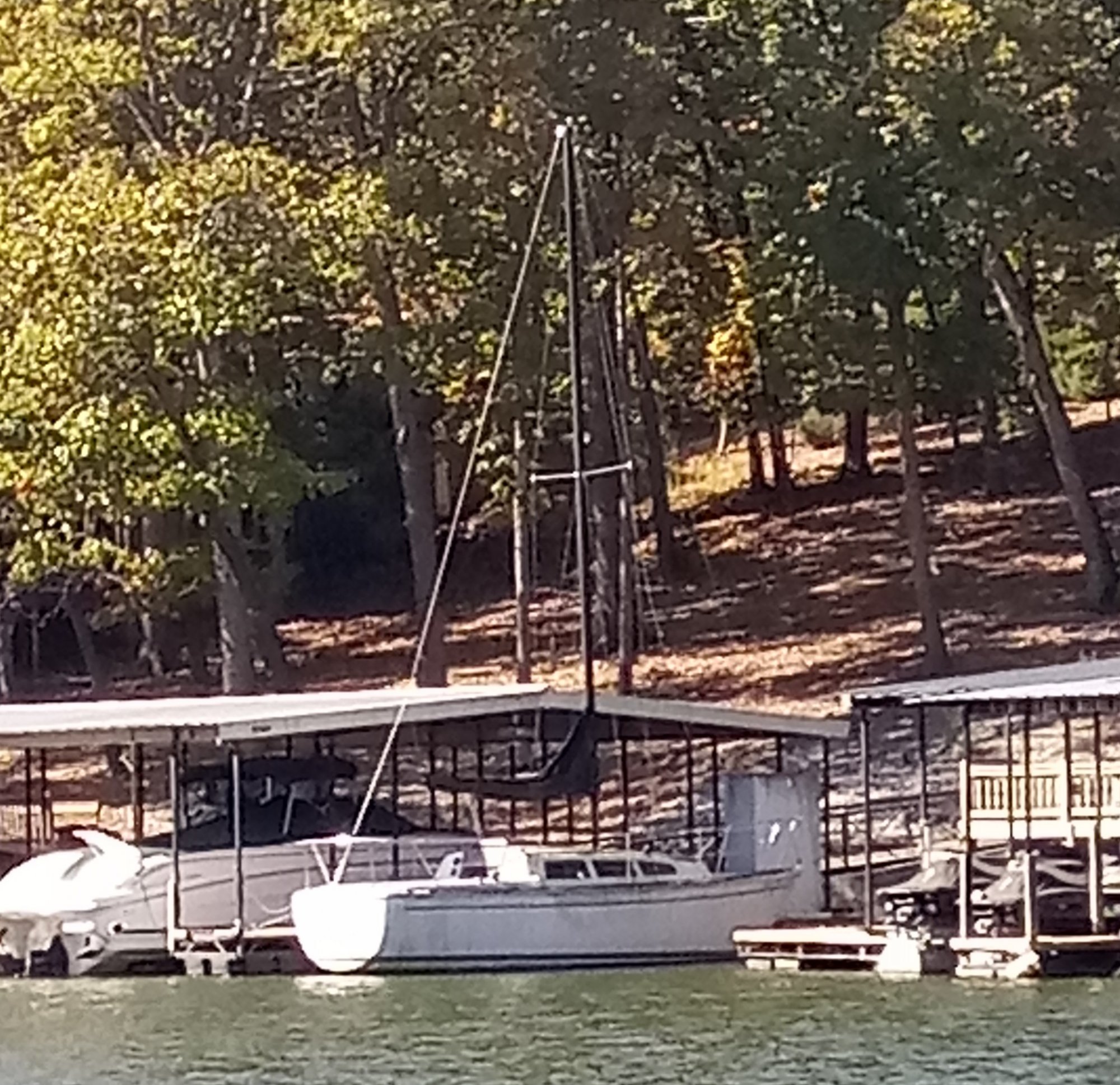

I have done stringers, transoms and floors in powerboats before. This will be my first bulkhead replacement. It seems pretty straight forward, just a lot of interior to remove first. I drooled over this old boat for years and the owner was gracious enough to give it to me. I'm towing it to my dock over the holidays to assess to old omc saildrive. If it's not viable I have a 9.9 yamaha and drop bracket sitting in my garage for it.
