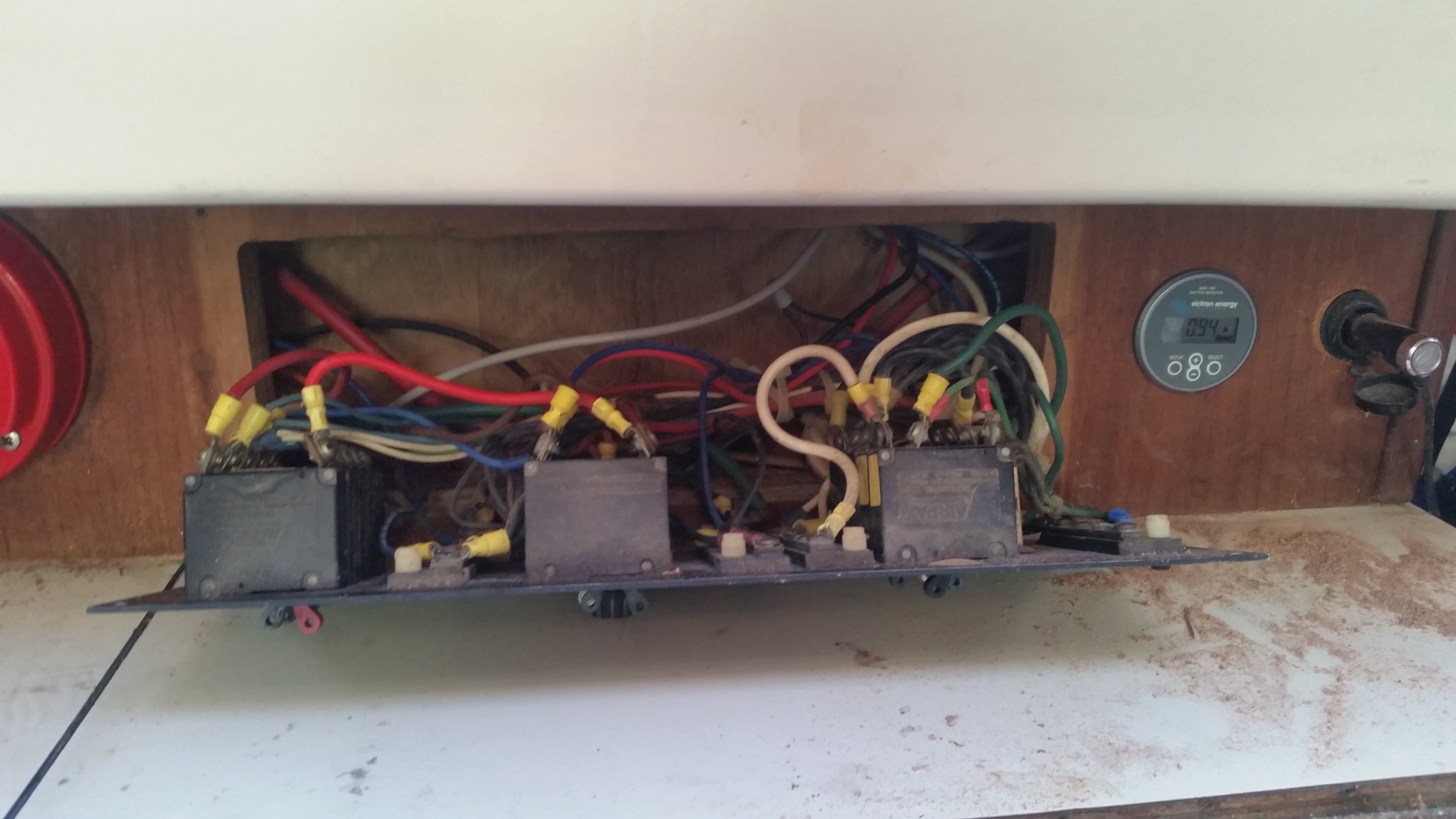

Roland, that would be great! Next on my list after I can run the engine and steer the boat at the same time, is to replace much of the electrical. I hate the location of the panel near the sole, so I was planning on relocating it. I saw an ad for an H30, I think in Oregon, that had the panel on top of the nav panel, so I was going to try to replicate that.
That would be a great item for the owner upgrades section, as I imagine many owners would want to do it also.

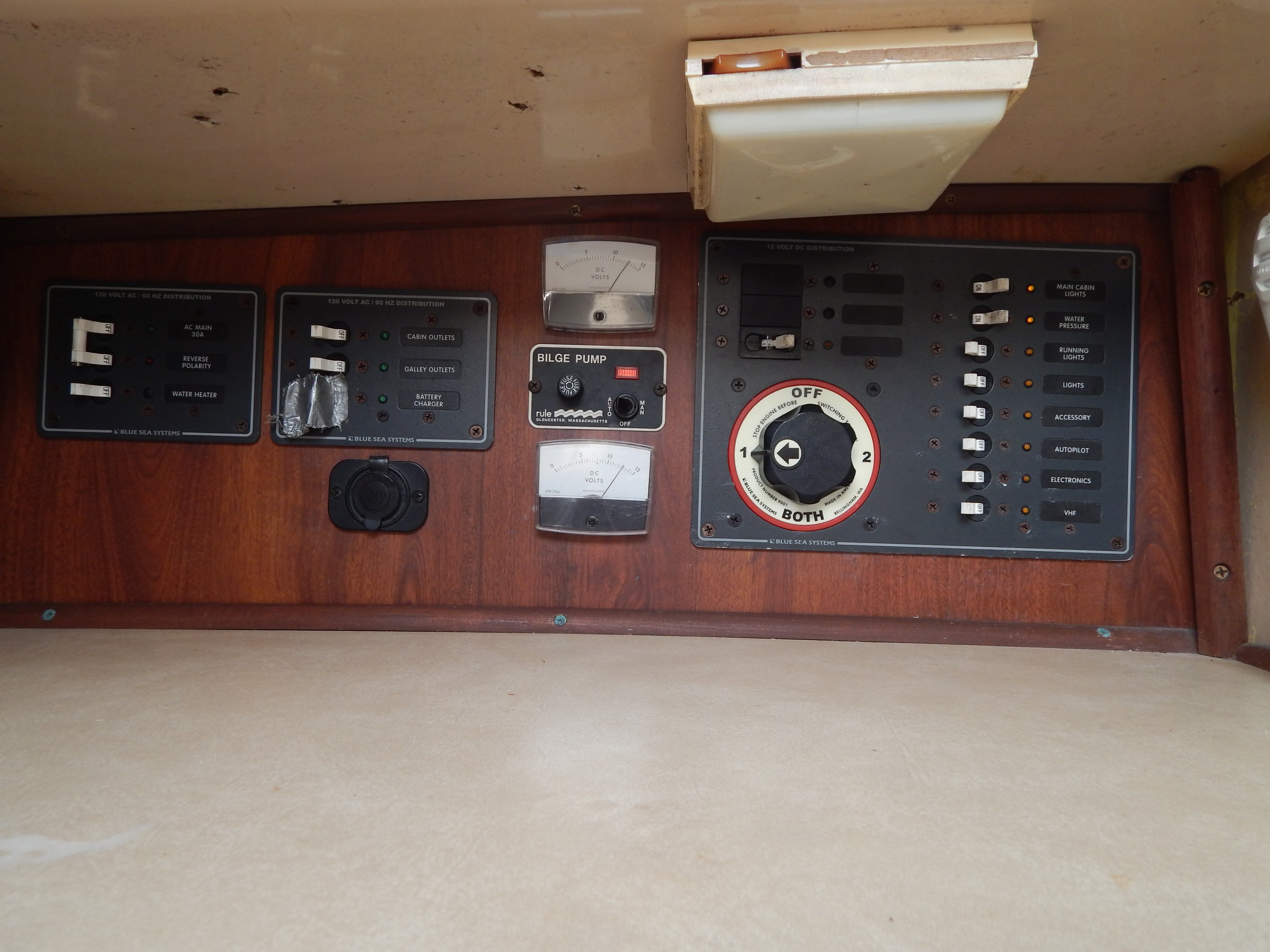

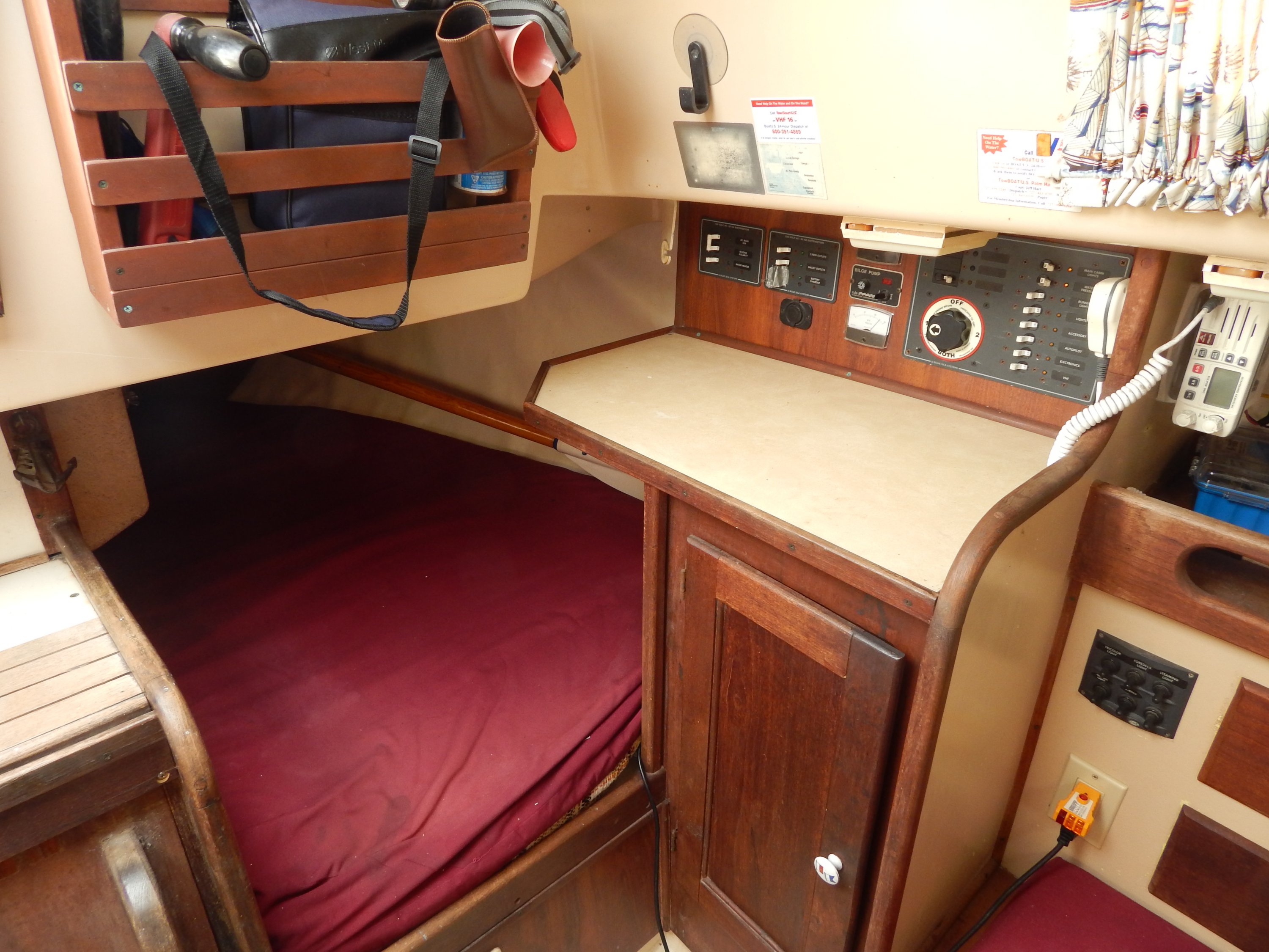

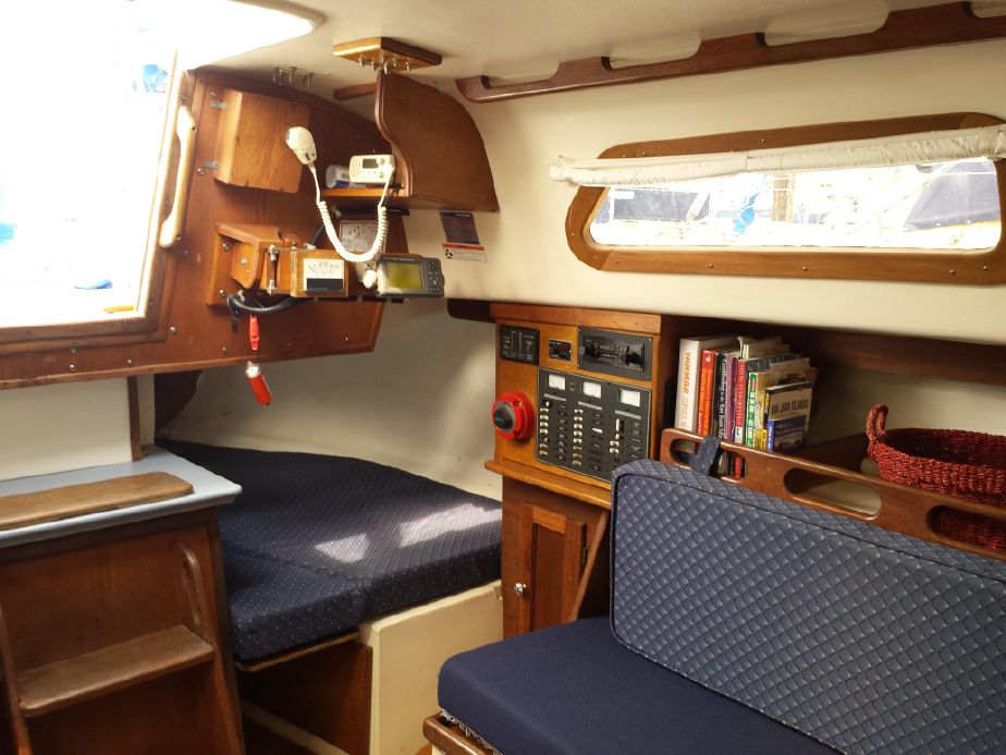

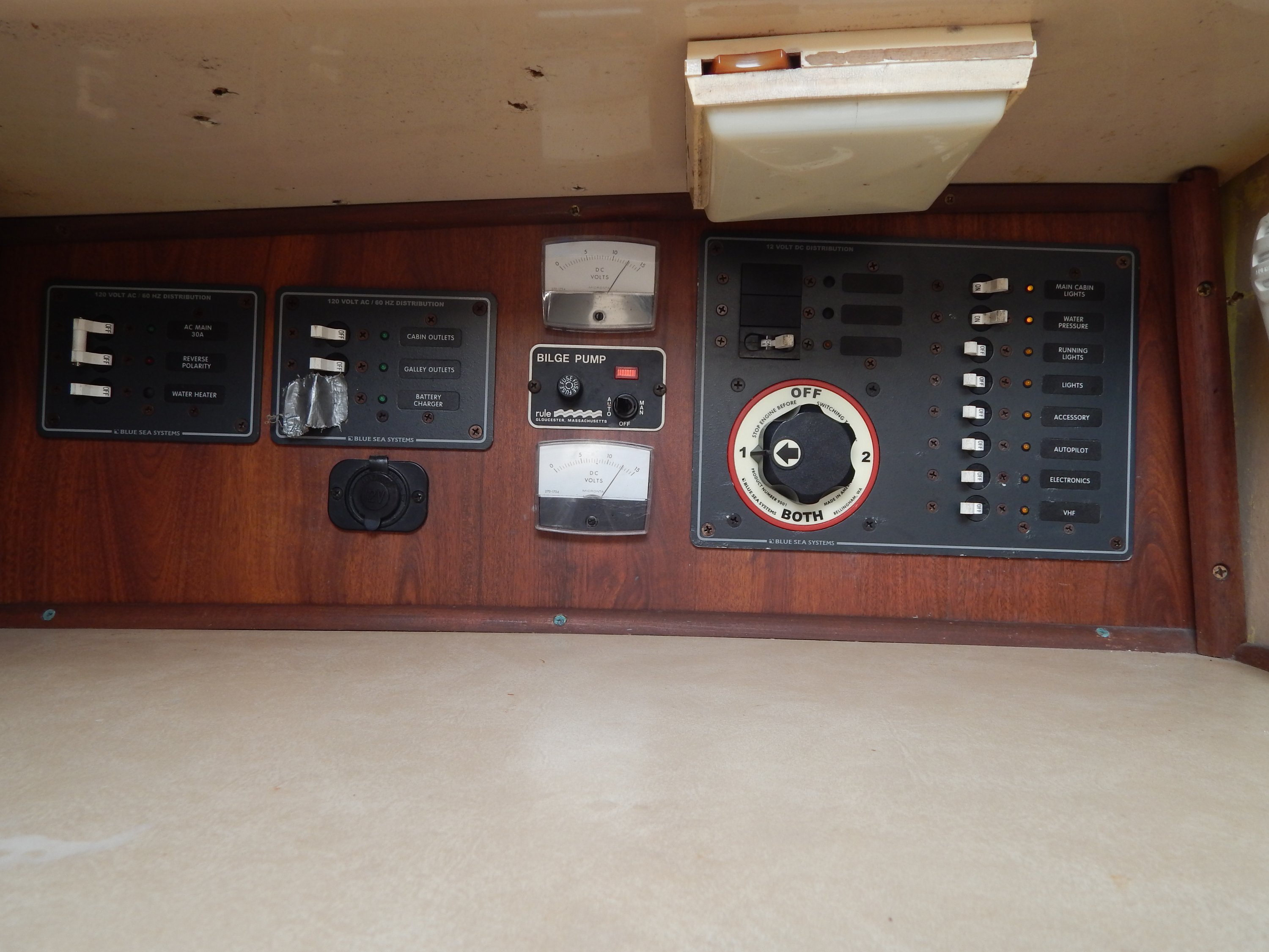

Here are some pics from the ad for someone else's '79 Hunter 30. Overall the boat looks exceptionally well set up, but I really like the slide out nav table, and of course the relocated and expanded electrical panel.

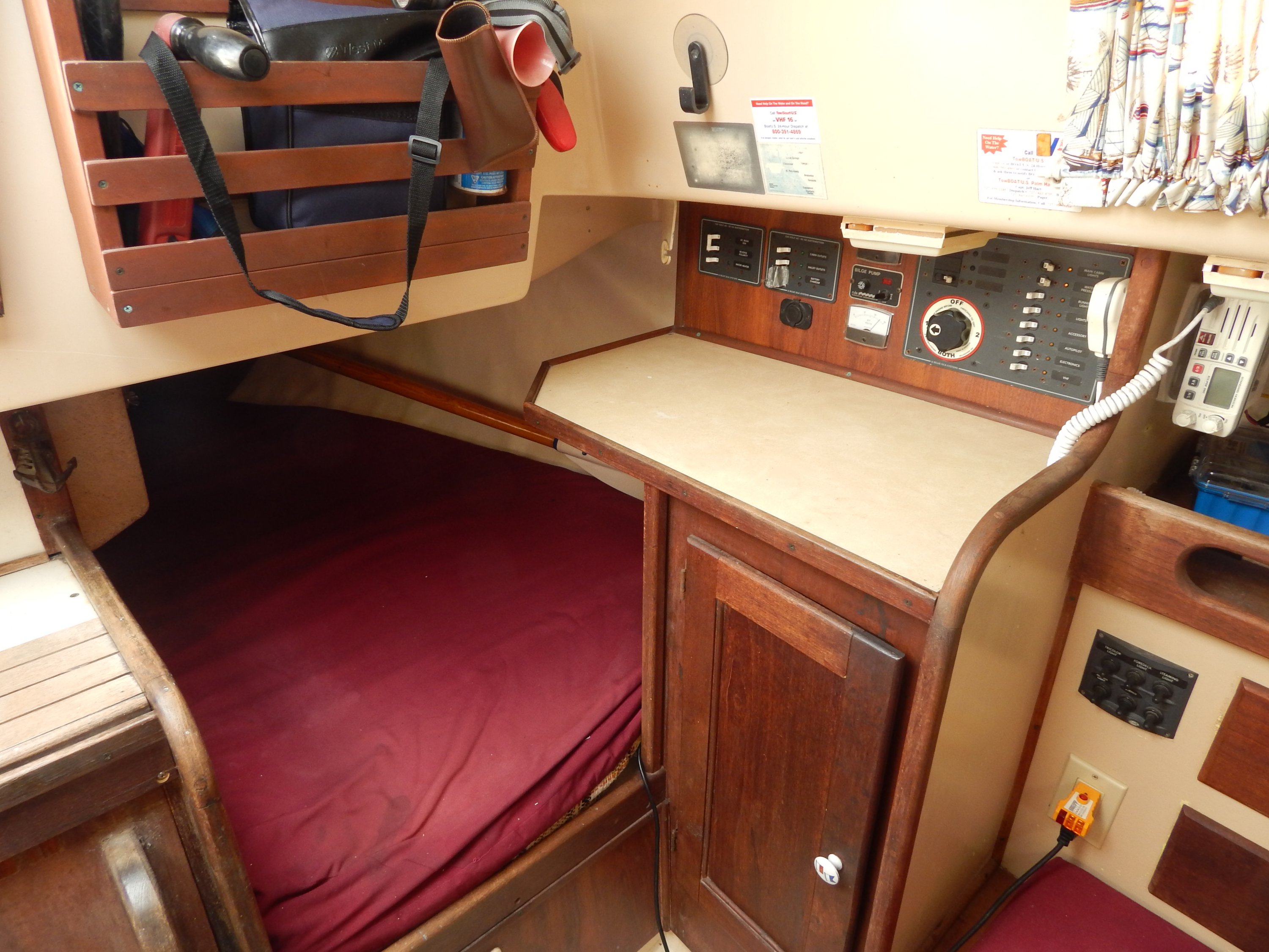

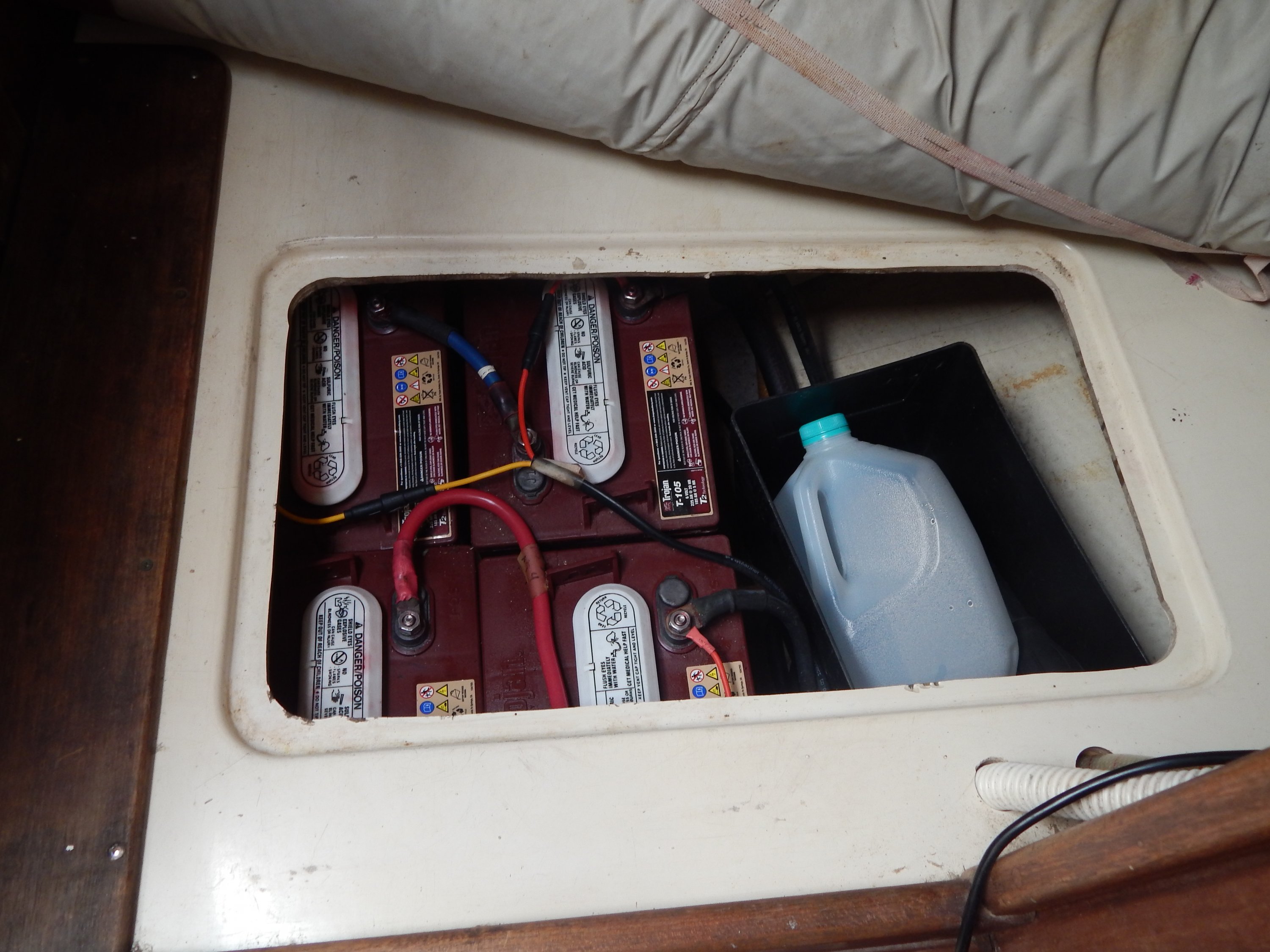

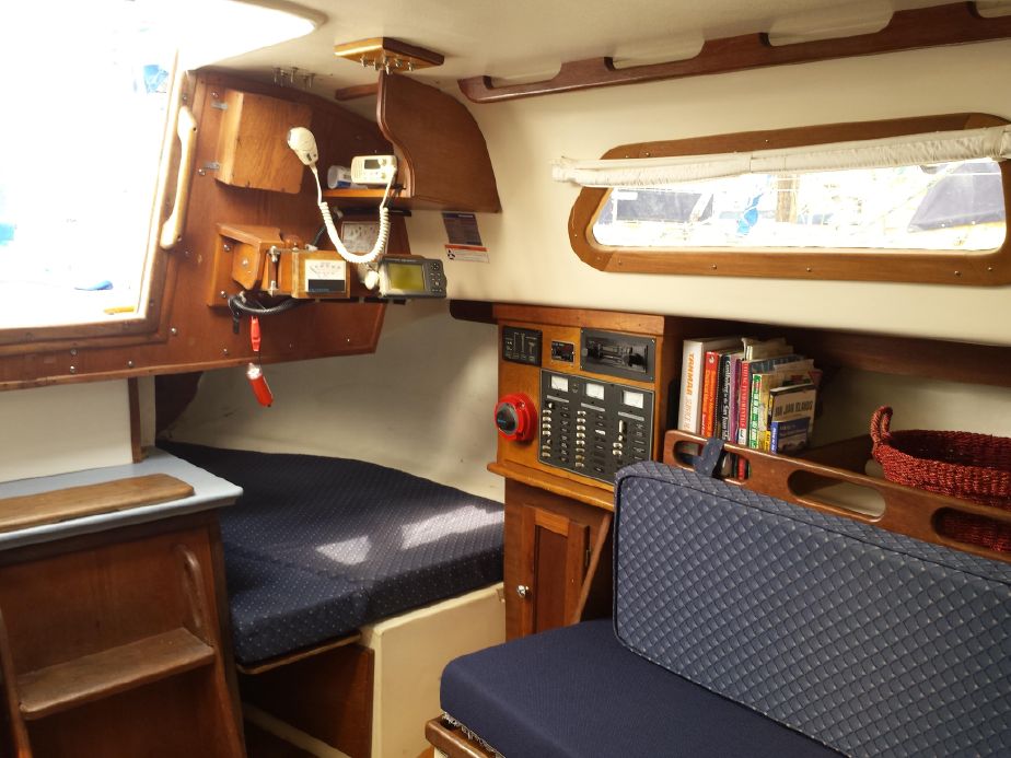

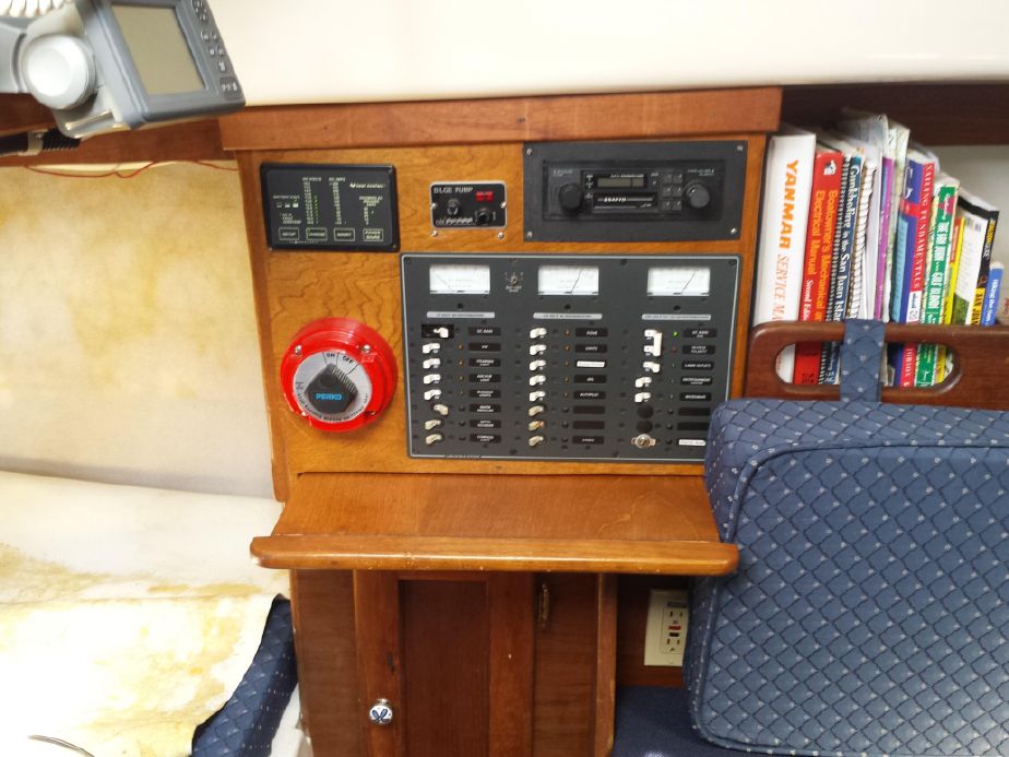

Ben, here are the pics from my panel mod.

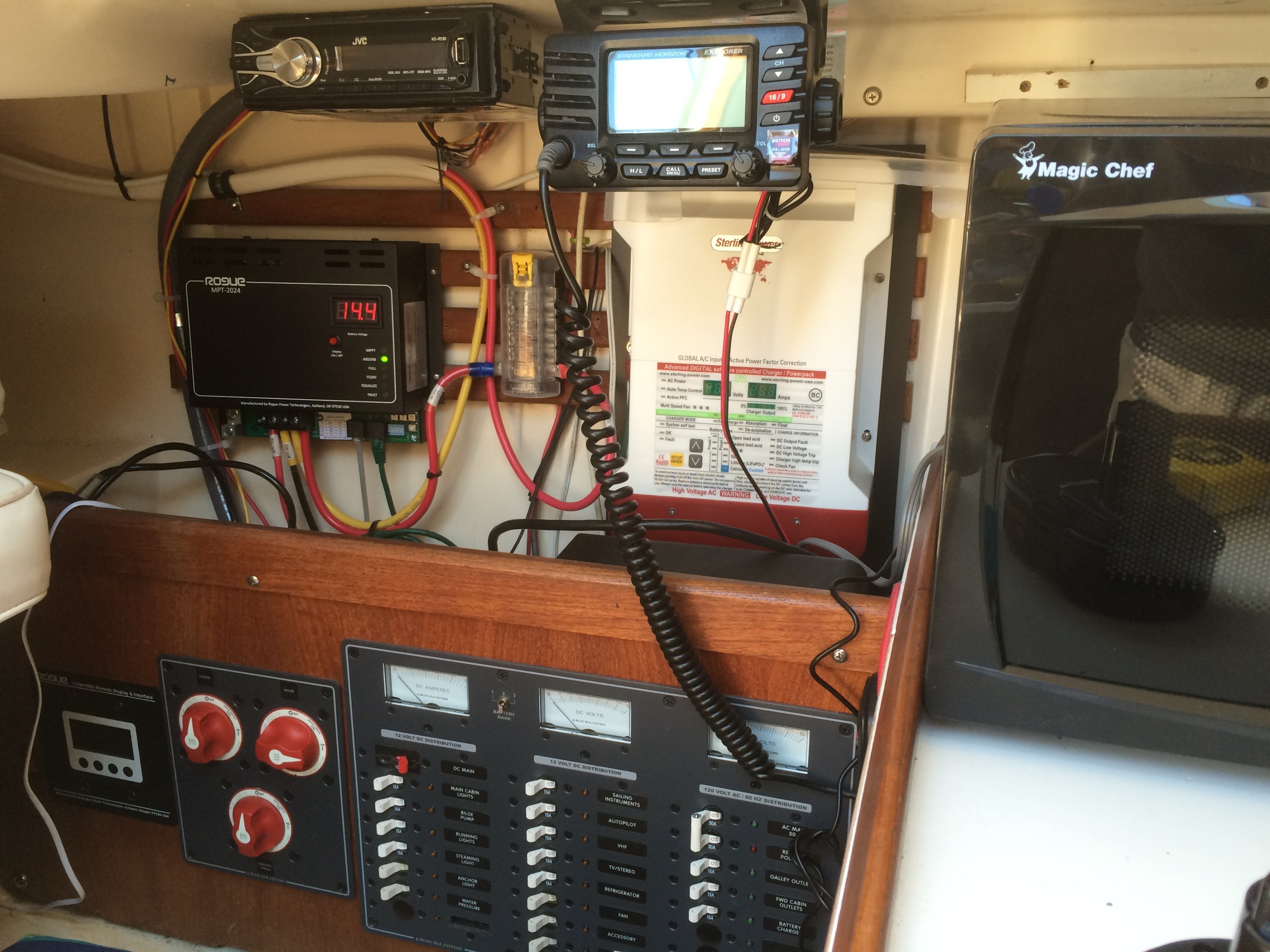

Pic #1 Overview
Pic #2 New Panel

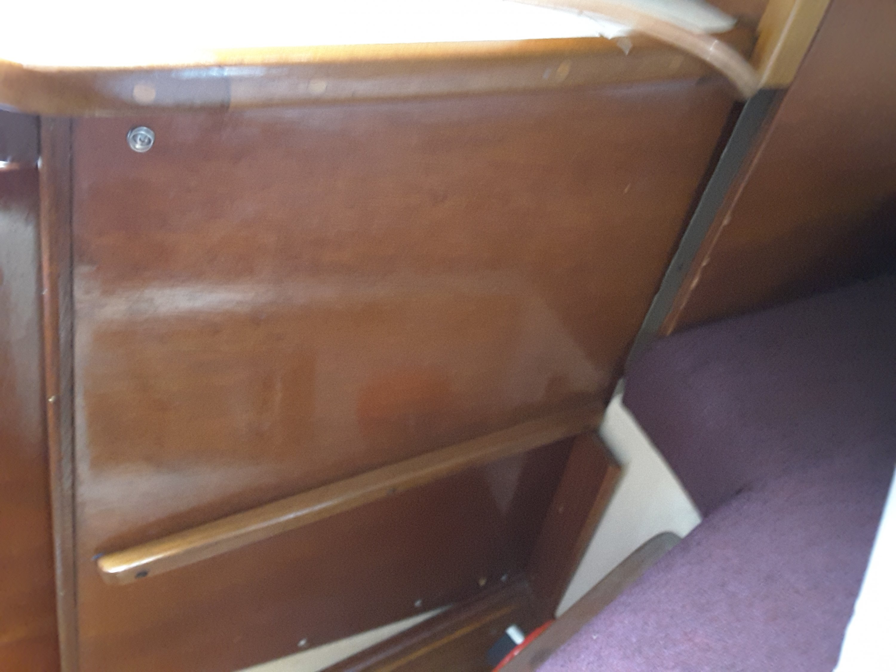

Pic #3 Under the Q - Berth

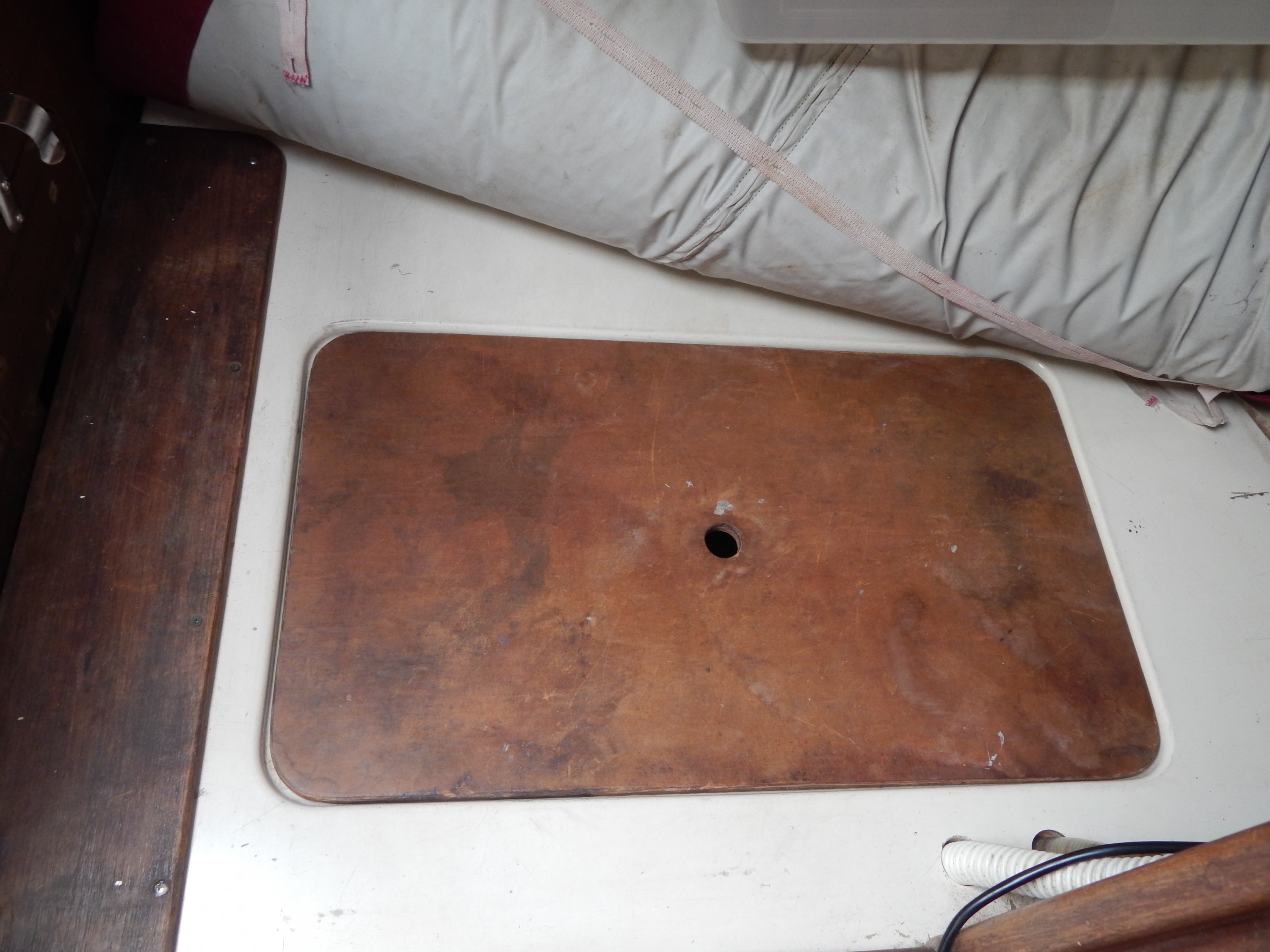

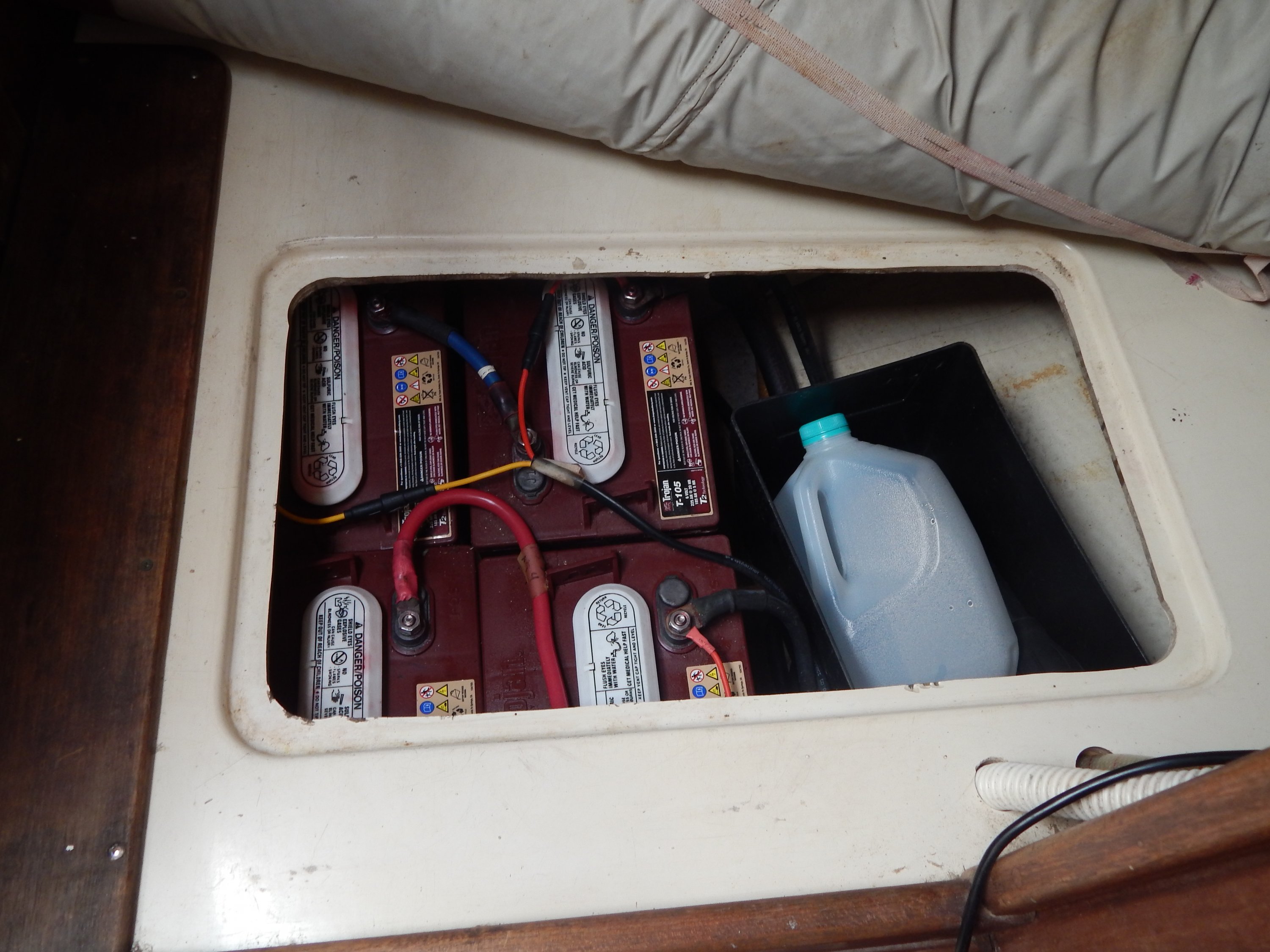

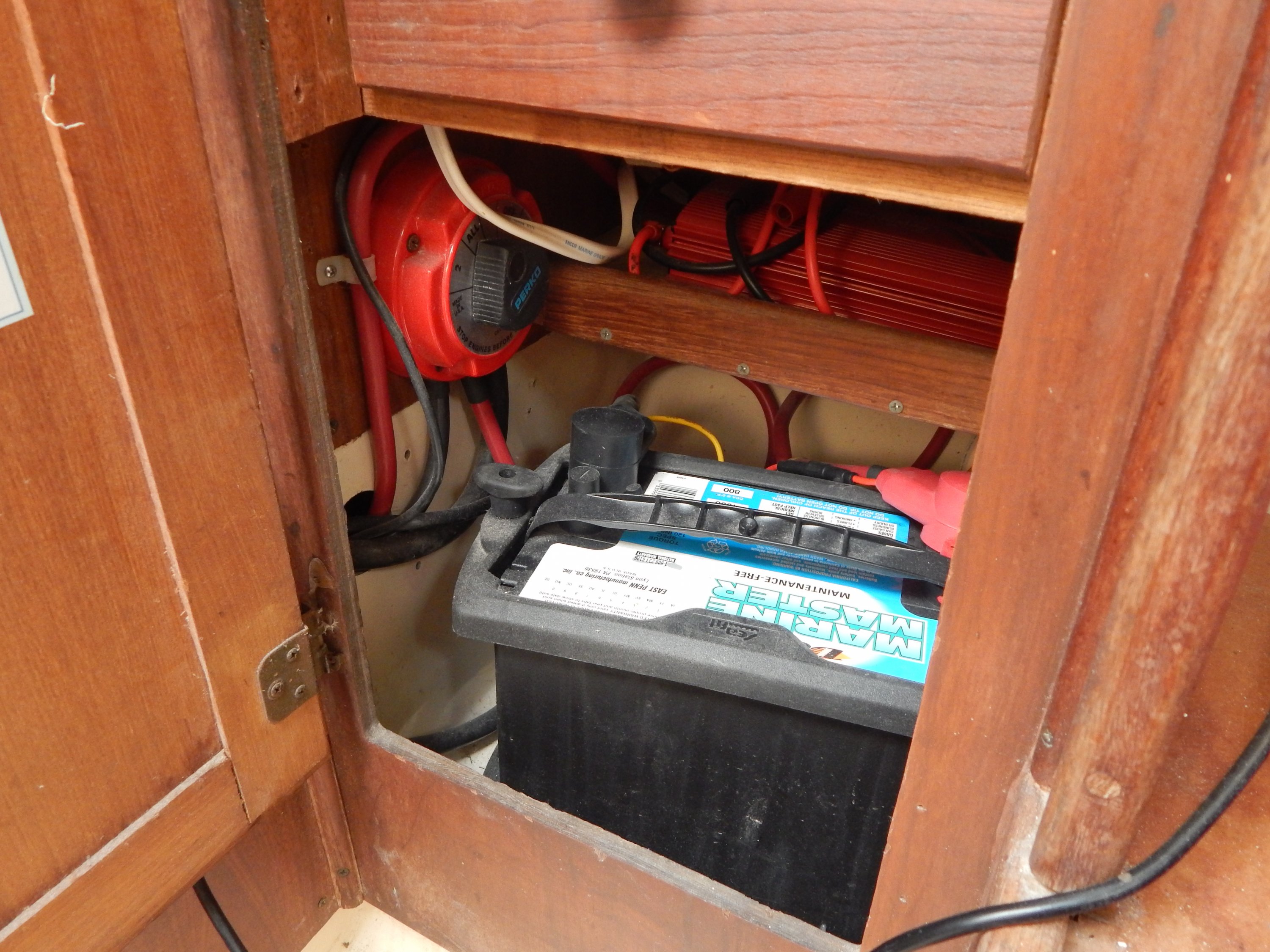

Pic #4 Four 6v. GC batts wired in series to form house banks 1 and 2. These are wired to the selector switch shown in pic #5.

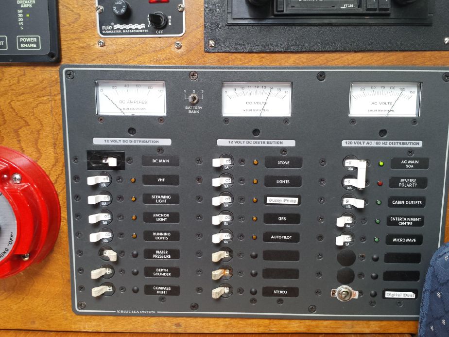

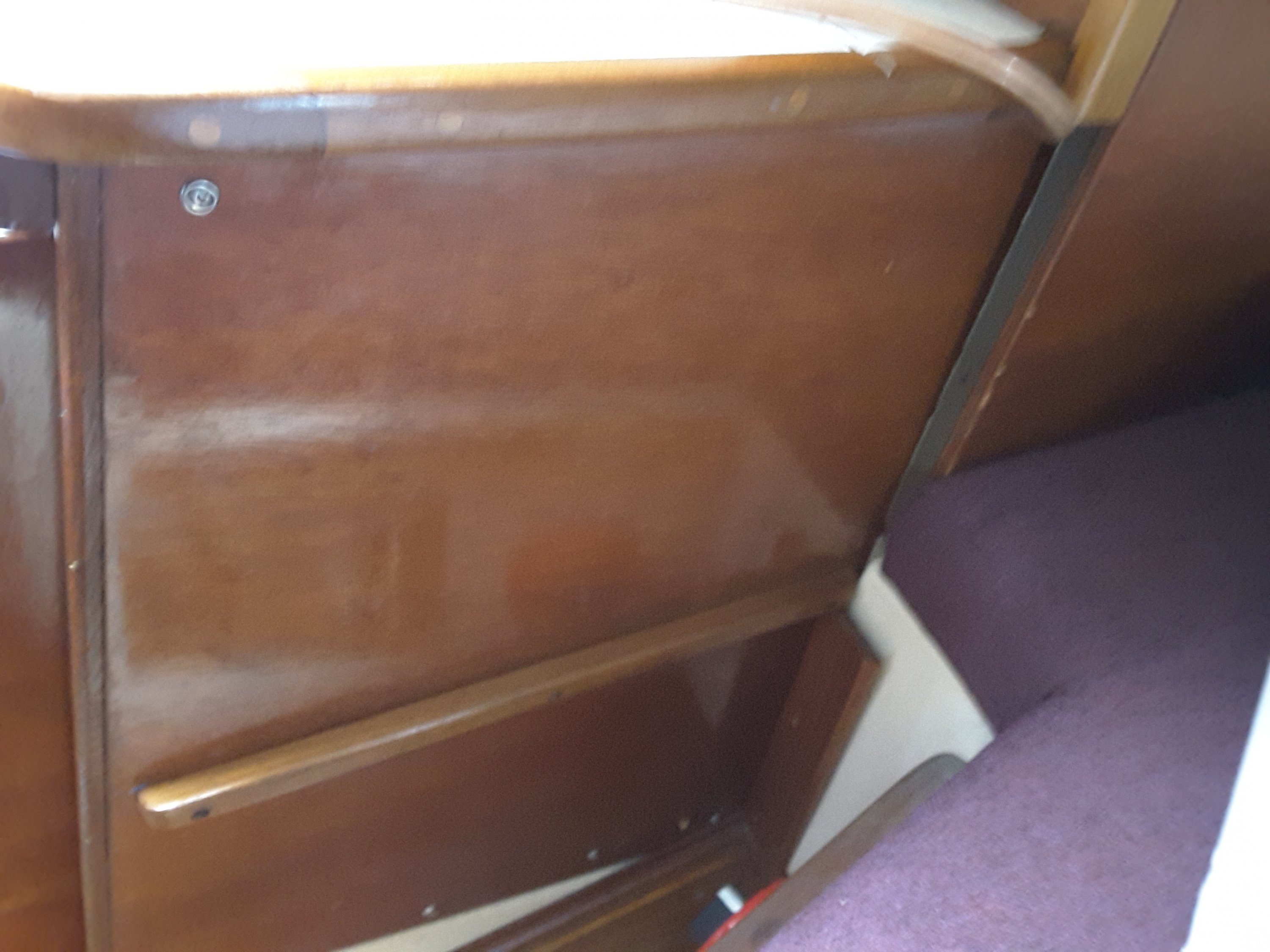

Pic #5 Selector switch wired to #1 on sel switch at the nav station. Group 24 starting batt wired to #2 on sel switch at nav station. This gives me six different configurations for batt. use.
Overkill for this boat? Probably, but I haven't ever run out of juice.
Hope this helps.

Roland, thanks for the pics! I don't think that's overkill, seems like a solid cruising setup to me. For overkill see the post by Gorilla Toast, he's got twice the battery and less boat! Is there something else between the fuel tank and tranny (where many of the other '70s H30's have their batteries)? The batteries should stay cooler where you have them and they are lower and easily accessible for maintenance, but off to the side of centerline and taking up locker space. Everything is a tradeoff, right?
The panel looks great! I figured on having mine a little farther from the hull to give space for wiring behind it. Did you have any issues packing all the wiring in there?
May 12, 2004
1,505
Nothing between the tank and tranny. That leaves good (?) access to the shaft. Off center with the water tank on the same side does put more weight to port but has not been an issue since they're pretty low in the hull. Could have put more space behind the panel but that is where the lip on the headliner is so I just attached to that. It's cramped but doable. That's a good observation, however. Might have to mull that over for a while.

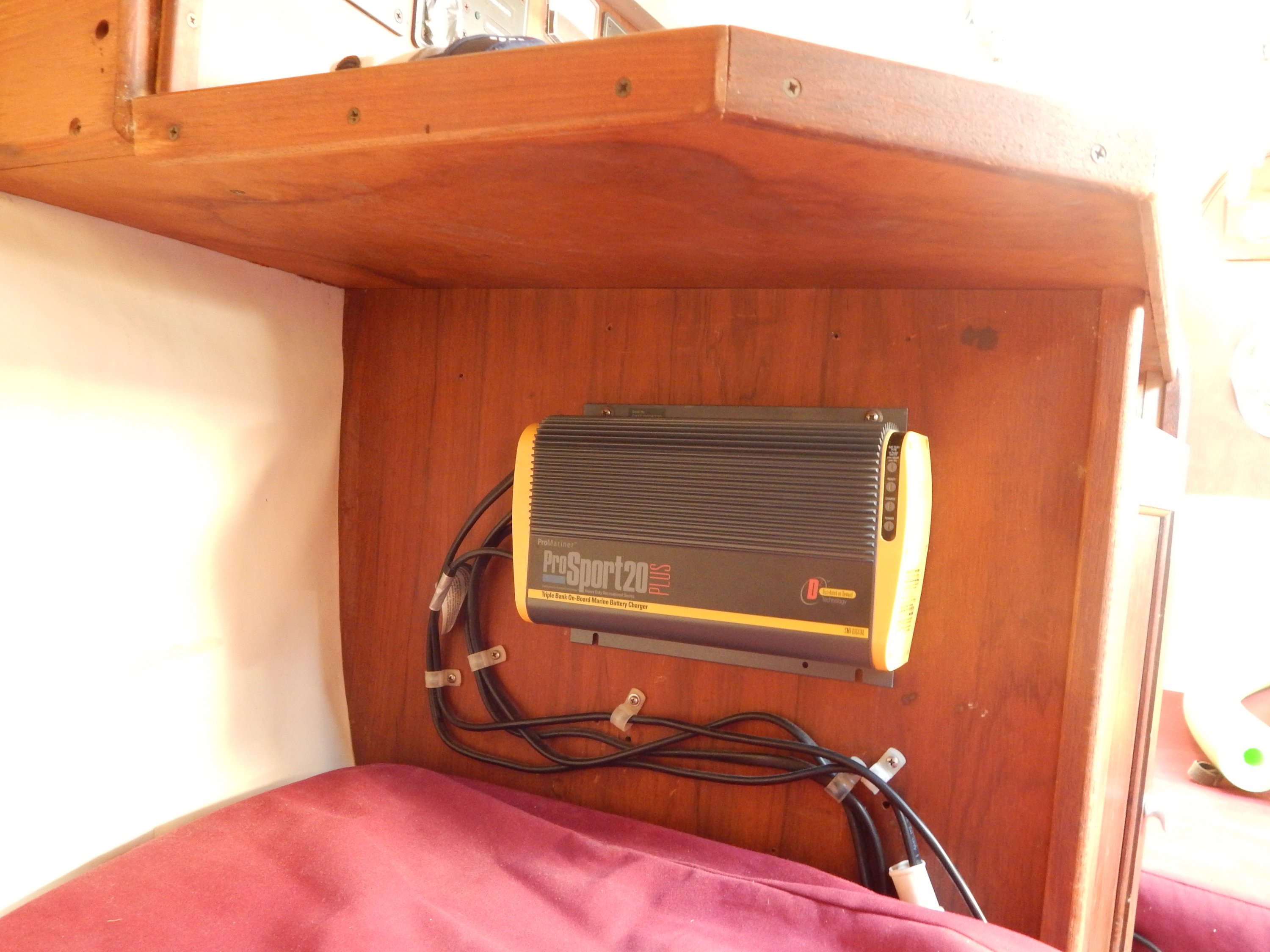

Ben, my charger is mounted on the outside aft of the nav table above the cushion on the q-berth. Short run to the batts and short run to panel. Make sure to leave enough room for air circulation. Different year models had different nav table setups. Don't know what yours is. I'll try to post a pic of the set-up.
Likes: Ben Jammin
May 12, 2004
1,505

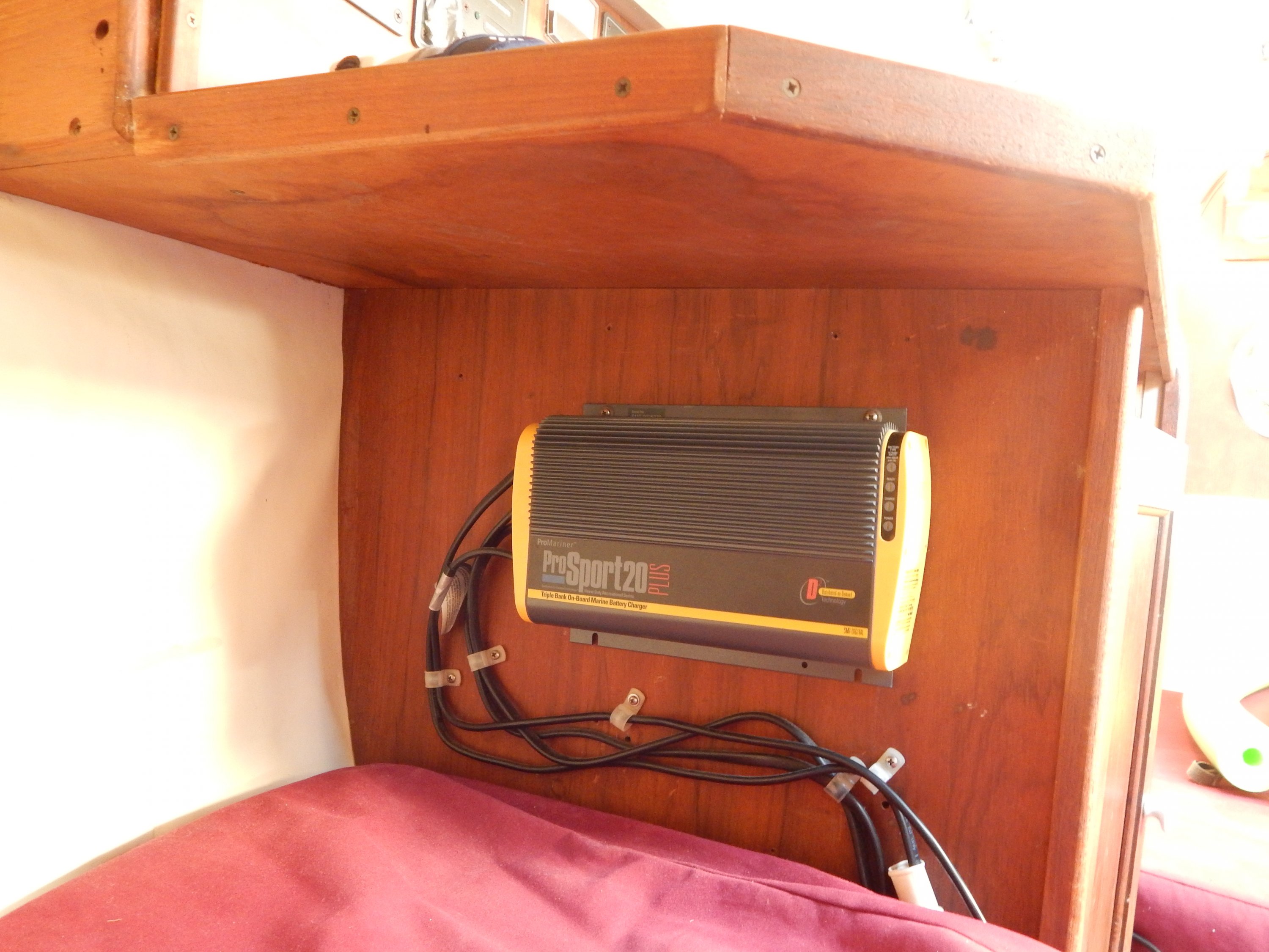

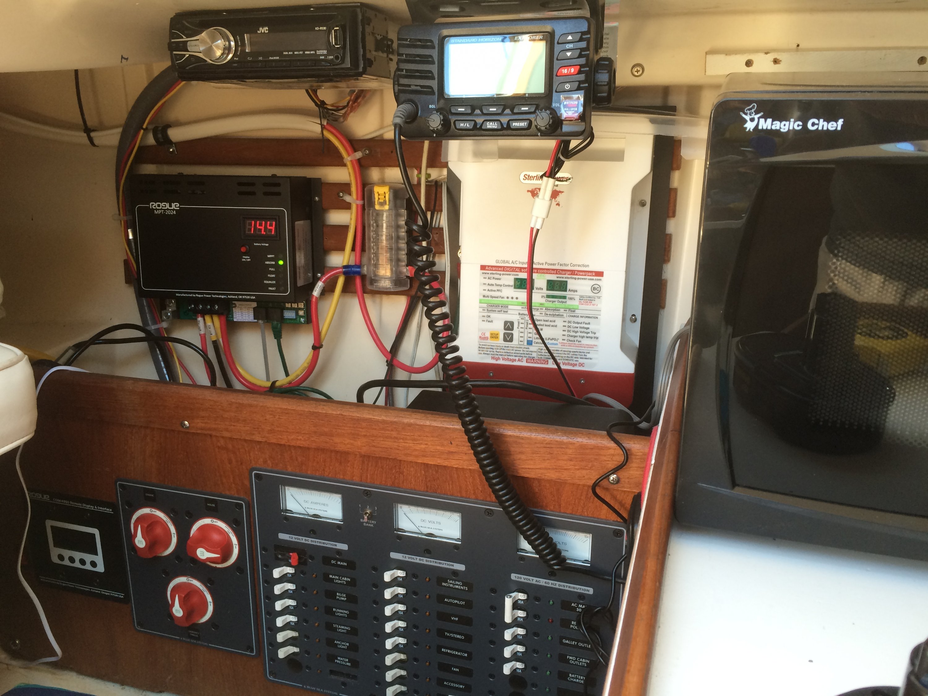

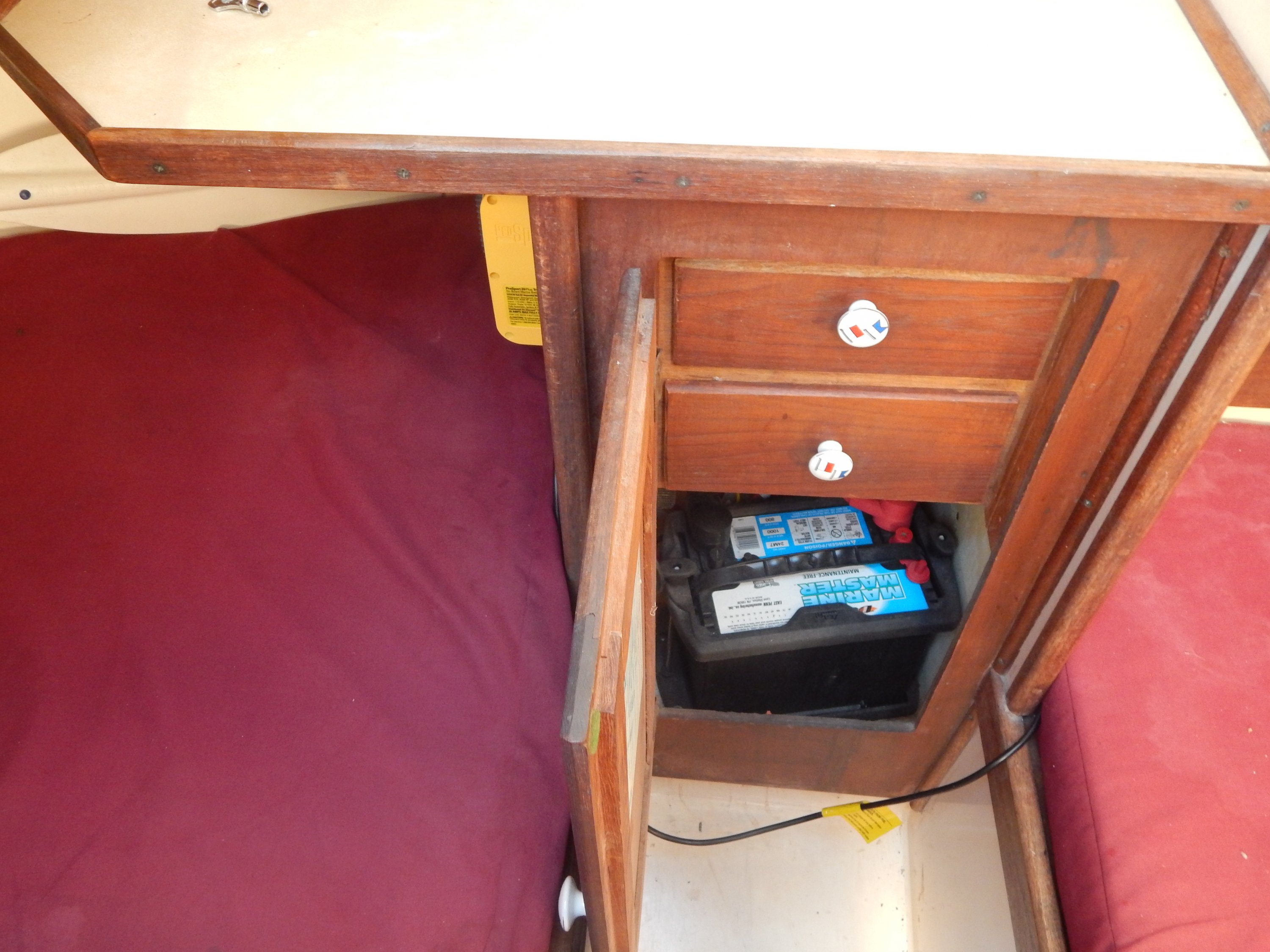

Here's how my charger is set up. Very short runs to batts.
Pic #1 Looking at starting batt under nav table. Charger is mounted to the left. That yellow thing.
Pic #2 Looking from the Q-Berth aft. Charger is under the Nav table overhang. Wires are going to the house bank under the Q-Berth and there is a hole for the third set going to the starting batt. This is a three bank charger.

Yeah, that does look good. GT's got the same charger I just got I believe (based on Maine Sail's recommendations of course). I would like to have my breaker panel up away from the floor, but it looks like that fits a lot of components in a limited space and still keeps things usable.

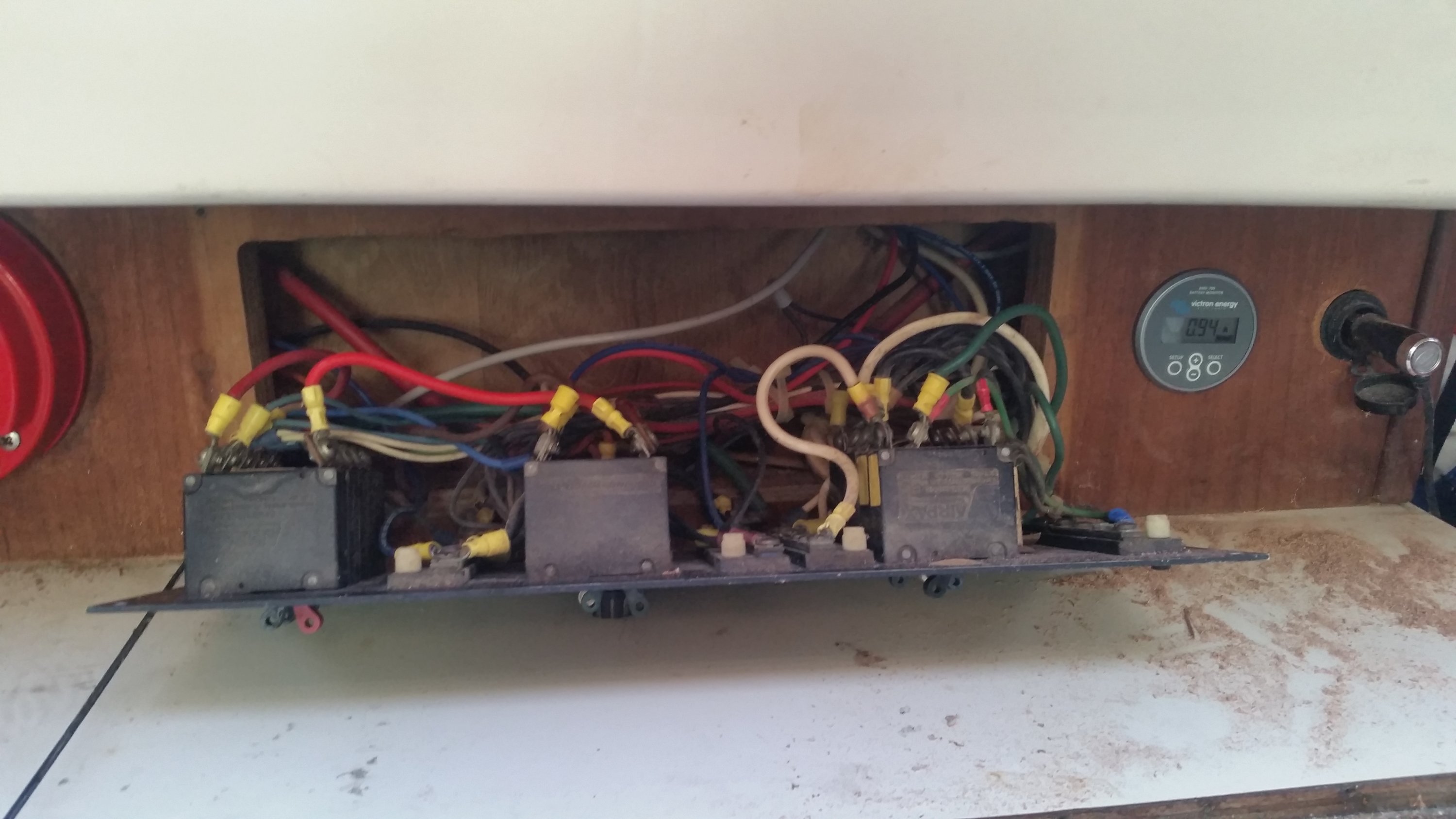

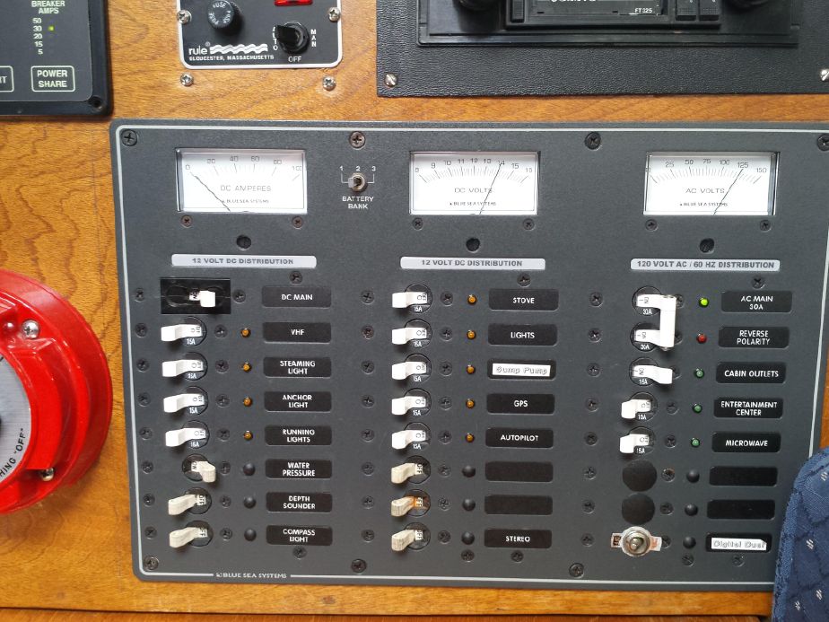

Hunter sure made some changes when they switched to the 31' My breaker panel and battery switch are mounted just below the companionway directly above the engine. Batteries are located in the starboard lazarette

Can anyone comment on whether they would like to be able to reach the breaker panel from the cockpit? It seems like a pain to climb down into the cabin if you need to flip on deck lights or talk on the radio.
Pateco, That's an interesting idea. I think I could lean into the cabin access the panel from standing in the cockpit. But there's so much overhang of the companionway in my boat, that you'd have to squat down to see things when you're in the cabin.
You can lean in and switch the breakers, but at night when you need to turn on cabin lights, running or steaming lights you need to be able to find the correct breaker by feel, or go below to read the labels.
