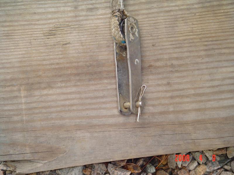

Be aware that what Rudy sends you for a shackle may not be narrow enough. When I replaced my pendant line from D&R, the supplied shackle would still get wedged in the cb trunk. I replaced it with a shackle with a self-locking allen head pin, so the head of the pin sits flush with the side of the shackle.
Aug 31, 2009
78
Oday 25 Branford, CT
Trinkka said:
Here's the shackle that I bought off Rudy years ago.
Huh, that doesn't look like the stock part that came with my pendant line. Did you specifically ask him for a narrower shackle?
Jan 24, 2005
4,881
Oday 222 Dighton, Ma.
No. As a matter of fact, when I went to his shop years ago with my old pendant line looking to buy a new one he looked at my shackle which was very similar to this one with the exception that my old shackle didn't have a small spool for the eye splice and he showed me the one I have now.
He said that the spliced eye would hold up better with this type of shackle so I bought the line and the shackle off him and spliced the eye on it myself. I've since inverted the line and re spliced it. I'll probably replace the line some day and splice the old shackle on to it.
This shackle may be too long for your keel slot depth if you use the existing hole in your centerboard. My keel slot also has a special pocket for the pendant line sheave which you O'Day does not have and this can make a difference in how much room you may have when the board is all the way up. Width wise, it would work on and O'Day 23 or 25, but the length could be a problem unless you can relocate the hole in the board so that the shackle jaws go in further.
