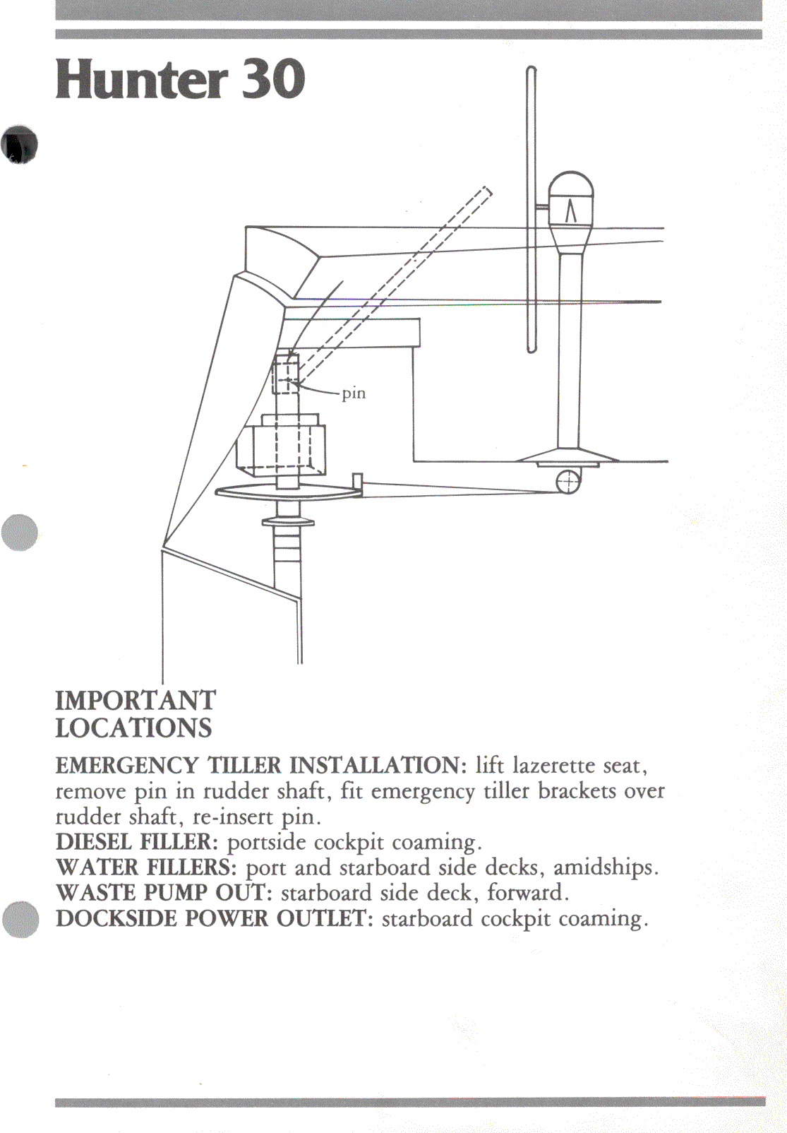

Well it looks that after almost 40 years someone has found out that Hunter forgot to install a deck plate. It has apparently not been needed which could say something for the quality of the steering components. The thing is if a deck plate is not installed now and then it is needed I know I would be hard pressed to refrain from opening up a hole with the emergency tiller itself.
Jun 4, 2004
392
Hunter 31 and 25 and fomerly 23.5 Stockton State Park Marina; MO
From the Hunter manual available on this site. Not sure what model years its valid for.:
