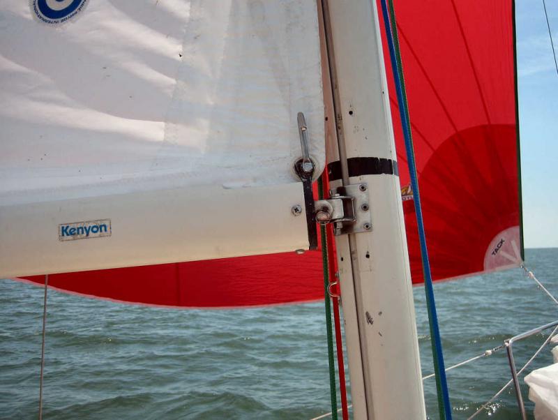

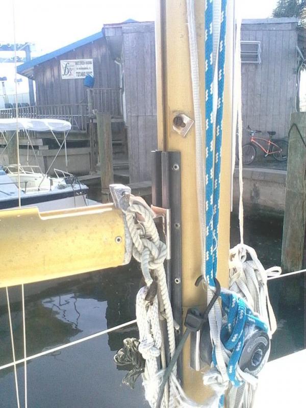

And still need help with mast sail measurement and reasons why. The boom has a 2 foot up and down adjustment on the mast, yes I can guess but your better at this.. no ?
Its a boom downhaul. Works like a cunningham. Popular back when your boat was made but not anymore. Mainsails for O'day 25s are standardly sized; I'd just look up the measurements and order/find one based on that.

thanks, but im making my own sails
I love the sailor words like downhaul, to guess, it means push down on it to tighten the sail...which petty much means stretch it Cunningham... these are all brit terms, don't we have our own boat language ? I'm good here... I figure sink just plugged and I'll run water though it and see where it comes out. Thank you again sir. Just me Oliver

Does your mast have a black line on it about the middle where the boom slides up and down? That is your where the boom should be when things are adjusted well, I believe. Mine does and so does the end of the boom. I think it has something to do with making sure the sail is not oversized if racing?

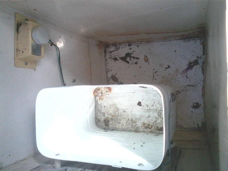

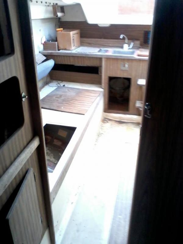

Excellent, I will look for any black mark. Guessing not there. Yes frig next to sink, that's the one that is plug, it gives no tail of where it goes. And by the way... is the frig ac or dc ?
Ward H
Nov 7, 2011
3,843
Not a frig. An ice box. Made to hold a block of ice with your food on top. Ice melts and drains out the bottom into the bilge. I only found where the hose went by sticking my phone into the bilge and taking photos in blind spots.
The design doesn't make much sense to me. I want my bilge dry, not wet. I use the ice box for storage and carry a cooler for my cold stuff.

ok this sounds lime mine
Ok so your saying there's a hole in the bottom of my boat... not good big grin... heavy rain today stopped me from more investigate work and pics. Im guessing my sink is plug with crap because the valve shut off is there in plain site, and it meets with the ice box drain and dumps into the bilge. I do not remember seeing a drain in the ice box, must be small on the side some where. This boat sure is heavy for its length, almost 7000 lbs, that's like way over three 1975 fleetwood Cadillac's... I have no anchors, what size and kind do I want ? And rope length - type
In my 77 the ice box drains to a "Y" that connects to the sink in the galley. It then goes to a thru-hull out the bottom of the boat. This is a good book for starting out too;

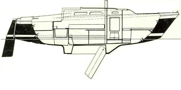

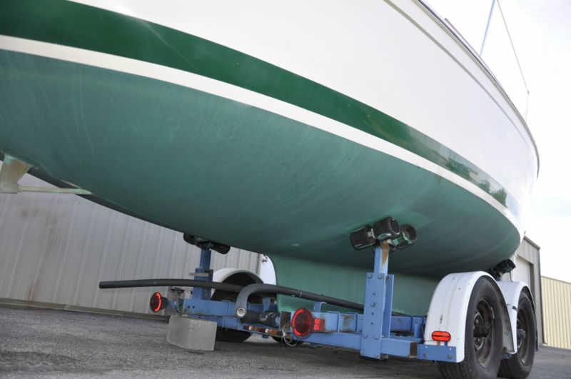

You are quoting the specs for the O'DAY 27, not the 25.

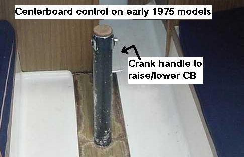

The "shoe" refers to an option on the 27 to add depth (and weight to the keel), some 27s had deeper keels that the 4' standard fin keel. This gave them greater stability and better ability to sail closer to the wind. Draft was 5' on these deeper keel 27s. (this was the 1973-78 O'DAY 27, not to be confused with the later, 1986-89 O'DAY 272 and 272 LE)

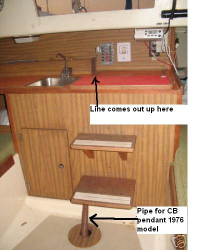

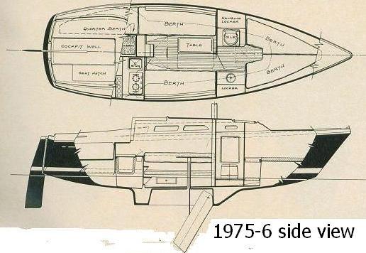

Is your 25 the Keel/CB model (shoal 2'3" depth keel with a centerboard that retracts into it) or the deep-fin keel model? You mentiion not having a centerboard, is htat because you have the Fin-Keel model? Or do you have the K/Cb model and it seems to be missing the CB? The 1976 models and later with the K/CB had the Centerboard pendant (control line) located at the forward end of the cockpit on the forward bulkhead of the footwell. Early 1976 and all 1975 models of the K/CB had an aluminum post in hte center of the cabin (under the table) with a crank on it to control the CB.
Someone mentioned about hte rudder being deeper than the keel, that is only on the K/CB model, obviously on the Fin-Keel the rudder still only goes about 2'5" into hte water even though the keel is 4'6" deep.
I've added some pics to help, even found one showing that black lline on the mast that was mentioned.

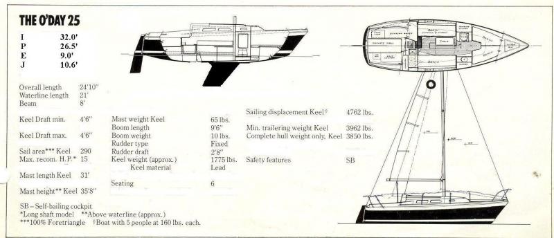

O'DAY 25
O'Day 25 photo on sailboatdata.com
O'Day 25 drawing on sailboatdata.com

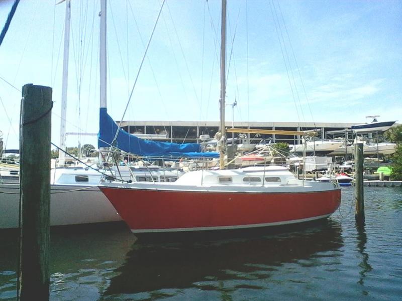

Mine is the fixed keel version and taller rig.Yanmar inboard diesel has been removed.
Hull Type: Keel/Cbrd. Rig Type: Masthead Sloop
LOA: 24.83' / 7.57m LWL: 21.00' / 6.40m
Beam: 8.00' / 2.44m Listed SA: 269 ft2 / 24.99 m2
Draft (max.) 6.00' / 1.83m Draft (min.) 2.25' / 0.69m
Disp. 4007 lbs./ 1818 kgs. Ballast: 1825 lbs. / 828 kgs.
SA/Disp.: 17.11 Bal./Disp.: 45.54% Disp./Len.: 193.16
Designer: Hunt & Associates
Builder: O'Day Corp. (USA)
Construct.: FG Bal. type: Lead
First Built: 1975 Last Built: 1984 # Built: 2898
RIG DIMENSIONS KEY
I: 30.00' / 9.14m J: 10.60' / 3.23m
P: 24.50' / 7.47m E: 9.00' / 2.74m
PY: EY:
SPL: ISP:
SA(Fore.): 159.00 ft2 / 14.77 m2 SA(Main): 110.25 ft2 / 10.24 m2
Total(calc.)SA: 269.25 ft2 / 25.01 m2 DL ratio: 193.16
SA/Disp: 17.12 Est. Forestay Len.: 31.82' / 9.70m
BUILDERS (past & present)
More about & boats built by: O'Day Corp.
More about & boats built by: Bangor Punta Corp.
DESIGNER
More about & boats designed by: Raymond Hunt (C.R. Hunt & Assoc.)
More about & boats designed by: John Deknatel
NOTES
One of company's most successful models and in production for nearly a decade.
A majority were delivered with a keel/cb, but a fixed keel version was also available, as was a taller rig.
Yanmar inboard diesel available as an option.

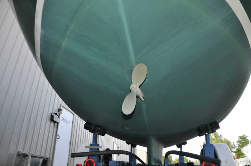

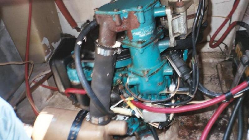

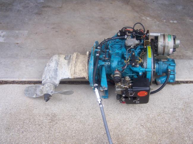

Yes, I now realize that I have a 27 oday owners manual, mines a 25 I believe, not good. I added a couple pics. I have some more questions but I need to upload more pics first. Did these boats, the 25, ever have a inboard motor ?

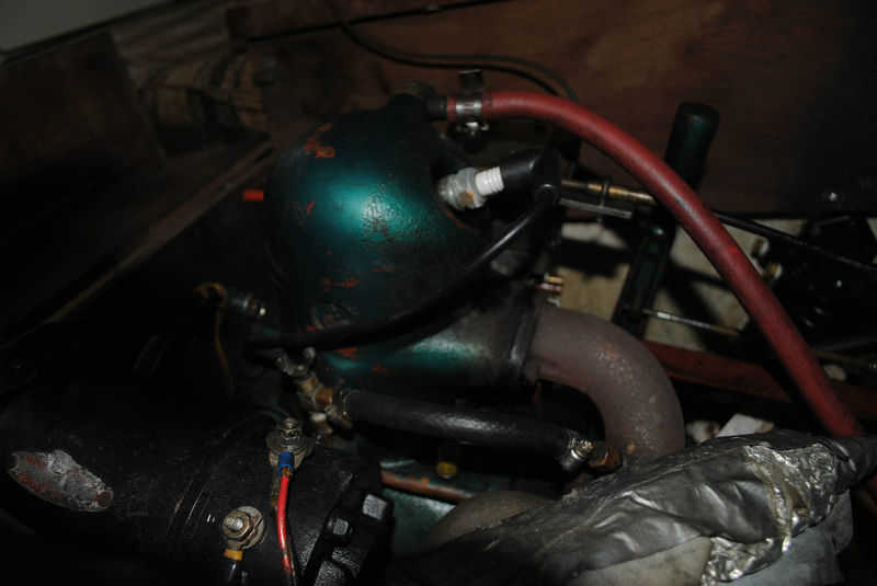

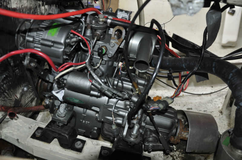

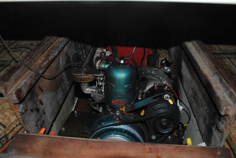

Yes, an inboard was an option most years. Original (1975-76) option was a 6 or 7 HP VIRe 2-stroke gas inboard, later (1977-81?) this was changed to the OMC "ZEPHYR" 15 HP 2-stroke gas saildrive (with outboard-style lower unit installed through hull) this engine was actually based on hte 35 HP Evinrude/Johnson outboard powerhead. Finally, for hte 1982-83 models the option was a 7.5 HP Yanmar Diesel.
Some boats had inboards added (or updated) later. Including a few boats with Diesel saildrives (Volvo-Penta or Yanmar) and a few that added newer gas saildrives using a HONDA outboard powerhead (8 HP).

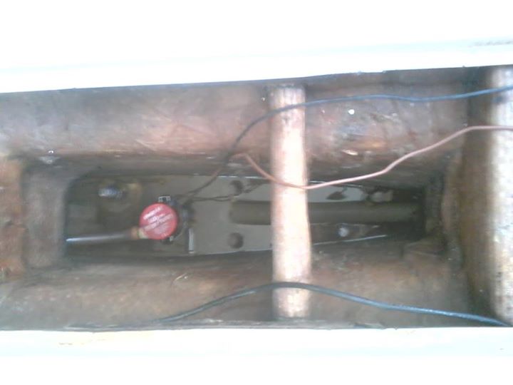

The 25 pictured below is a 1976 model that I think had the original VIRe gas engine replaced by a Yanmar Diesel. The pictures of the VIRE engine below are actually in an O'DAY 27, but they were the only pis that I could find of a VIRE.
D&R Marine sells O'DAY 25 Manuals, or at least the original rigging sheet ($10 including shipping last I heard). Pretty basic, but that was what came with the boats. I have created a more updated/expanded version that I can make a copy of.

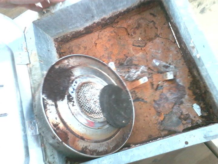

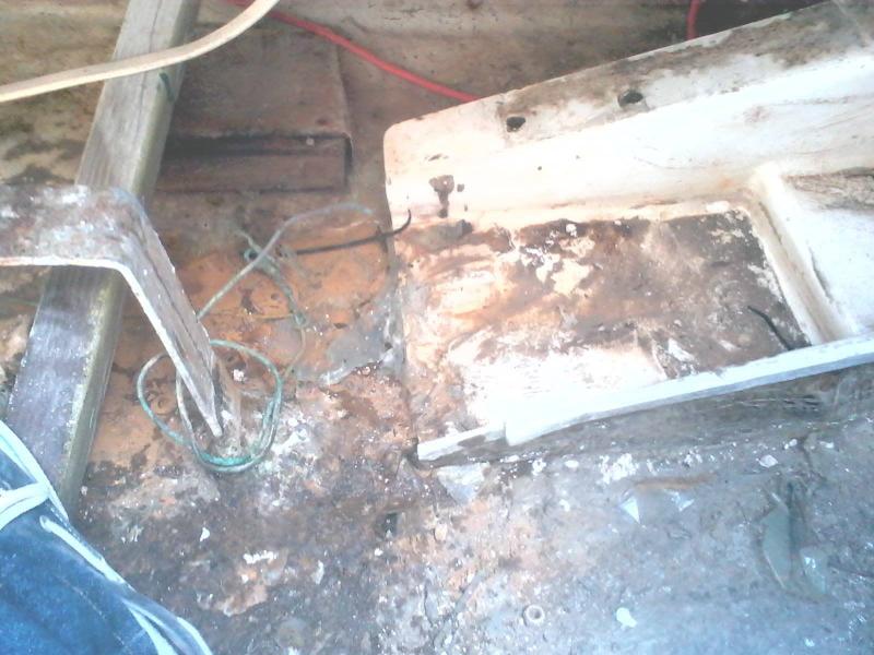

yes, good pics, this pic is
This pic is what my boat had, it's been removed but you can still see all the structure. I read there fumes would make the family sick before they left the harbor... glad it's gone.
