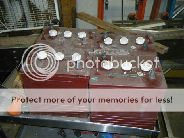

Great thread. I have 6 Trojan T145 batteries on my Hunter 40.5 which I just purchased. They are only 2 or 3 years old. I purchased the boat in October at Longbeach and went back to Australia during which time which it was left by someone other than me with a few appliances running and no shore charging. They were down to under 12 volts when I arrived 1 week ago.
I charged them for 4 days with the high powered heart charger and done a crude load test just turning on roughly 15A of load and monitored it with the E-meter. Overnight I am down to under 12V and the E-meter only reads 180ah.
The battery boxes I have fit the T145s pretty much exactly. So if the battery is bigger in any dimension they will not fit. Are there any cheaper batteries that are the same dimensions or smaller than the T145s?
I bill be doing a years worth of offshore cruising with these. Do you think it might be worth it in my case to just get new T145s? Is there any chance I could repair these batteries with anti sulphation liquid etc?

Dennis, forget the reconditioning. From your description of the load test, they are way gone. I sent an e-mail before I saw this thread: dimensionally, the T145's are slightly taller than T125 or T105's but are the same with and length, so fit will not be a problem with WalMarts or other 6 volt Golf Cart batteries.
As for the decision to purchase T145's or Sam's Club or equivalent, the only thing I can say is that I am getting about the same use with the Sam's Club as I did with the T125's I had, namely about three years. However, Trojans have a great reputation and terrific quality, so in the grand scheme of things, $600 more may be worth your piece of mind and you'll have 120 total more amp hours (if that makes a difference). Tough call.

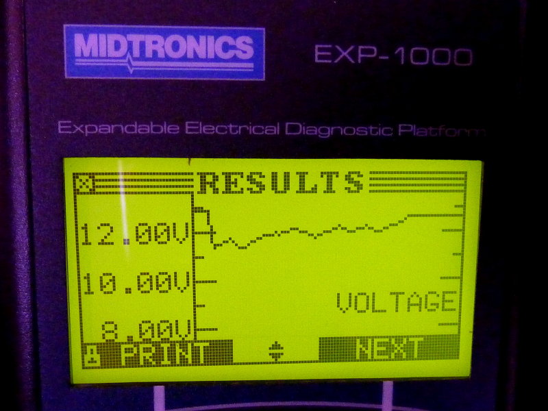

The last photo shows how the battery bank supported voltage during the starting event. This is exceptional performance for six year old deep cycle batteries that have been in a deep cycling application. What makes this even more impressive is what temperature the batteries were, 32F....
For a $210.00 bank of Wal*Mart batteries, that have never been equalized, and have been stored on the boat every "harsh winter" winter, and even went one entire winter without being "topped off" at all, I'd say were are getting stellar performance.....
