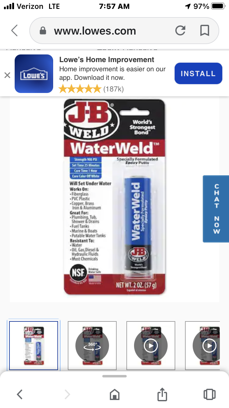

I would use this
It is the consistency of play dough and is very strong. I’d also not use actual wood but some Trex like material for the board
Actually if you want to go cheap on the board, go to Walmart and buy a cutting board. I've used those for various projects and they have always worked well. No cracking or breaking in any weather. I even used one to raise the backrest 6 inches on my scooter. The stuff is cheap and you can usually find many different color choices including white.
