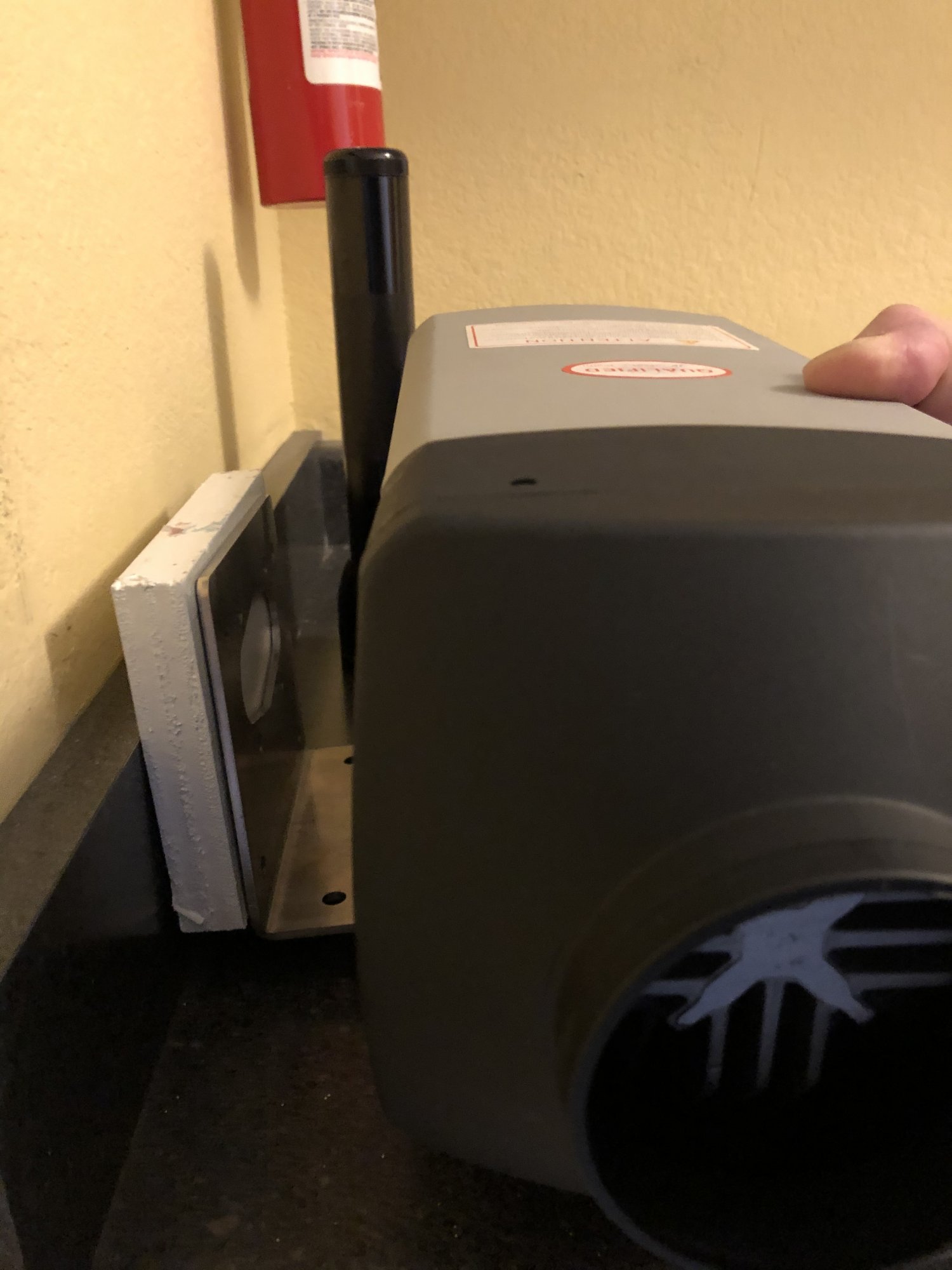

Looking at the directions for the application of 3M 5200, it says nothing about surface preparation. I.E. scuffing or removing paint. I have a 4"x4" piece of 3/4" plywood I painted on both sides with primer and 2 coats of latex paint. I plan on attaching this plywood to the inside hull to attach a heater. My question is do I remove the paint on the side to be bonded or leave it painted or does it matter?

I read your original post and trying to understand the 4X4 inch plywood piece under a heater. How big is this heater compared to the area you’re mounting it in? I would probably use flat stock aluminum, predrilled for four screws or bolts. Pictures help. The heater is a great idea, I’m already jealous.

The heater is about 4”x 10”. It will fit in the aft locker which is maybe 3’x4’. It will be mounted on a steel L shaped plate.
