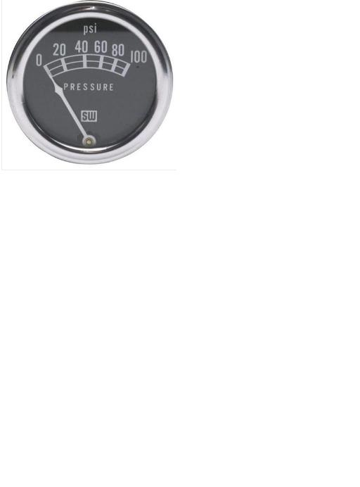

Tim: I no longer own that boat but I don't recall any colors on the gauge front. Just white on black background. Looked like this and about 2 inches in diameter.
