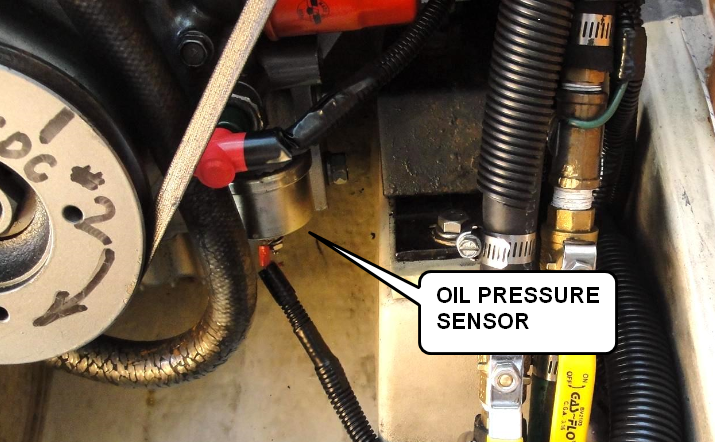

this may be helpful
Jan 4, 2006
7,770
Sensor as the resistance does not change from engine not running to engine warmed up. I am assuming thats how it works?
Exactly.
Stay away from marine stores on this one and go to an automotive store. Everything else that goes into or on to my engine is genuine Yanmar (except for oil and oil filters). I seem to remember the Yanmar sensor being even more 20 years ago when I installed my automotive sensor. The sensor was not going to affect the engine whether it worked or not so no harm. The sensor has only lasted 20 years so far but it's still hanging in there.
There are adaptors available for that. Get a steel one for strength.
Interesting what @RoyS mentioned. Couldn't find an adapter back then and a quick look didn't send anything that glared out at me now, but I bet there is such an adapter in this day and age. Well worth the hunt.
