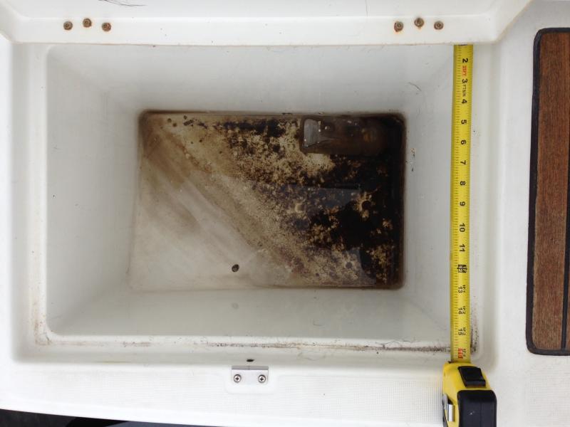

I guess almost everyone knows the stern on the 473 sits a bit low. This means the drain in the storage locker in the swim step is under water. There was always a couple of inches of water in the bottom of the locker. If I didn't clean it every week, it would get a lot of growth (Southeast US, salt water). Once, when I was away from the boat for several weeks, there were oysters starting to grow.

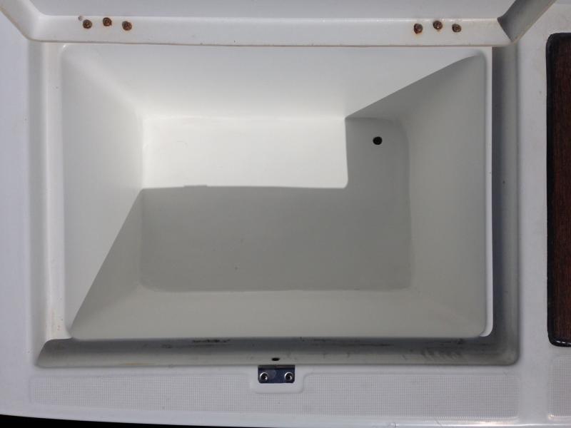

We're currently in the West Palm Beach, FL area, and I'd heard good things about a fiberglass guy called Ron Ternullo. Ron did an amazing job. He extended the drain upwards, then filled the bottom of the locker with expanding foam, and fiberglassed over it. All while the boat was in the water.
I couldn't be happier with the result.
Now I have a usable storage locker for masks, snorkels, and fins.
