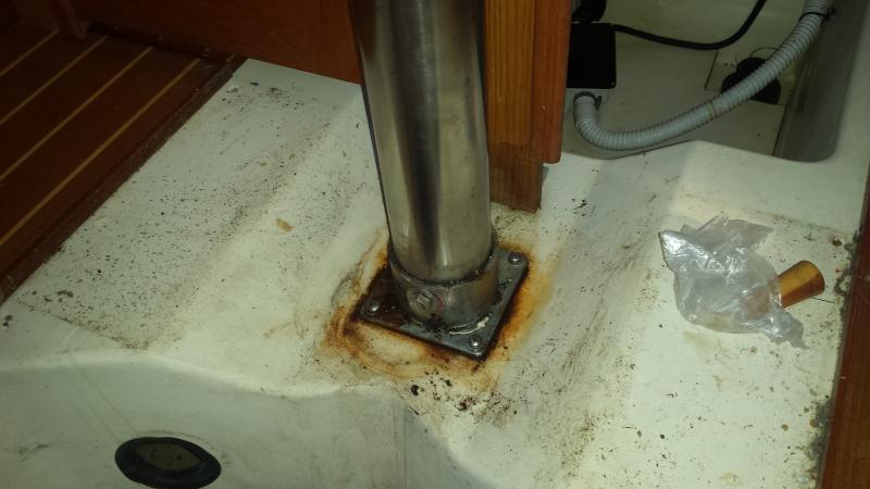

I have a 460 in the UK which has a leak I am trying (frustratingly) to trace.The boat is out of the water by the way.
I think it is coming in via the mast step and then travelling down inside the compression post exiting at the bottom. I found water there today (see photo) and about a gallon in the bilge - which I had dried out last week. We have had a lot of rain.

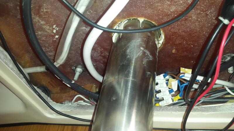

I believe the mast compression post is hollow and can see from underneath where it pokes through a hole in the deck presumably to sit under the mast deck plate. I believe the deck plate is solid apart from the bolt holes which are dry on the inside.
I can find no water in the area under the deck hence why I think it must be travelling under the deck plate and then down inside the post. My confusion is how so much water is coming in as I am struggling to find any significant gap at deck level and am a bit loath to take the mast off just to have a look.

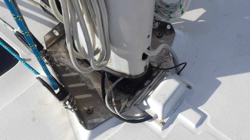

Your boat is of a different model, but if your boat is built similar to ours, the odds of water flowing through the mast step and down inside the compression post is unlikely. Our leak could be seen running down the outside of the compressions post and I repaired it as follows:
While Belle-Vie was on the hard for repairs awhile ago with the mast unstepped I addressed a number of minor maintenance issues including a small leak through the mast step into the salon.
The mast step is held in place with four SS flat head through bolts with lock nuts. This step has a drain hole on the head end bottom side so that rain water entering the mast head can drain out through this small hole at the bottom. The electrical wires run through a short piece (original was two inches long) of one inch plastic PVC pipe that is inserted in a hole in the coach top. You can see this piece of pipe if you remove the covering from the top of the compression post.
The pipe is supposed to be sealed, but over time this seal failed, so water coming from the mast head would leak around this pipe and into the salon. The PO tried to use Silicone II from inside the boat but that did not work.
After cleaning the cast aluminum step plate and coach roof surface I used 3M4200 sealant to rebed the plate. The new three inch piece of PVC was placed with a liberal amount of 3M4200 around where it entered the coach roof. The PVC pipe extends about two inches above the coach roof so that any rain water pooling at the base will run out through the weep hole in the step plate. Be sure to leave a drip loop in the wires that enter the coach roof.
Each season I use a pipe cleaner to clear out any debris in the step plate weep hole. This repair was done in 2002 and it still remains dry.
