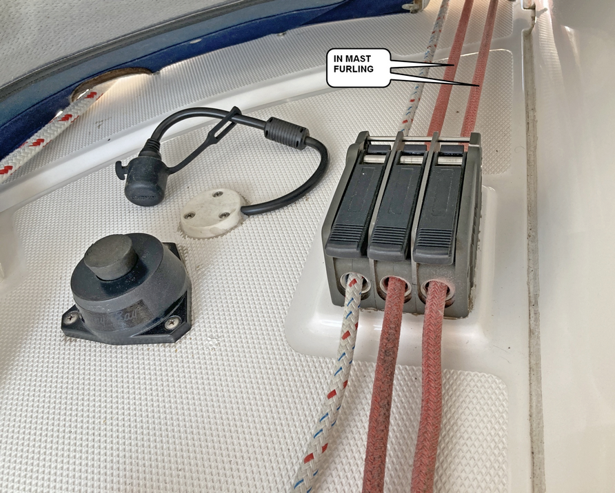

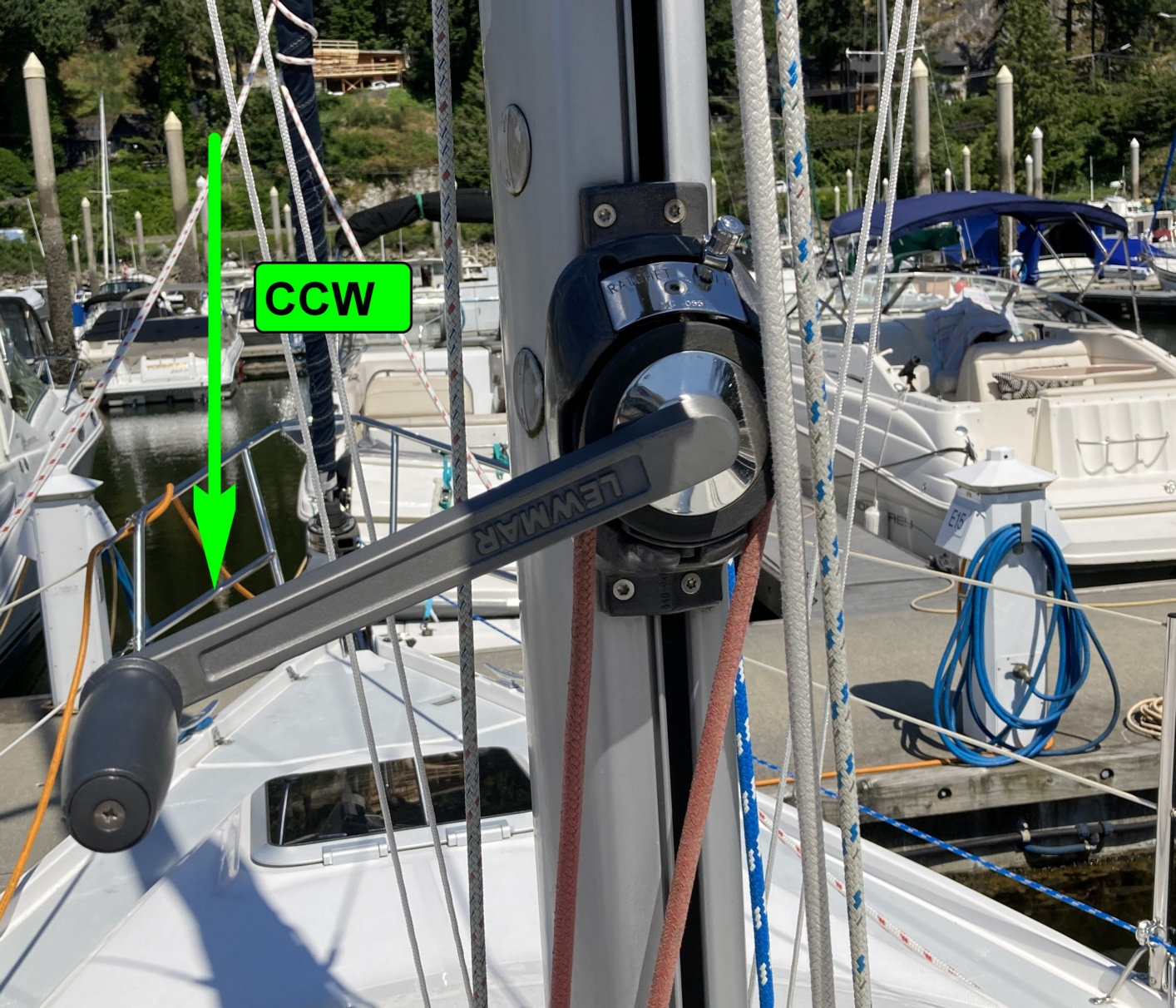

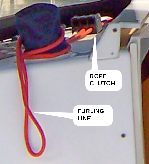

We have a 2009 Hunter 45DS with in-mast furling. The furling unit on the mast has two settings: free and ratchet (locked). In the free setting, the sail can be unfurled as the circular line running to the cockpit is not engaged. In ratchet (locked), we can furl (retract) the main via the circular ropes that come through cam cleats on the port side of the cabin top inside the cockpit.
In essence, to unfurl we have to let the sail run free with the crew moving the unit on the mast from locked to free and when we want to furl we have to move from free to locked. This is fine in light conditions but dangerous if conditions are bad particularly since we have to have crew quite-literally at the most to move the unit from free to locked when we get to a pre-determined reef point otherwise the entire main can unfurl with no control.
Does this sound right to anyone/everyone? Is there a work-around? The 45DS owners manual doesn't address this.
