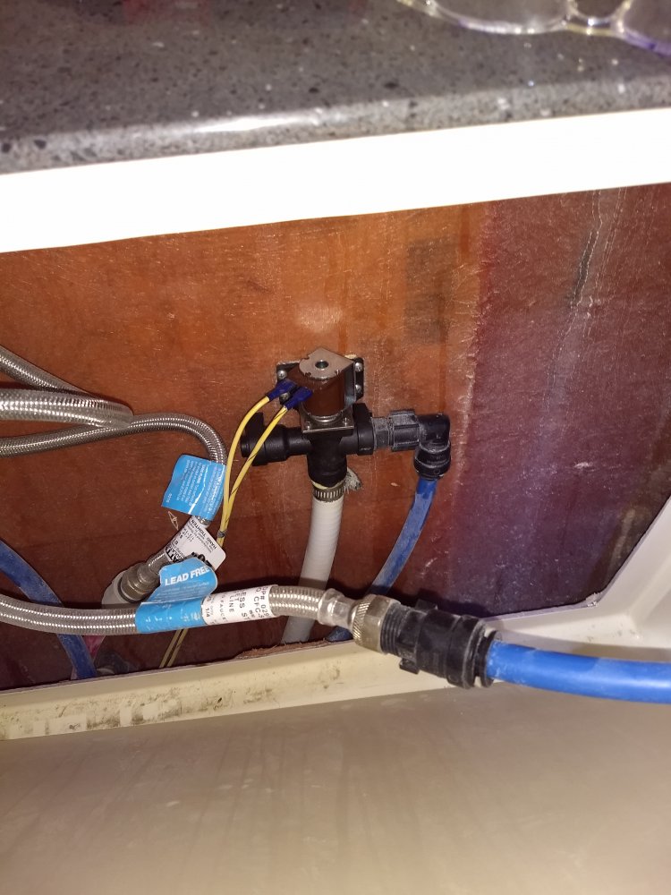

I had the exact same problem. Tried to take apart solenoid valve and clean as per Jabsco's video. After cleaning it still leaked. Replaced with new solenoid valve, problem fixed. On my Hunter 50 valve was located behind panel above seat in aft shower, below ledge. Panel removed with 1 phillips screw. FYI the solenoid valve has clips that hold the water lines. Just pull out the clips on the old valve, insert fittings into new valve and replace clips. No need to remove hoses from barb fittings.

I'd love to have a higher resolution copy of that photo for my files. If you'll let me have one, I'll send you a PM that includes my email address (no way to attach anything to a PM).

Pity Bogart's switch/valve assembly was not as accessible - it is under the vanity bench in the aft head, with several hoses in the way.
Anyway, took it out and cleaned it - quite a calcium build up near the diaphragm - worked fine for 3 weeks. Just took it out and cleaned it again. Suspect it will need replacement soon.
