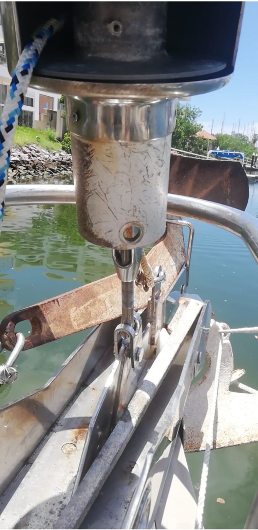

Recently I hired a rigger to change the standing rigging. At the end, somebody lost the pieces below the roller furling drum. May I have some pics, or part numbers, so I can look up for them, or have an idea to build them... thks in advanced.!

What furler are you using?
Are you talking about the turnbuckle?
The threaded stud and toggle to attach below the turnbuckle?
These are based on the wire forestay you are using and the specifics of the furler. They are readily available from a chandler carrying sailboat parts.

My 1998 H430 used Profurl.
Jim...
PS: That may be Harken

It looks similar to the Harken MKIV but not going to guess. Owner needs to verify.
If a Harkin you need to identify the pin size so that you get the correct one. The image looks to show a rather small turnbuckle. All the more reason to be sure of what you seek.

Right now I´m remote, don´t have close access to the boat. I´m gonna look at Harken website.
What parts should I look for? or how to start the browsing?
Roller Spare parts ? Turnbuckle?
24,949
You will need to look at all of the units because you do not know the specific unit.
You’ll find they list the furler parts. It is about the details. You need to know how your forestay is terminated. Then you can try to match it up.
