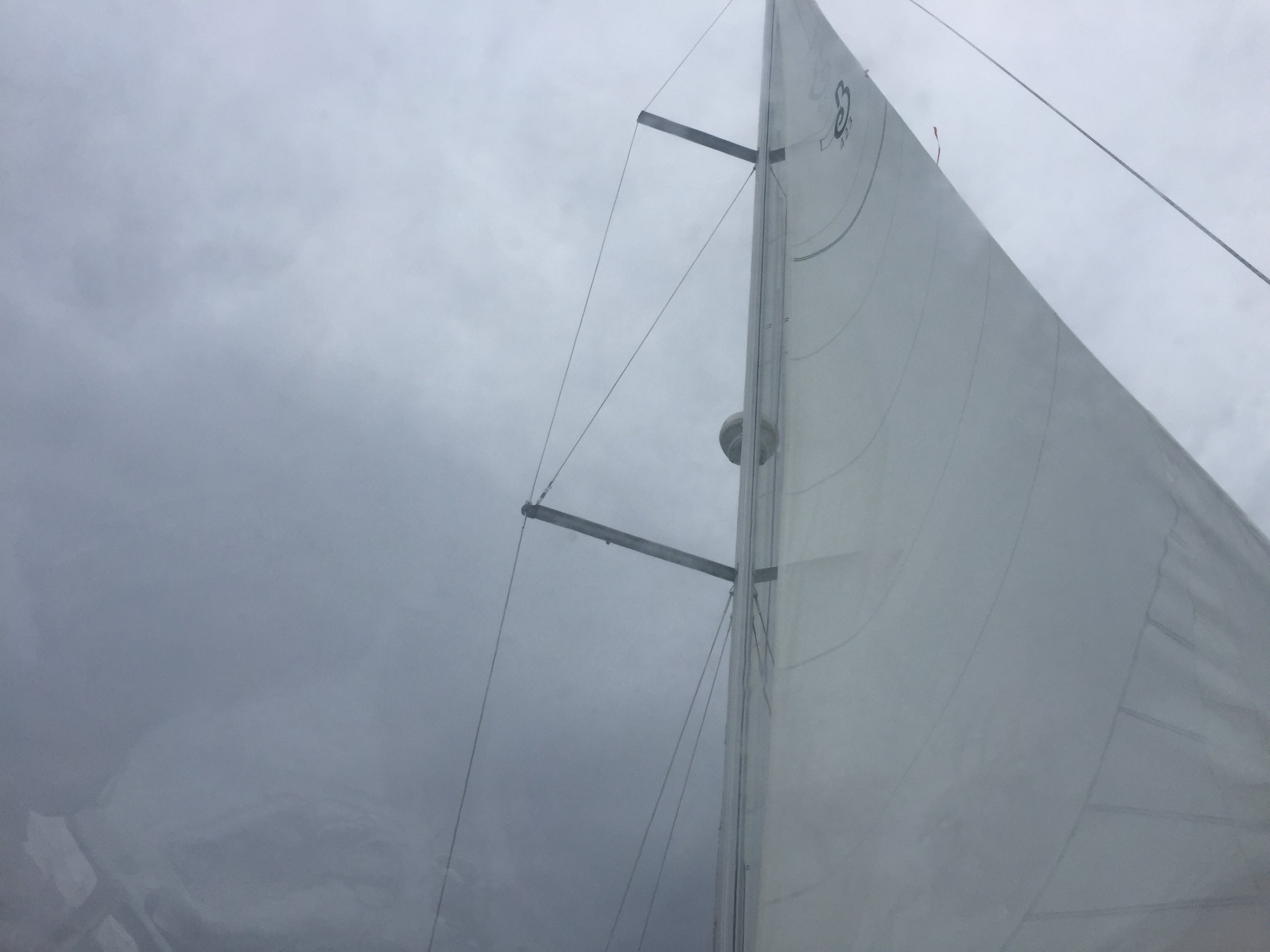

So yesterday was first time sailing new boat which also meant first time using an in mast furling. Rigger helped me put sails on and said luff of sail does not slide into the foil like headsail. Is this correct as the overal shape didn't appear right. I did have to add more tension on main halyard which helped a bit but..... still boat sailed great at 7.5 knots in 12 breeze. Attached is a picture.

The picture looks strange. Is there a gap between the sail luff and the mast? How do you get a clear picture of the radar dome and the spreader through the sail luff and the mast?

If I'm seeing the picture right, the sail is attached to the furler only at the head and the tack? If so, that's definitely not what I would expect. Our Beneteau (US Spars) in mast furler has the sail luff go into the foil similar to the headsail. How can you even furl it if the luff isn't in the mast?

That is what I thought.... have to open access ports and inspect today. Sail actually furled perfect but....... when unfurling sail it had a wrinkle and got stuck for a second. I pulled sail in a bit then she came right out.... then I added a couple turns to add tension on the main which brought the luff closer but obviously not right.
Jssailem.... yes does not look right.
Like I said never used this set up nor have a sailed on a boat that had one so I have no point of reference.

Your gut reaction said something was amiss. I would trust it. Till proven wrong.

I think you need a new rigger! Definitely agree with David on both points; your mainsail is presently attached at the tack & head only. Also, amazed that you could even furl it. I wouldn't use it again until you fix it properly; you're setting yourself up for a major jam. On my 343 (us spars furling mast), there is a furling tube inside the mast that that has a full length slot in which the sails luff tape fits into (similar to the jib). There are two pieces of webbing one at the tack & one at the head that attach to the furling mechanism. When the sail is installed properly, there will be no gap between the mast & the sail's luff.
You will have to lower the sail, open the inspection plates on the mast and feed the luff tape into the furling tube slot. Definitely need two people and a can of sail Kote spray to do this job. Insert the luff tape, spray it, hoist about a foot, & repeat. The difficulty is that there is very limited clearance in which to thread the luff tape. Ensure that there is adequate tension on the luff when finished, because the sail will jam when furling/unfurling if there is isn't enough tension. Refer to the schematics on the US Spars site to view the components inside the mast. Might want to read up on replacing the furling line and servicing / lubricating the furling components inside the base of the mast, as these are items that require routine maintenance to avoid furling problems.

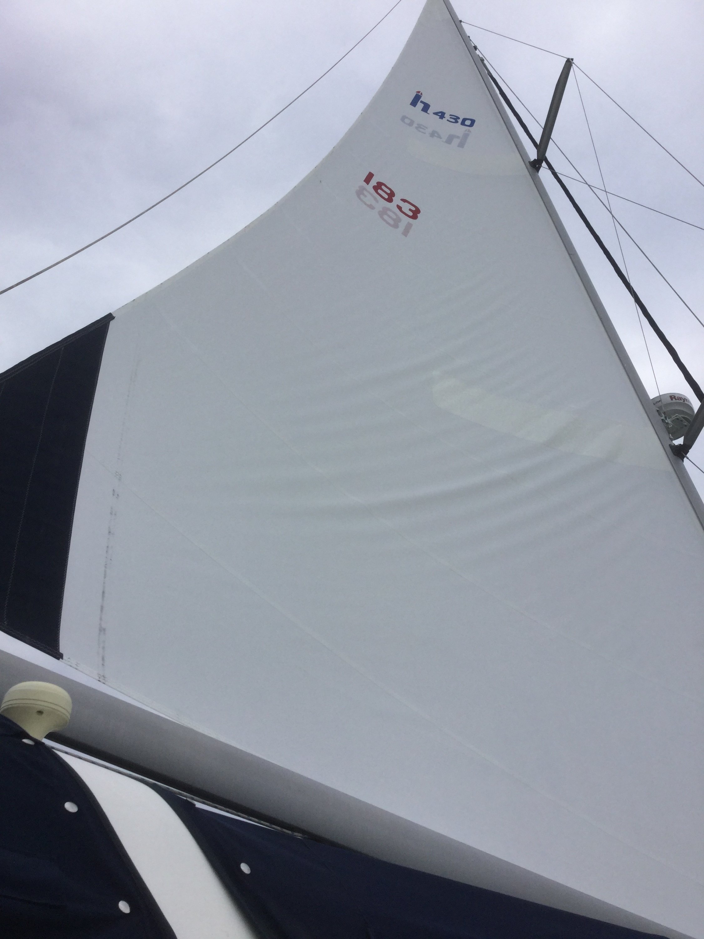

I download his picture to ZOOM in. What the Heck a new transparent sail luff? Here is how it should look...
The bottom 3-8 inches up for the tack would catch outside the groove.
You should seek a better sail maker too
or adjust main sail.
This happened to our new sail. It was my fault. I just pulled up more on the halyard until the groove matched the luff tape.
Our Sail maker new his craft.
Jim...

Jim you make my point. The posted image shows the sails luff is not attached to the mast furler. It is hanging in the air. You can see the spreaders and the radar dome between the sail luff and the mast.
First clue something is amiss.
