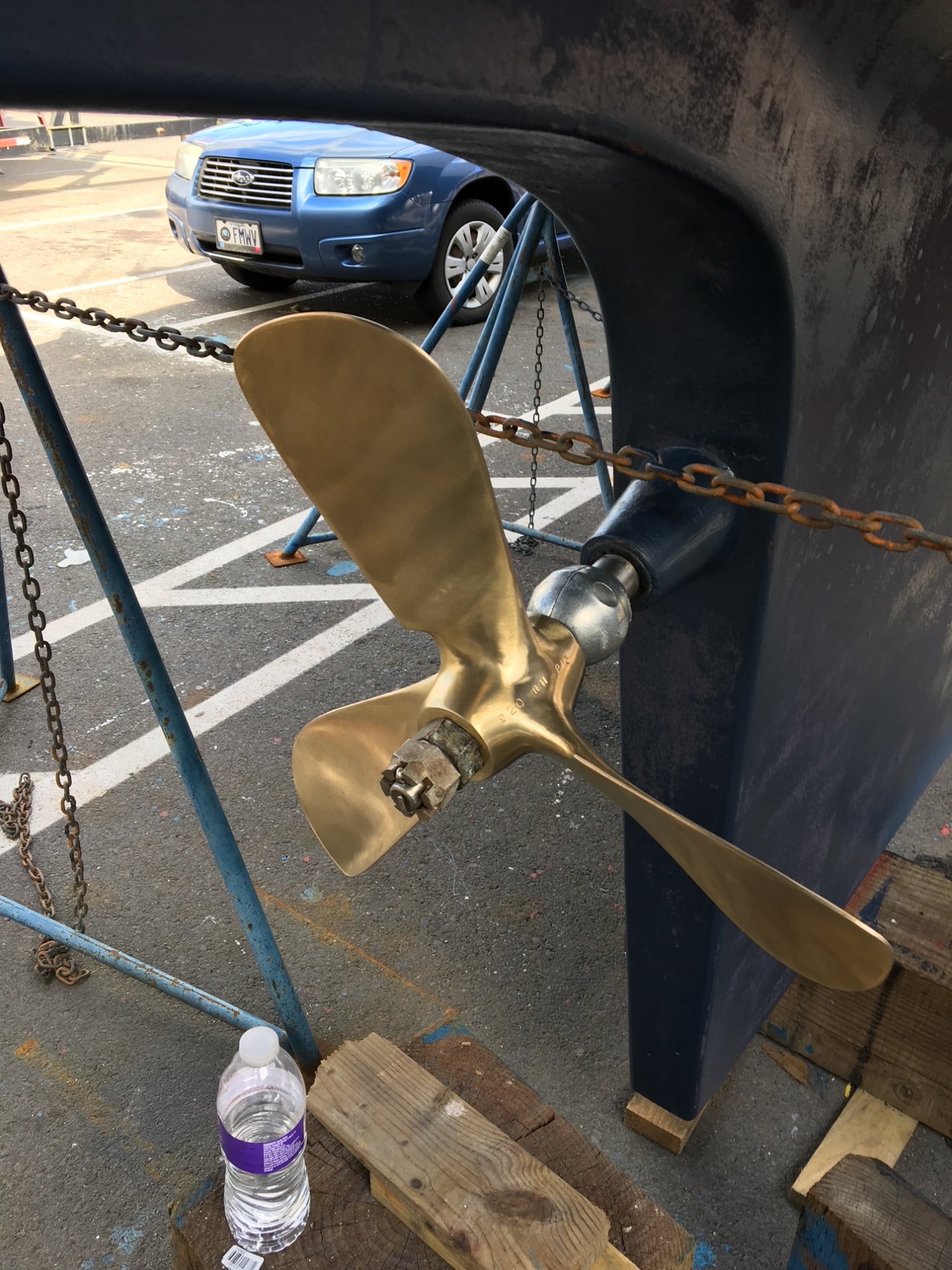

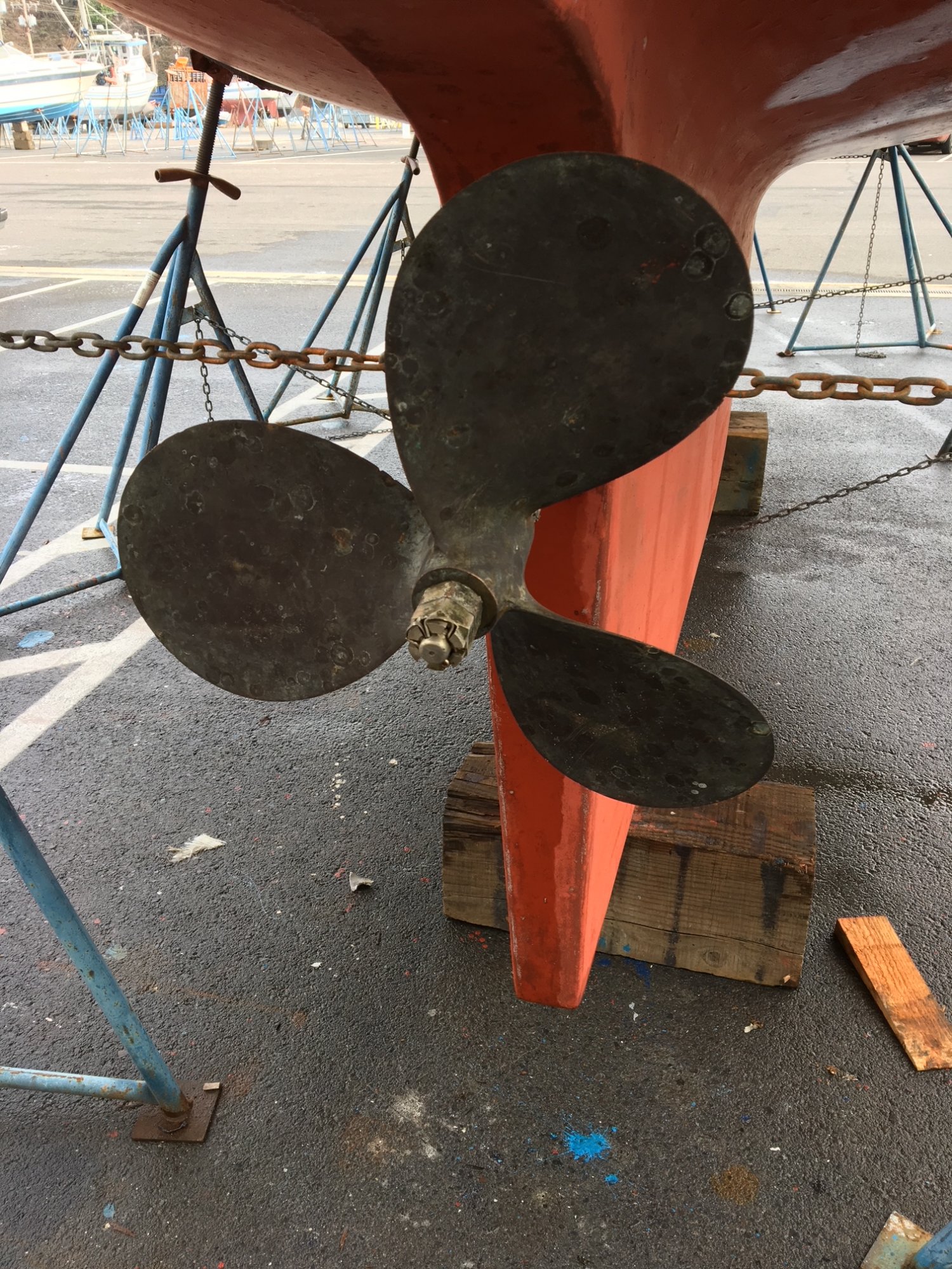

Here are images of the 2 props. The design of the Campbell Sailor is more advanced than the Michigan Wheel.

Quite a difference in the look of the size of blades, I can read the Campbell prop is a 20R X 12. There’s water 500’ deep and can sail for over 100 miles, it just depends on the mast height and can get under the bridges. Most sail on North or South side of those bridges unless your sailing under a 25’ boat. With the wind up there and nothing but prairie grass to stop it, it can give a 40’ all they can handle with waves. The guys would have a guy’s day out when the wind was up 30 and 40 plus, just playing around, women would just stay on the dock drinking wine. I sent in info to Campbell for a quote.
