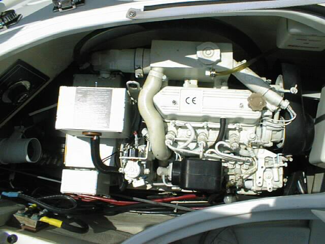

Frank,
I have a Westerbeke 5KW genset in my starboard locker and I used the transom vent as with a 3" fan to ventilate the compartment. The fan runs whenever the genset runs. The picture below shows the white fan at the left edge of the picture. The vent is a 3" vent so all I did was to remove the hose from the aft cabin connection and connect to a fan. I plugged the aft cabin port to stop any fumes or exhaust from entering the cabin.
Westerbeke requires ventilation to help cool the electrical end of the genset. The engine is of course fresh water cooled with a heat exchanger.
I have never had a problem with heat build-up with this system. I would suggest that before you go to a lot of trouble changing the transom vent that you simply try a 3" in-line fan. Be sure to use a fan that is rated at 100% duty cycle and is also ignition protected if you need that feature.

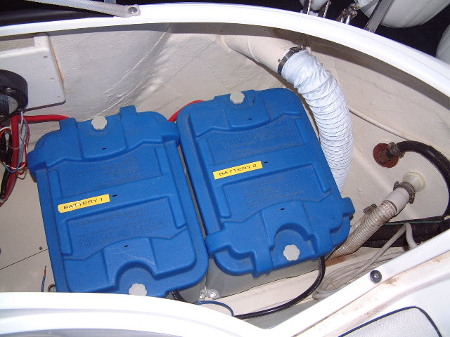

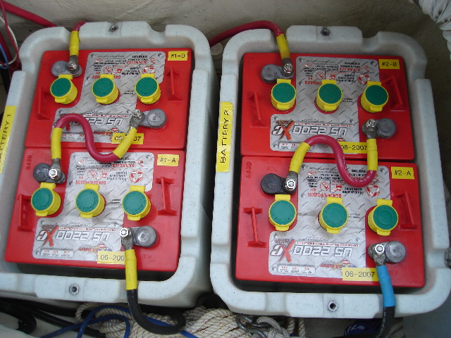

That is a nice installation. Where did you put your batteries?
Feb 10, 2004
4,256
Hunter 40.5 Warwick, RI
Frank,
My genset also has a fan inside the electrical end. But the 3" transom fan exhausts plenty of air to keep the compartment under 130-140 degrees.
Is your genset air-cooled? If so, maybe you do need a larger vent because you have the engine heat as well as the generator heat.
My batteries (four golf carts) are located on the port side to balance the genset. BTW I also hi-jacked the port vent to ventilate the engine compartment. I have a hi-output alternator that routinely runs at 200+ degrees and will heat up the engine compartment high enough to trip my automatic halon fire extinguisher. Not a good thing....
