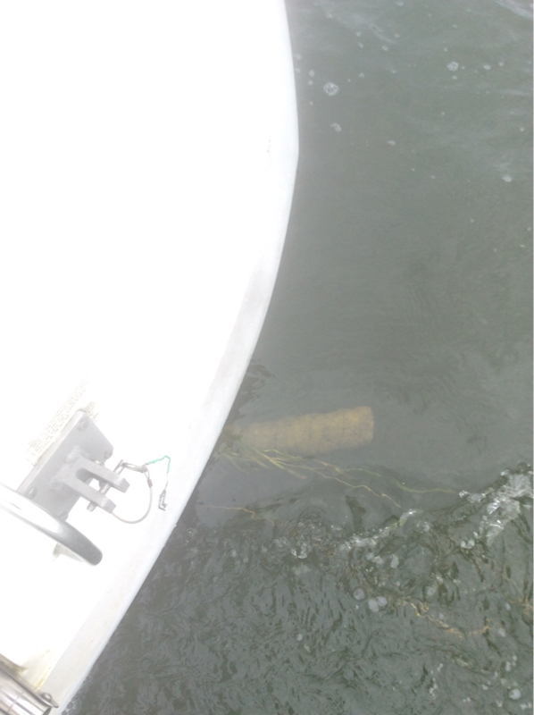

Here goes. It looks like there must be quite a large metal flange coming out of the hull and this is hose clamped to that.
.............. a thousand words ............. my mistake as I thought that the 4" dia. hose was on the inside of the hull.
I'm going to say (based on 15 years experience) that the function of the 4" hose is to avoid having the exhaust filled bubbles from the outlet, backwashing up against the semi-submerged portion of the transom. If you'll notice when you're under way, the squat sinks the transom enough to submerge it by a few inches. Every spring, someone is hanging over the back end of our boat, scrubbing off the black soot from the exhaust.
The attached photo is how the exhaust looks as it comes out of the water with no cleaning. Scrubbed by the passing water while under way. The transom is a little dirtier.
I will say that the hose is probably quite effective in avoiding having the soot staining the transom BUT if you want it there with the problems you've detailed here .................
I've got to wonder how the exterior flanged section is attached to the hull. And, if it were hit by something, what would the effect be ?

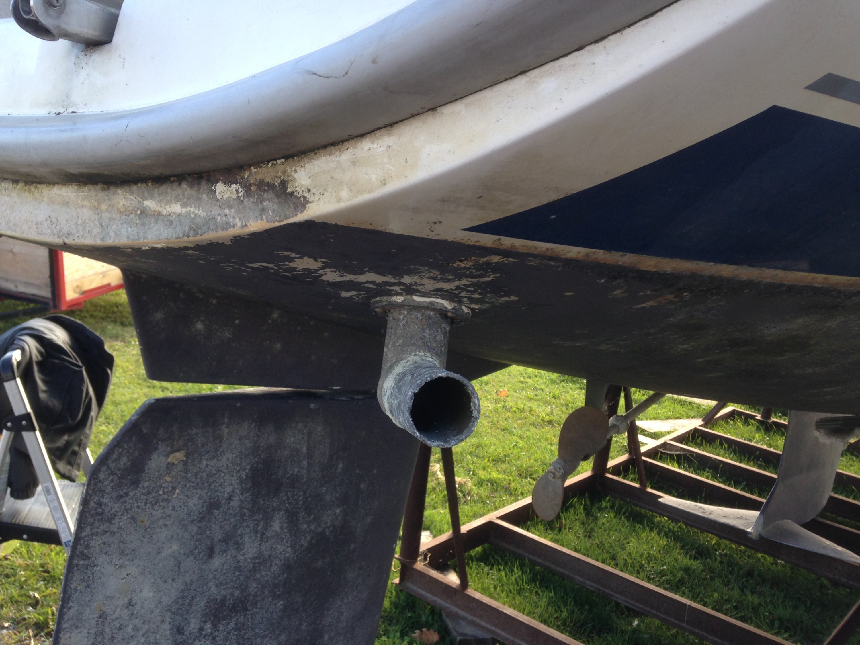

Here is the pipe left on the hull after the rubber pipe was removed. The only thing I can imagine is that some PO had this elbow welded to the original thru hull. Would you risk grinding it off? As you can see, this is well below the waterline so I reall cannot tell about water flow when she is running. Dan
Sep 15, 2009
6,244
S2 9.2a Fairhope Al
i would not grind that off i would take it out through it as far away as i could and get the proper exhaust through hull fitting and replace it ...i understand you didn't put that on there ....but i will say that i detest cross eyed engineering (read rube goldberg)....that thing is not doing you a bit of good and is causing drag when under way like you would not believe and totally looking like a donkey's appendage ....sorry for the rant...but you get the picture
