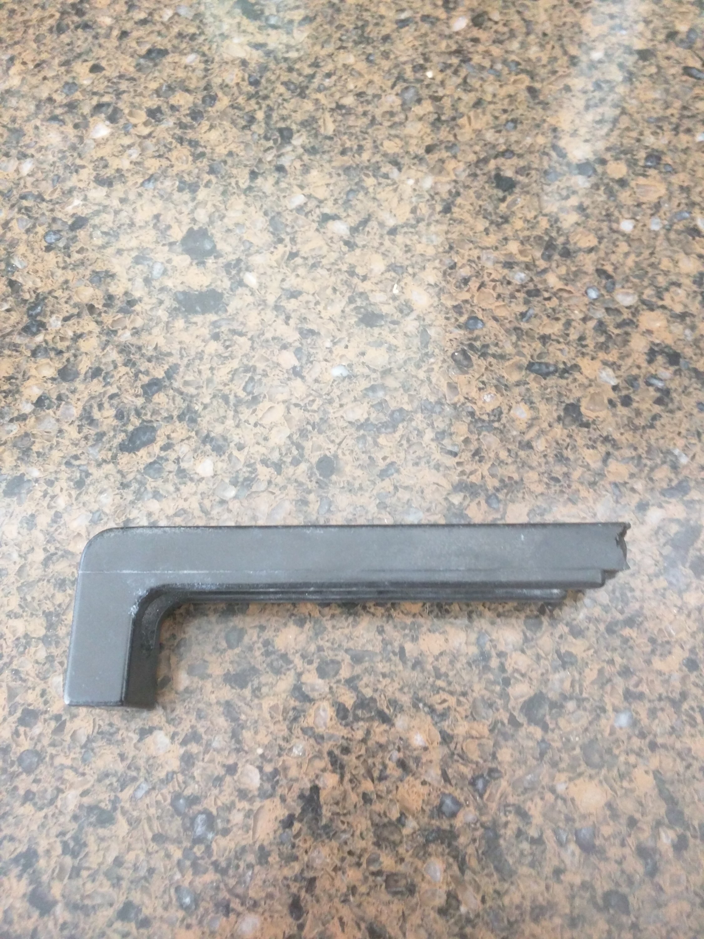

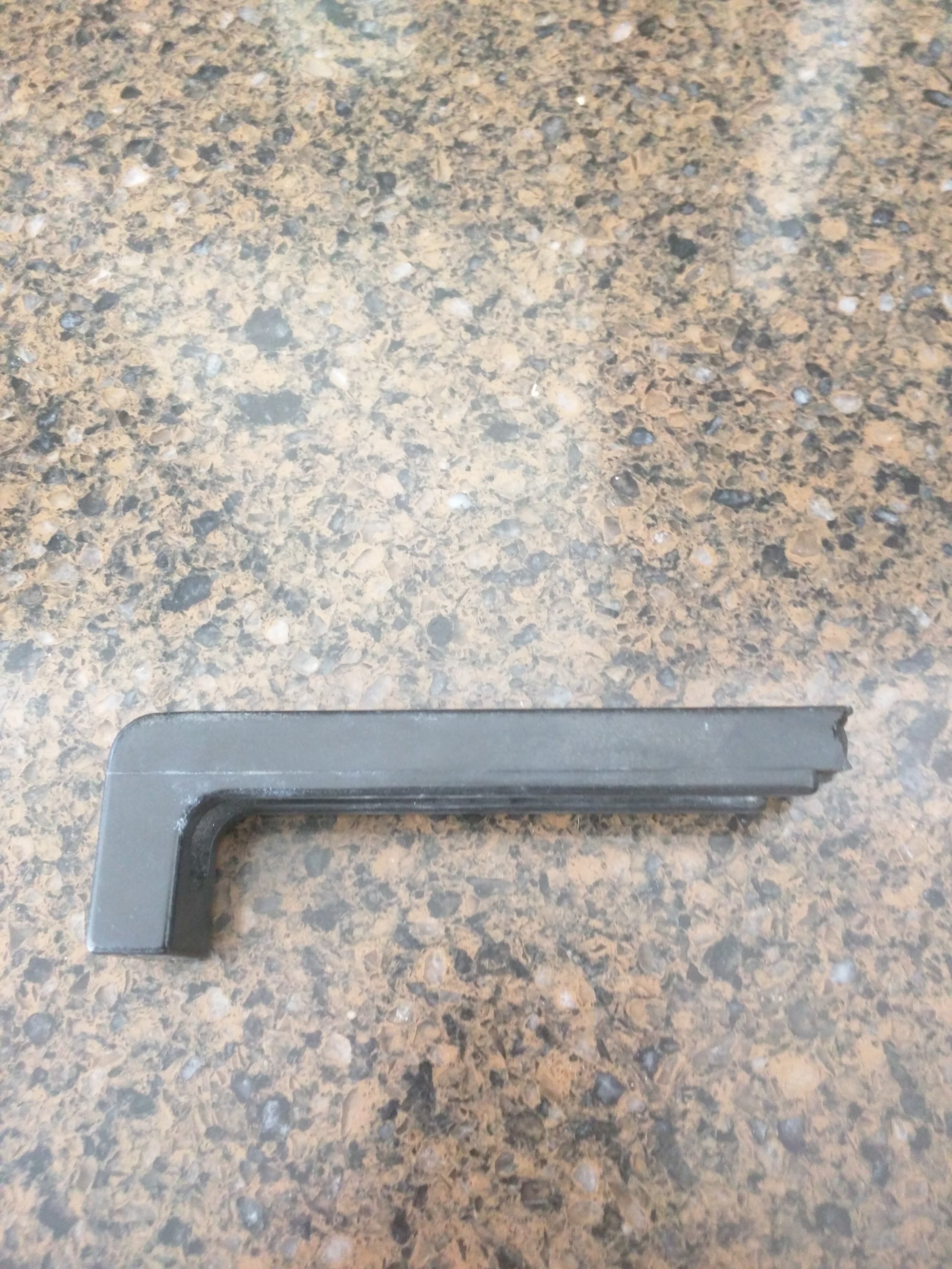

For the hatch locking handles, can you post a picture of the broken one? We could then suggest some search terms to use on various vendor sites.

1) So it rotates on a fastener on the short end, actuating a latch on the underside of the hatch?
2) Or did the right hand end in the picture use to look like the left hand end, so it is just a straight "pull-upwards-here-to-open-hatch" type of arrangement?
3) Is this a vent hatch in the cabin roof, an anchor locker hatch, or what?
If the answer to #1 is yes, I would search marine vendors for "locking latch handles", "hatch locks", or similar terms.
If the answer to #2 is yes, I would search marine vendors for "pulls", "locker pulls", "cabinet pulls", "hatch pull
There is an small chance that a search for "lifting rings" would get you in the right section of an online store. You could also call Marlow/Hunter. If it is for a vent hatch, you could also call the maker of that hatch. Good luck.

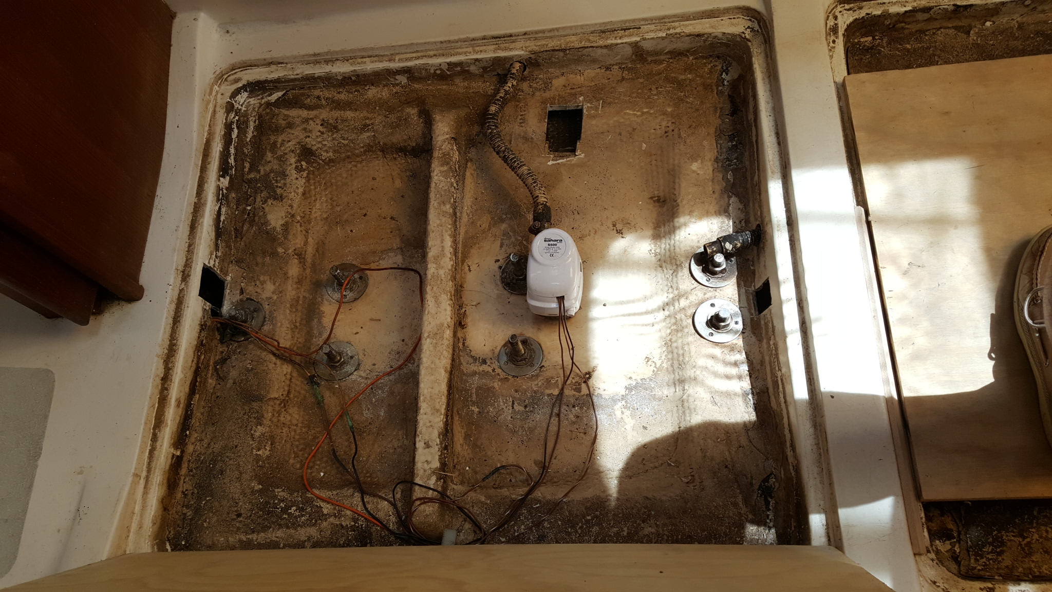

Hi Kommy,

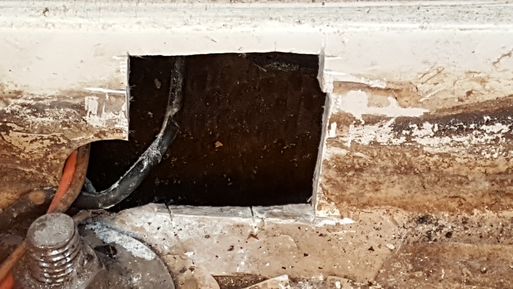

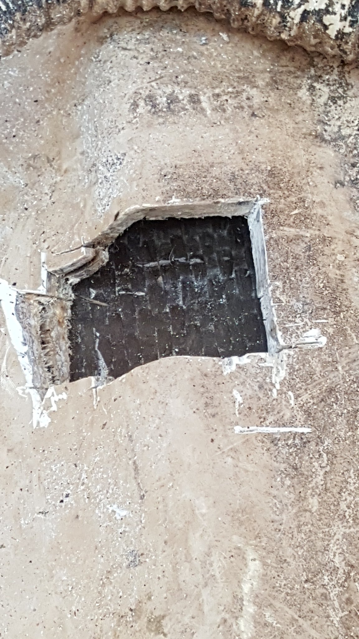

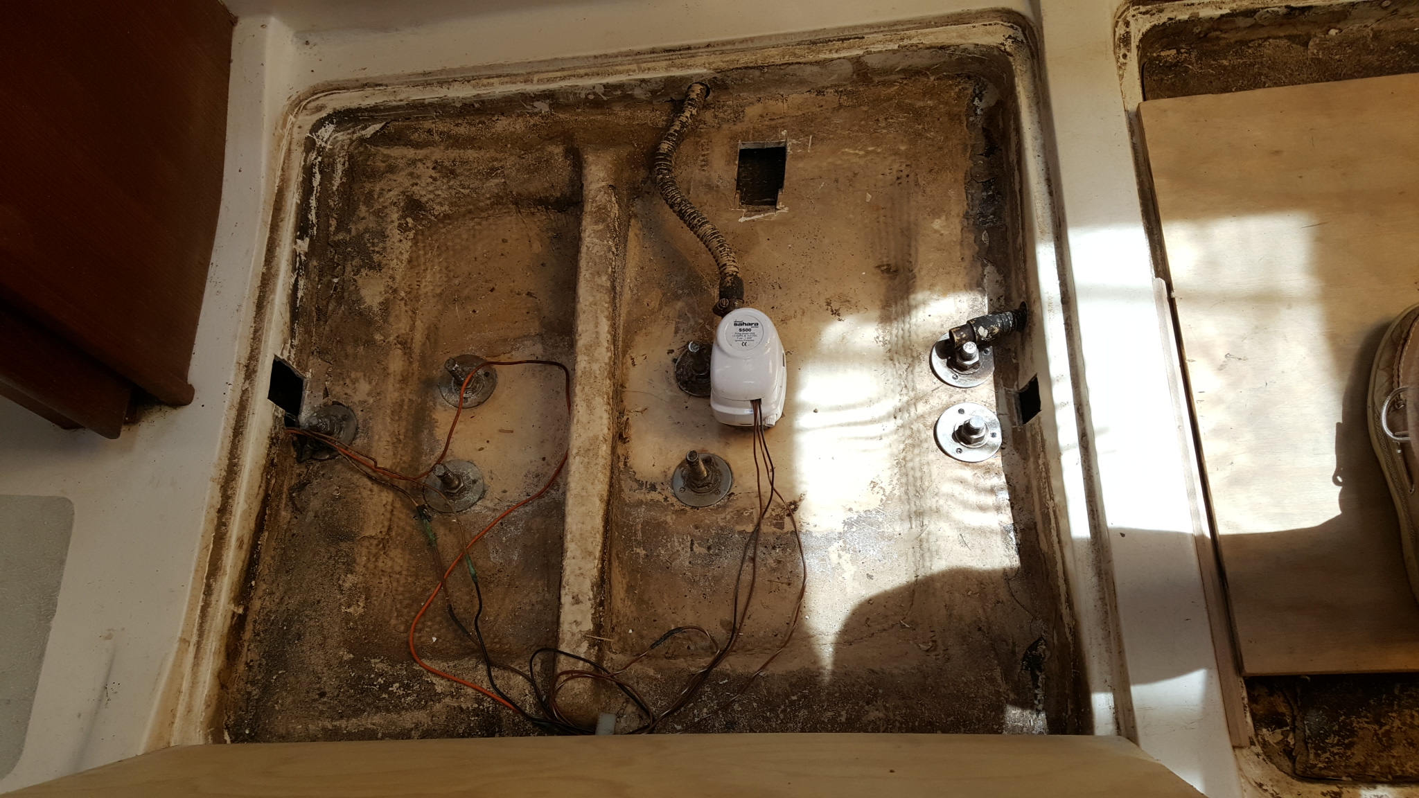

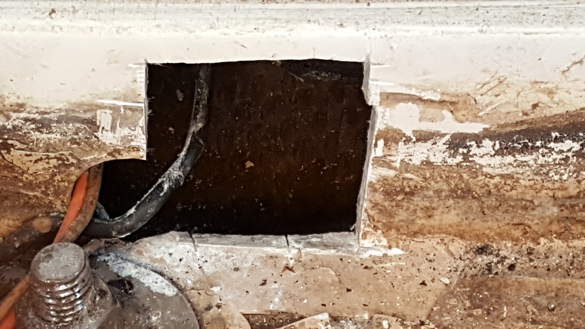

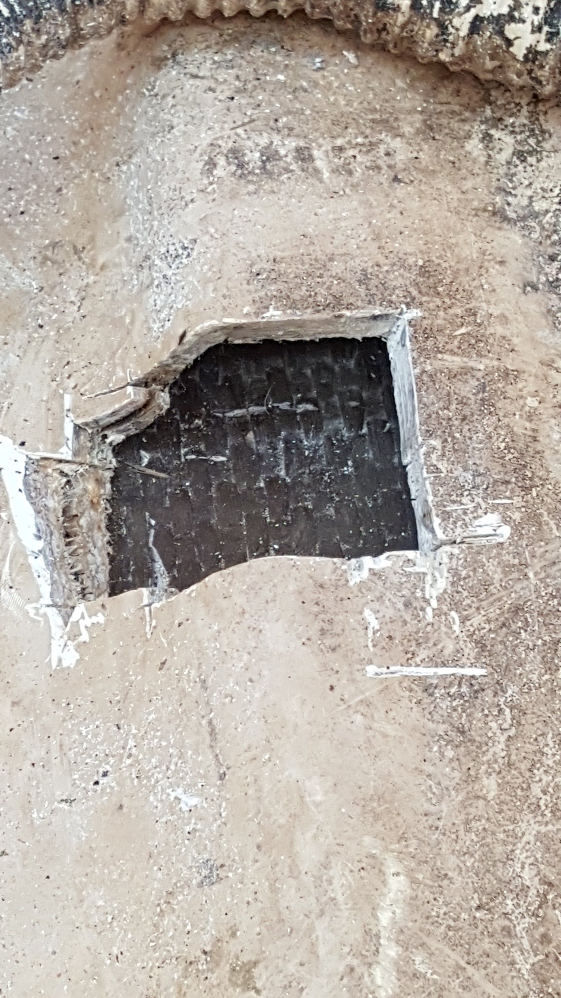

I'm on a quest for a dry boat myself this summer and in the process I enlarged the holes in my bilge with an oscillating multi-tool to give me better access with a Shop Vac to suck the water out and let it dry better.

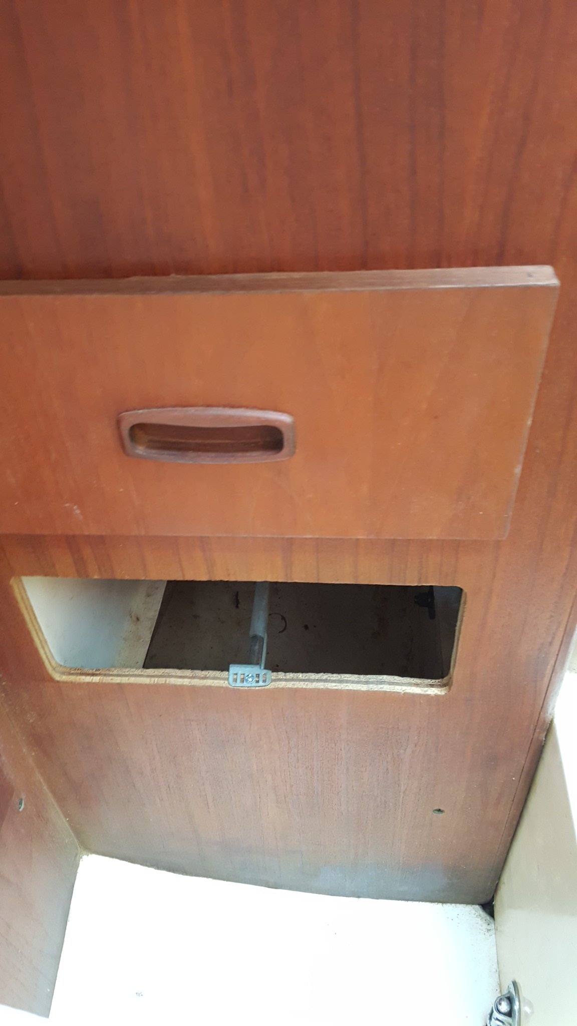

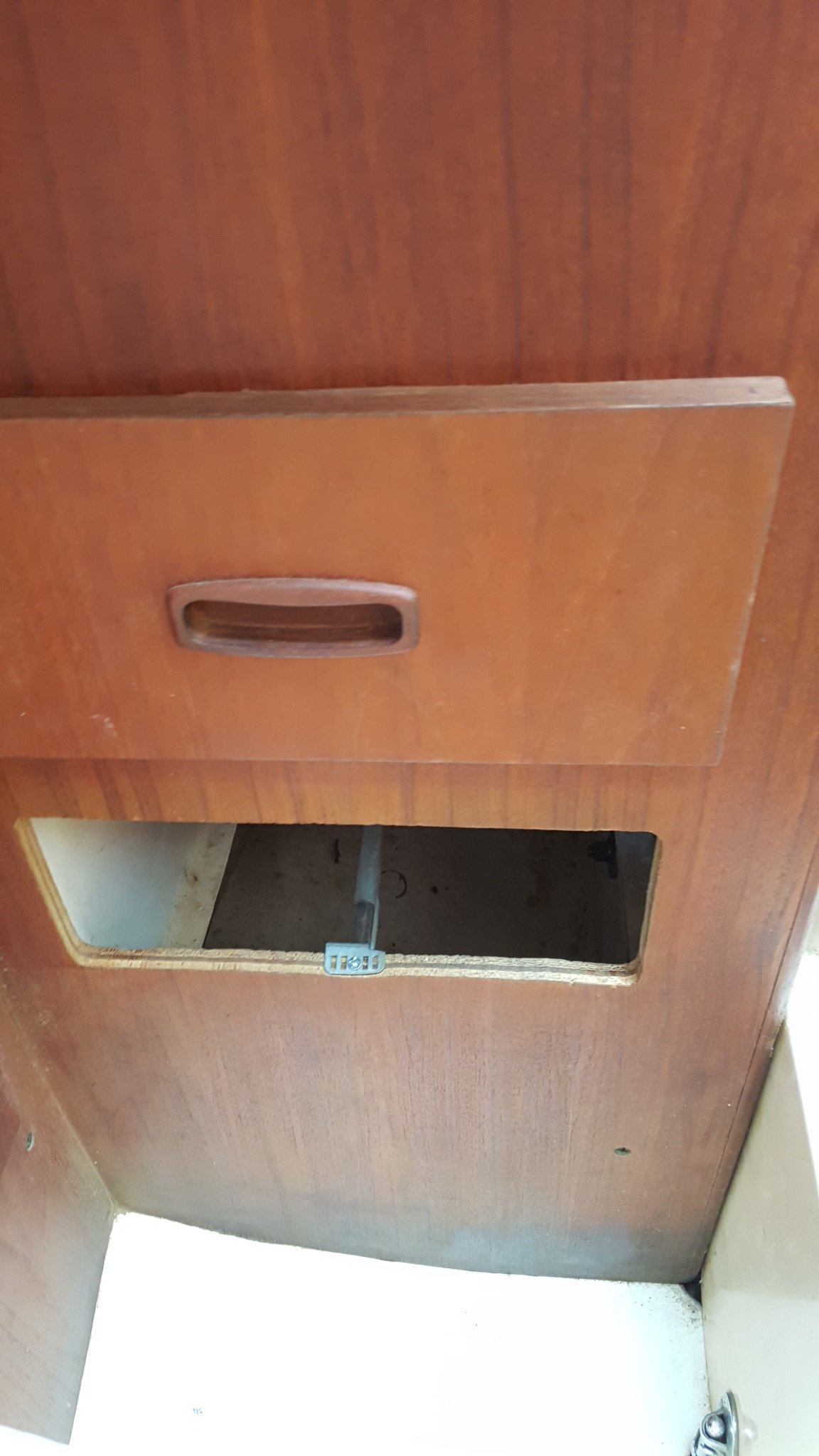

The other place to look for standing water is under the drawers in the galley. Pull out the bottom one and feel down inside, there may be water there also. The seacock for the sink drain is also back in there. You can also see the seacock and bottom of the drawers from the cockpit locker if you empty it out.

Thats pretty much a copy of my bilge except I got a float switch. I'm surprised that those switches pump water only after 2 inches.
That's a smart idea to enlarge the holes connecting bilge sections. I'm gonna do that myself . I just ordered oil absorbent pads and will shove them in those new holes to get to oil first and then will do the detergent and water trick and take it out after. With the bigger holes I should be able to get my big shopvac and suck that out after.
