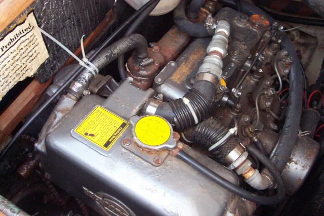

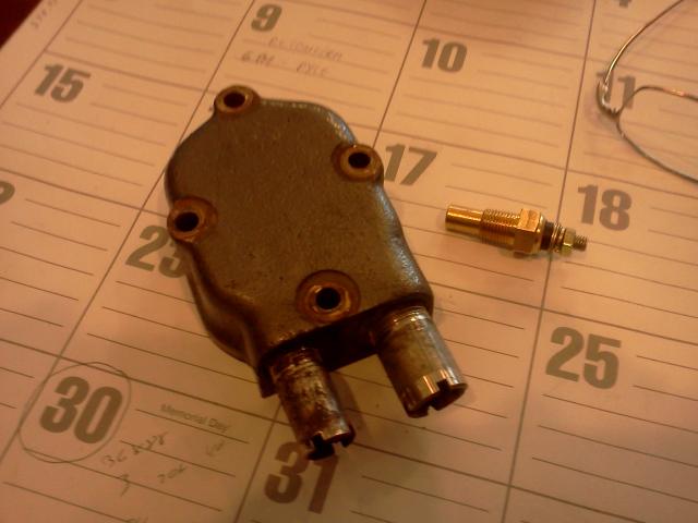

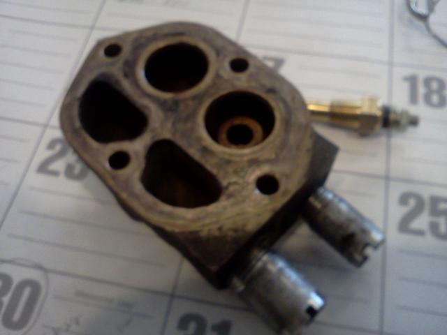

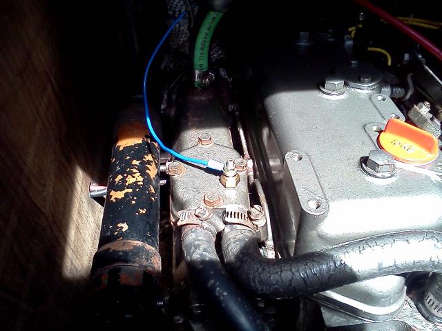

After much research on the location for the new gauge water temerature sender, water hose installation for the temp sender and other possible locations, the answer was just in front of me. I removed the water inlet that seats on top of the engine and found 2 thermostats and the perfect place for my sender. One quick 3/8 hole and thread tapping minute later, I had the sender installed on the cover. Fits like a glove. That was quick, simple and cheap.
