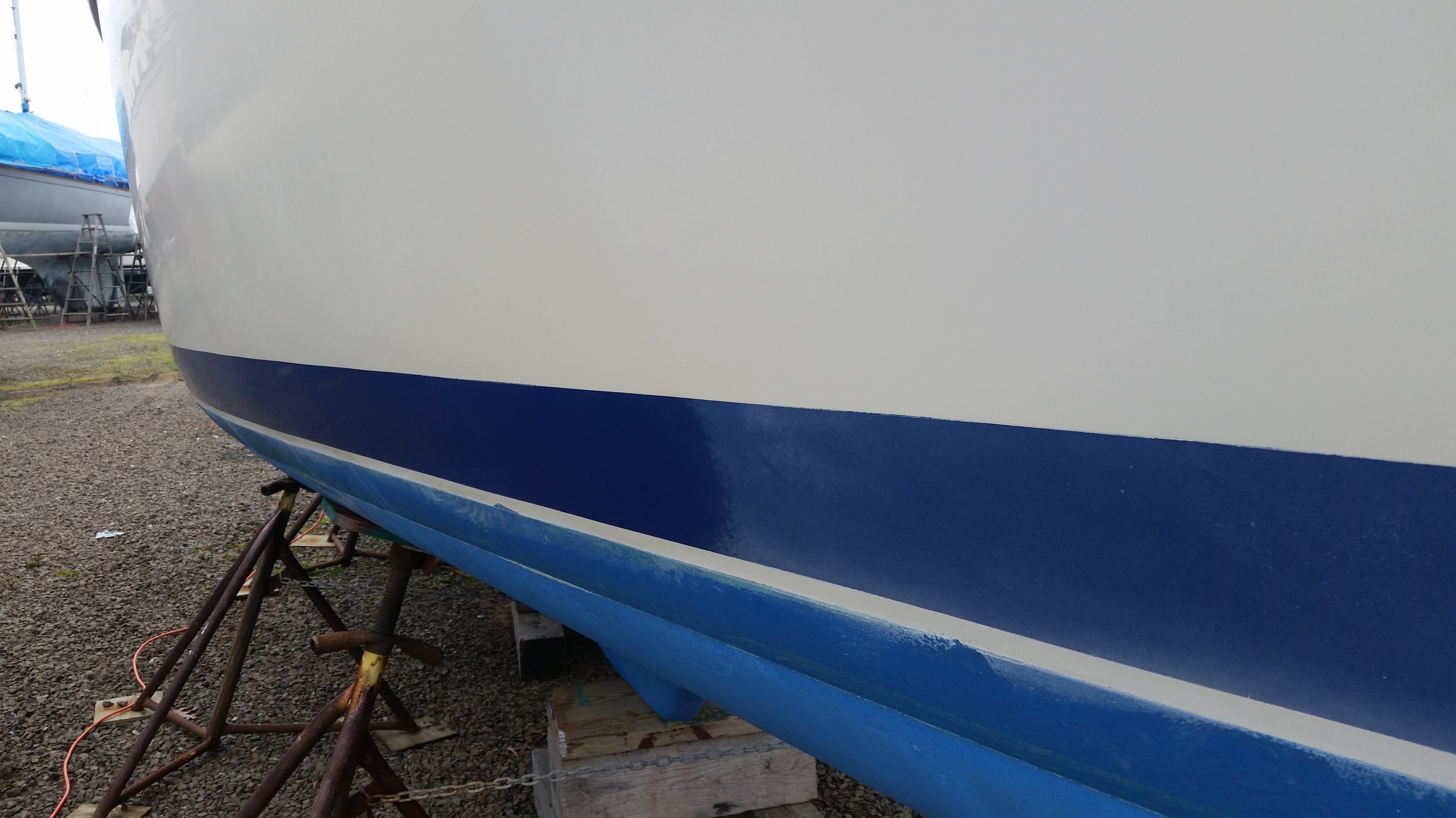

Hukilau April 30 17 waxing2.jpg For the past two or three years, I've prepped my hull pre-launch by stripping the old wax off with formula 202 solvent, then applying one or two coats of high quality wax (Meguir's or Mother's). But the hull has been looking more and more chalky, and the navy blue accent stripes have been looking very drab.
So when I couldn't find my stash of wax and had to go buy more, I was open to the idea of trying something different. I had used a one-step compound/wax product in the past (the West Marine One Step, which had a good write-up in Practical Sailor), but had gotten away from that; I was finding that it didn't do a great job compounding or waxing. For a time, I was compounding then waxing, but finding the time to do both was getting taxing (forgive me Maine Sail!).
Anyway, I was able to see that the 3M Restorer for heavily oxidized hulls seemed sufficiently different from the West Marine One Step to give it a try. OMG, I am so glad I did. I followed the directions on the bottle (maybe a first for me), using a lambs wool applicator, and removing the product before it dried to a haze with a microfiber cloth; I simply couldn't believe the effectiveness of this product. The chalky buildup was removed - completely. And the blue accent stripes were transformed. Really incredible. I was taken aback a bit by how much "blue" in the stripes was being removed by the compounding, but the results are undeniable. The attached photo doesn't really do it justice, but I couldn't be happier. If I can find time, I plan to apply another coat of wax, but it really doesn't look necessary. I will also be applying the product to the cockpit and parts of the cabin roof to remove the chalkiness there too. My wife is delighted that she won't have to wash the chalk from the backs of her calves anymore after sitting in the cockpit.
