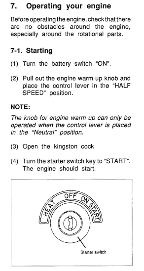

The Yanmar Operating Manual GM Series says open the throttle half way for starting. I do that and then immediately reduce RPM to 1000-1100 for a few minutes then down to idle at 800. I'm quick - no roaring engine, just pull the throttle back after start. I have another version of the operating manual specific to the 3GM30F and it recommends full throttle at start. I opted for the more conservative version.
