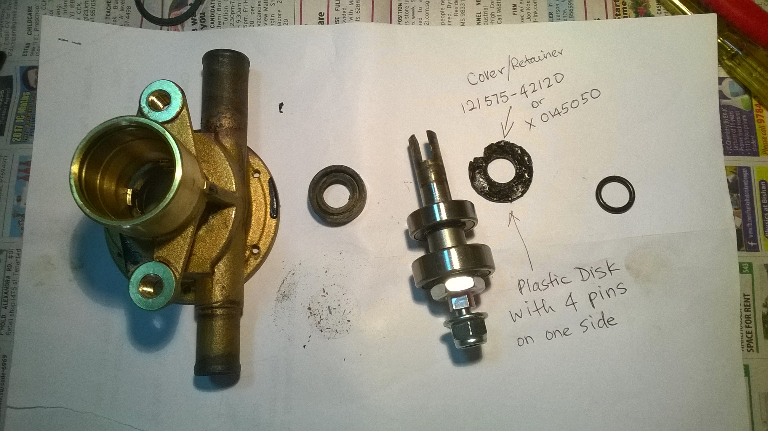

Thanks to everyone for the wealth information. I pulled the pump apart and my internals are different than what is pictured by Ken. Mine is like this. http://www.pumpvendor.com/Yanmar_721575-42700_parts.html I have two 6202 bearings vs the two different sized bearings. The bearings feel good but there are two grooves in the shaft where the seals ride that concern me. I suppose it's worth a shot replacing the lip seal and the slinger and seeing how it goes.

Pump is back together and installed on the boat with new lip seal, slinger, impeller and gasket. I'm still concerned about the scoring on the shaft but I'll have to wait until spring commissioning to see if the new seal did the trick.
