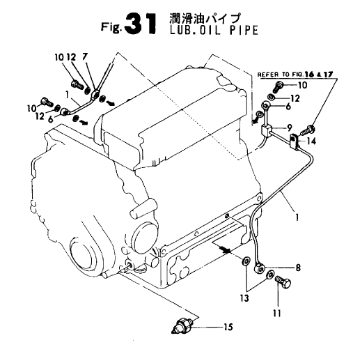

There's an oil pipe that runs across the back of the engine that is prone to corrosion and leakage. Yanmar part number 128370-39200.
Even if it's not the problem, it's a critcal item and should be inspected regularly.
