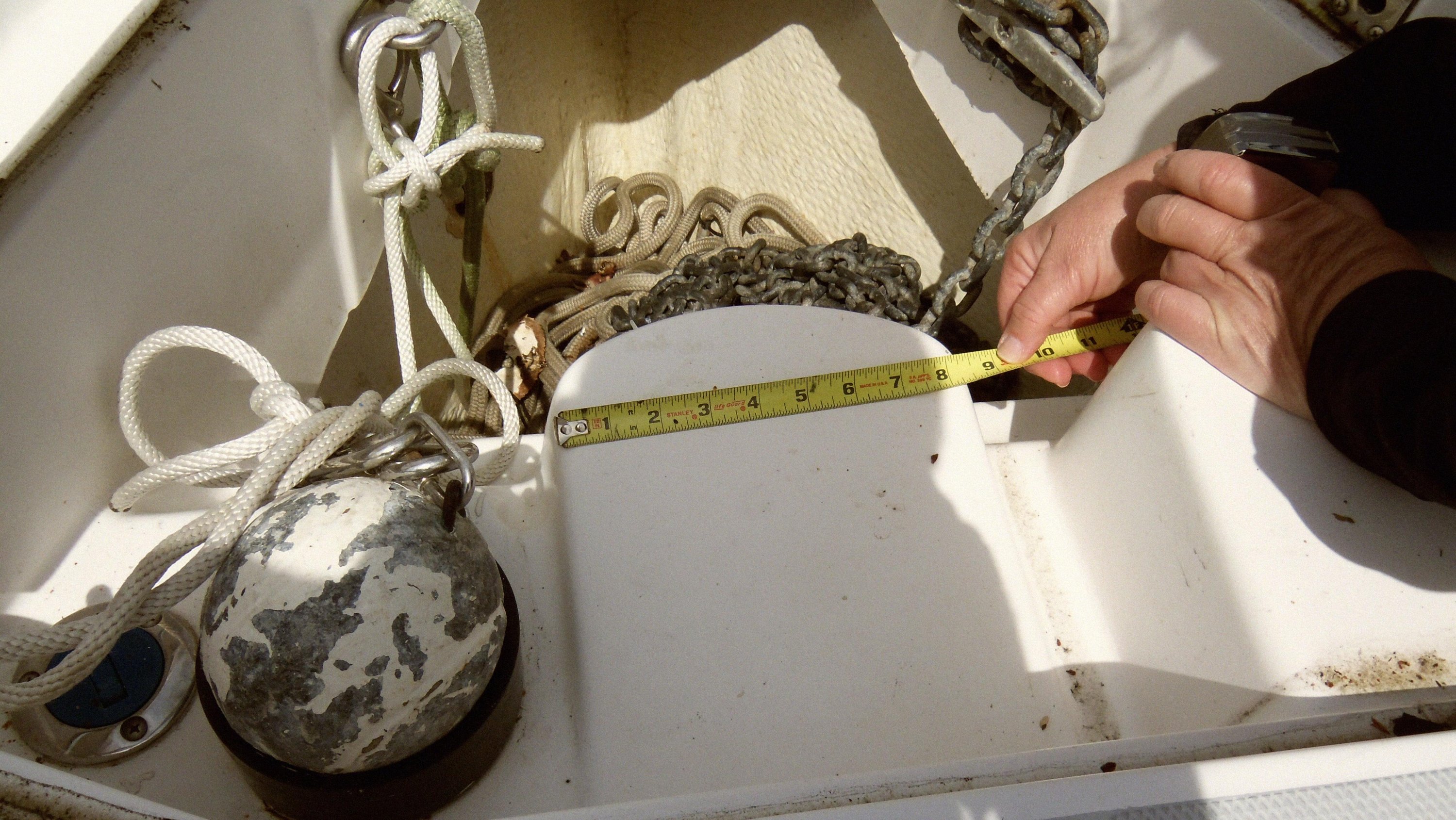

His locker is identical to the one in my link above. You do not need a hawse pipe unless you want the chain to go to the keel as I did. You can just have it go the level below. But that's forward of the v-berth and I use that for storage. If you keep the rode in the locker then you have to put the windlass on the deck. Somewhere there is a post where the locker door was cut in half and the windlass was mounted on the front half of the locker hatch.

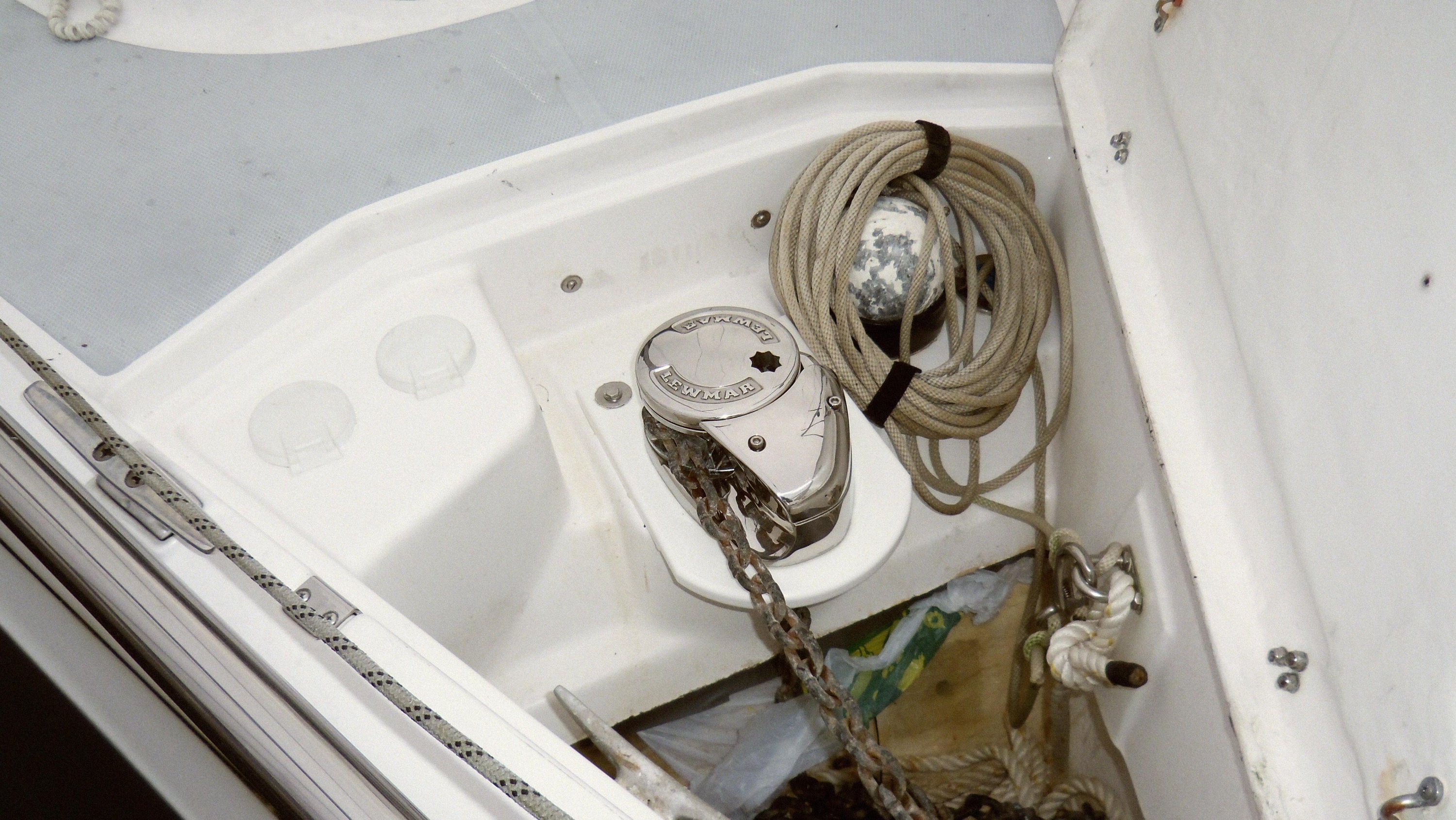

OUCH ! ! ! That doesn't look too easy. Mine has a pedestal for the windlass to sit on and then a drop for the rode of several feet into the locker for storage.

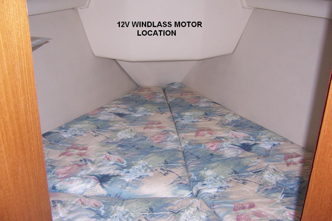

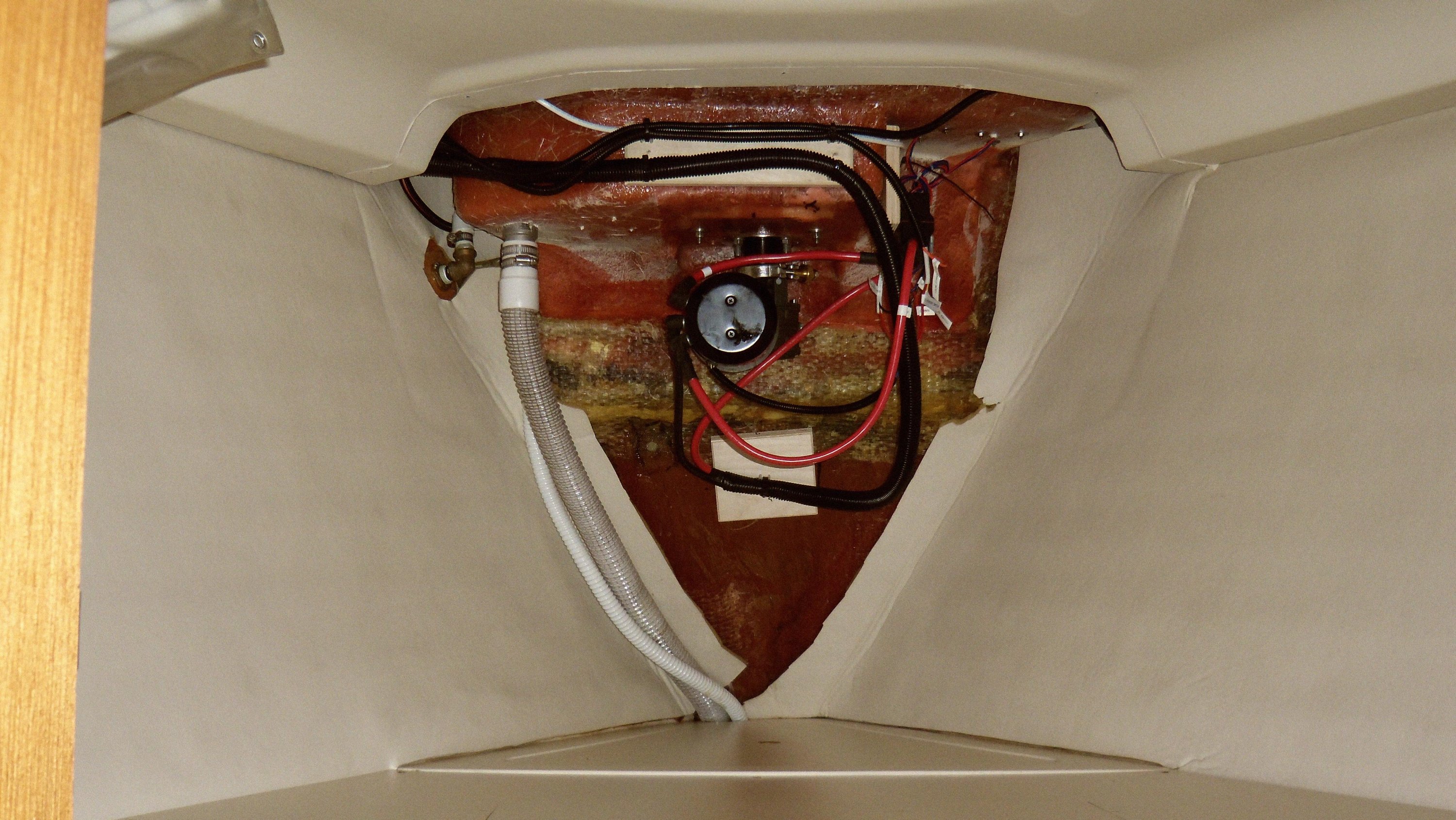

Nice thing about this setup is that the 12V motor sits in the V berth and away from corrosion in the anchor locker
Ventuse ................. bring on the pictures and I'm sure we can come up with a solution as Ed has shown. I believe many of the later model Hunters have the pedestal arrangements which makes life a little easier.
