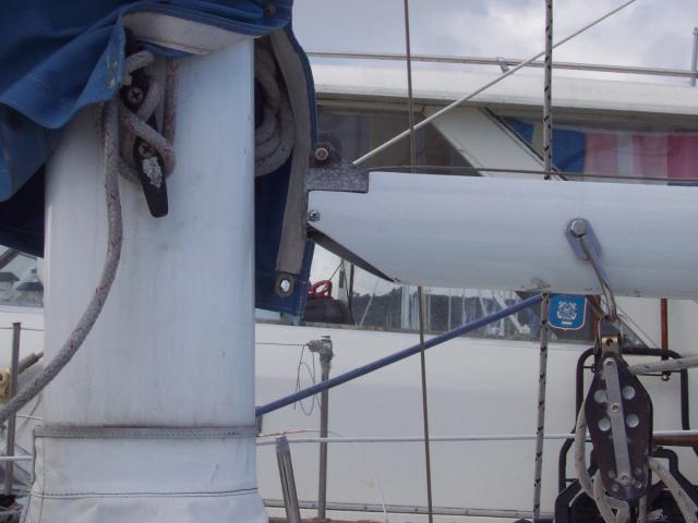

Boy I would give almost anything to be able to run over to the boat and get those measurements Morrie. But the boat is 1200 miles away and I am now a fulltime caregiver. There are a few guys around that seem to be working on their H37Cs almost every day. One of them will have the numbers. I do know that the foot of the staysail is 9 feet, 6 inches. The tack cringle would be about 3" forward of the "tube" end. The outhaul connects to the clew cringle so it is about 3'' short of the aft end of the tube. So very close to 9' 6" for the tube. But you want the real number. Good luck. (Picture is tack end).

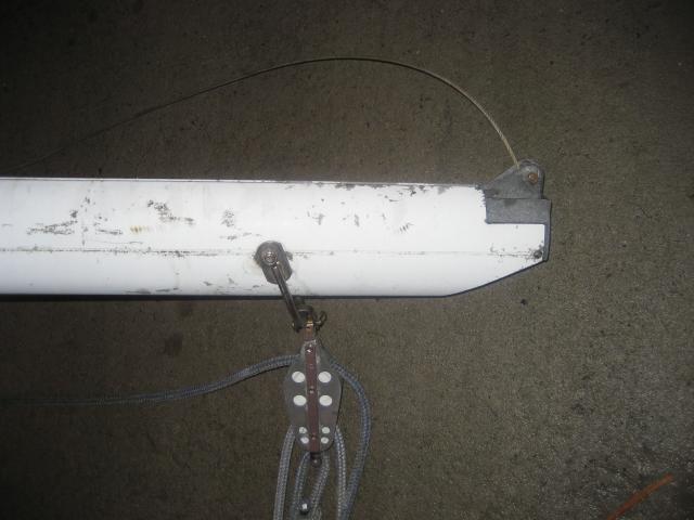

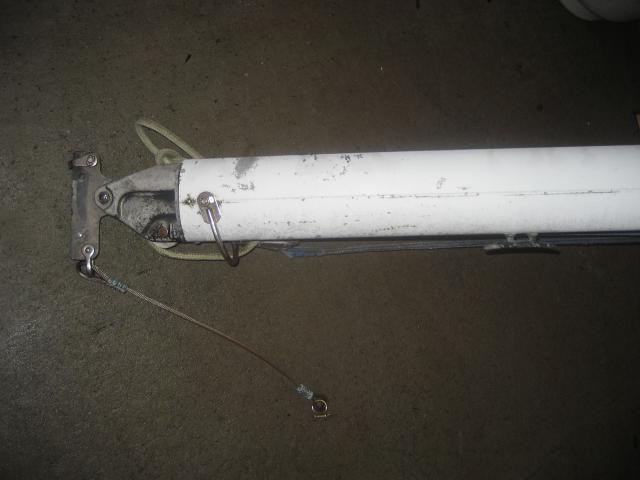

My boom extrusion is right at 10 feet long. Aft end cut away with 2 shivs (outhaul?, reef?) just like a main boom. I am waiting on a local rigger to show up to install stay, then I will install boom, staysail.

Ed, nice to hear from you - sorry you're not getting as much boat time as you'd like. Thanks for the picture - that helps too.

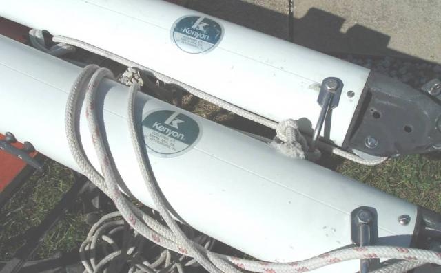

Sorry to be so late to the party, but I did take a tape to the boom and mine measures 117 inches long. (actual pipe ) with a 2 1/4 notch at one end with a sloped cut.
Let me know if you need additional pictures. My mast and booms are at my business.

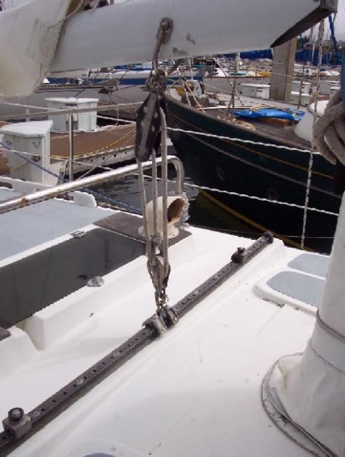

John, looks like your sheeting is original. Does it still go to starboard and back? I installed a turning block at the base of the mast. I run it through a deck organizer to the winch and cleat on the port cabin top.

Yes the sheets go as you described. I have thought of making a change similar to what you describe, it would eliminate a lot of friction. In light air when I let the sheet out it just lays on the deck and the boom does'nt move.
One thing though. I used to get a lot of "pumping" movement from the boom in the vertical direction. That got worse wtih my new sails that are a bit heavier. I solved that by moving the traveller stops outwards and then sheeting in a bit tighter so the sheet put a more vertical force on the end of the boom. How would that be affected by bringing the sheet near the center of the traveller?

Nothing changes John. I do the same thing, our only recourse without the ability to add a vang I think. I don't have any pictures but basically you just turn your blocks upside down. The sheet comes off the bottom block and to the mast block. The over to the deck organizer and back.
I bought and installed double deck organizers on both sides some years ago. But the only line going back is that staysail sheet. Easy to do since the winch and cleat were already there from the old mainsheet days.

So whichever tack you are on the sheet would go to center from the lower block. That would result in a force pulling the traveller inwards - does that create any problem?
