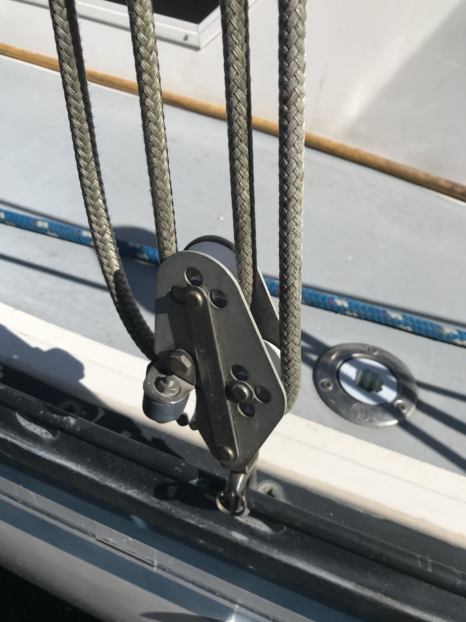

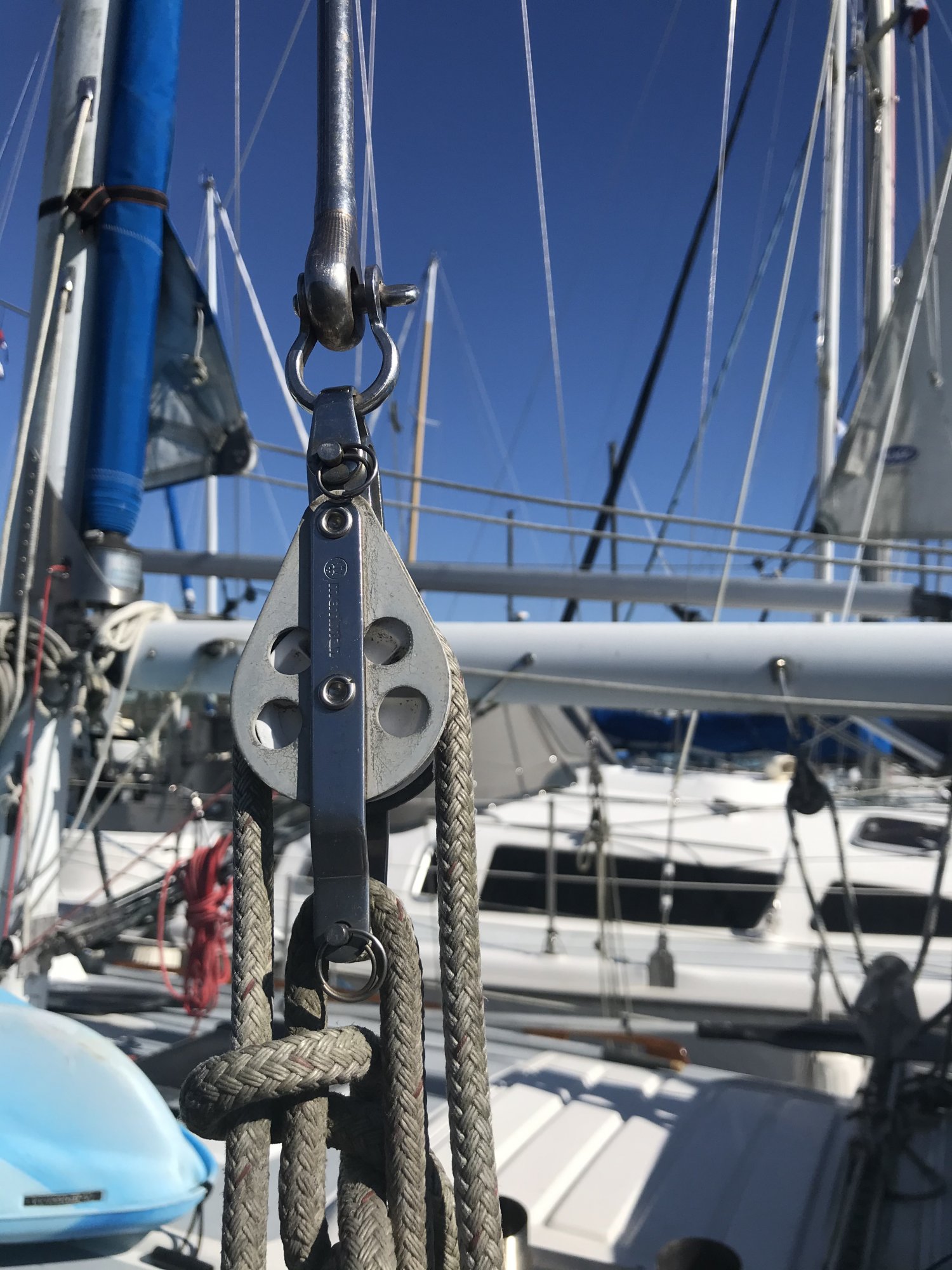

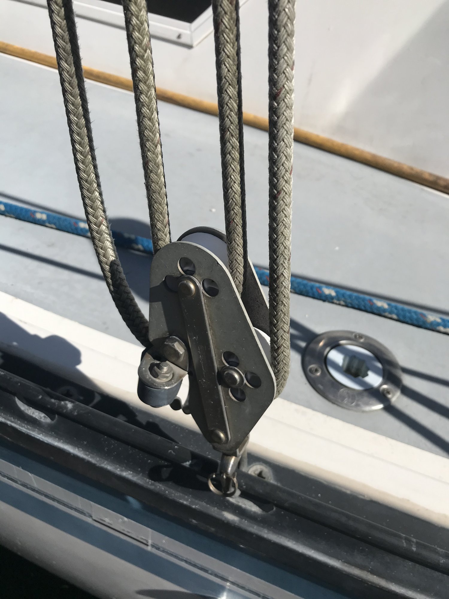

Hi, can any other 37C owners post up some pics of the deck end of your running backstays? Mine were missing when I bought my boat. The tangs are there on the mast but nothing else. Interested in what the tackle should look like.

Will these pics help. From my daughter’s 1984 H37C, “Harmonic “

Thank you both for the replies! Extremely helpful. Based on DoB's detailed description and the pics some of the tackle may actually be on the boat after all, just stashed in a junk drawer. I hope to find the backing plates/evidence for botht he "at rest" position and the working position by studying the toerail. Since it will be few years until she goes back in the water I have saved DoB's treatise separately as well so I don't lose it!
