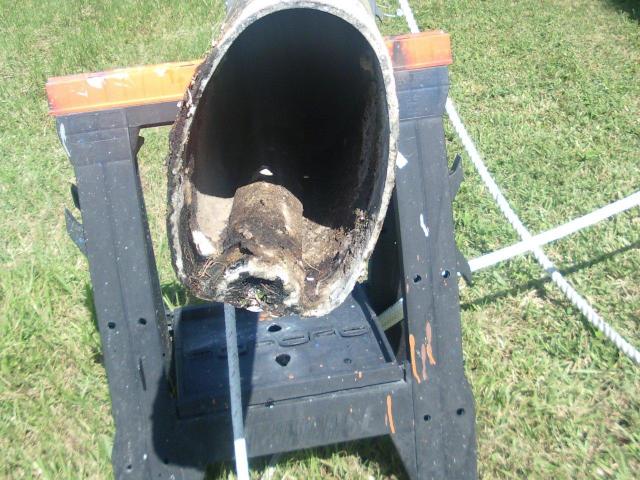

Mast came out slickker than )9*&. My buddy with the irwin 38 took longer to get his free. Crane operator took up slack, rocked the boat p&s and it broke loose. Lifted a foot or so. Popped out the kenyon rubber collar. Photos and link to video tomorrow. Celebrated with adult beverages and typing skills are the foirst to go.

Don't encourage her to go back to the organ/piano/church choir. It cut badly into our cruising. I bought this boat when she re-retired.

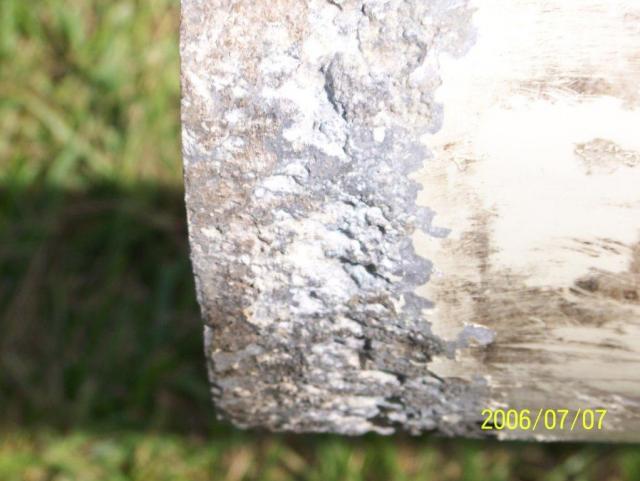

Re thinking mast. Badly pitted about 2-4 " above the base. Plenty of metal at he bottom, gonna look into having a sleeve welded on.

Step looks grungy. Gonna pull it out and clean it up. New bases at Kenyon are epoxy coated black colored. Malthrin reported $250 . I can save mine for less than that.

The mast base was indeed somewhere in the area of 250$ but if I had remembered better the condition mine was in I would have kept it. The base plate and mast are the anodic component from in the assembly what I've seen (meaning they are the one corroding). The base plate does corrode a little but not as much as the rest does. Mine wasn't in a bad condition.

humm, don't know if welding a sleeve over the existing mast is such a good idea, first it's gonna be a lot harder to pull the mast out from the deck and put it back in, plus welding will alter the properties of the aluminium (won't be T6 anymore) in the area it's welded.

While Mathurin is right about welding heat changing the properties of the metal, I don't think you need to worry about that. I was production manager in a fab shop that produced equipment for fisheries and aquaculture. We regularly welded 6061 T6 and 5052 marine grade aluminum, often in structural applications, without issues. Actually, it is when you cold work aluminum (ie hammer, spin, etc) that you need to heat treat (anneal) it to avoid cracking. The top of the mast and the speader stubs were welded on your mast. Enough said.
Of more concern is the clearance you have to pass the mast through the cabin top. An external sleeve may add too much to the diameter. I think Mathurin's idea of cutting the damaged section off the bottom of the mast and building a "taller" maststep is a very elegant solution to the problem. Good luck!

I think the sleeves are usually inside the mast.
My HV'36 is a 3 section tapered mast. The sections appear to be riveted together. I have no idea how they did this, but it works.
I see masts that are sleeved all the time. If you paint them, you would never know if you had one or not.
