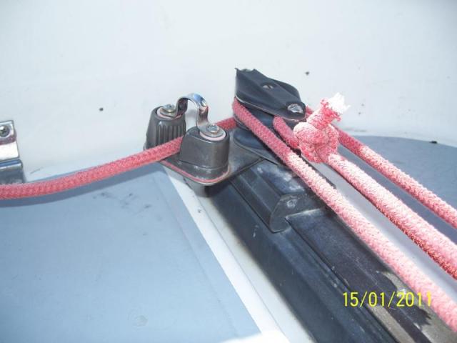

I used Harkin track car and control ends. High profile track does not have holes in the top of the track. They are captive and internal so less chance of leaks. Here is a picture.
Mark
Hi Mark,
Thanks much for the picture. I like your setup. I hope the the forward facing cleats won't be awkward to use. You taught me something I did not know. I did not know the original traveler had teak under it. The PO did not give me that piece, probably because he had to destroy it for removal.
Jim

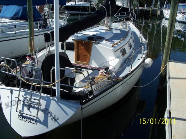

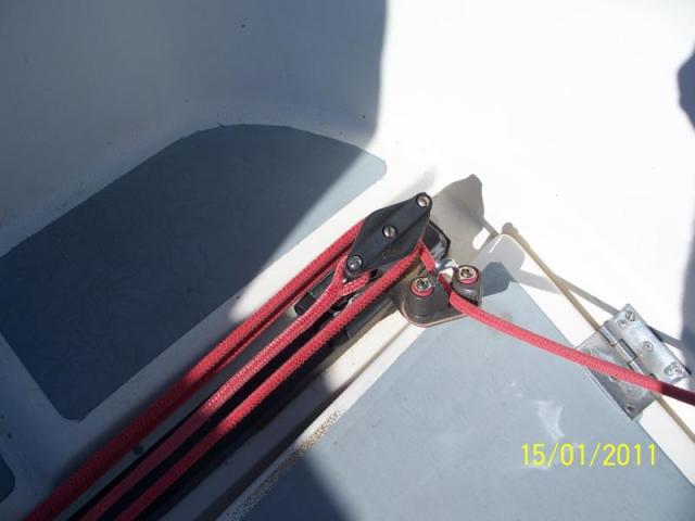

Traveler pictures from Blaise
Blaise is working. . . .in Ohio! He sent some pictures that he asked me to post that are germane to this thread. Actually I forget how we got here but I'll post them anyway. Adjustable traveler and jib track on a winning H37C named "Midnight Sun".
P.S. never learned how to post pictures in the thread.
P.S.S. just noticed the crank on the backstay. Serious stuff!
