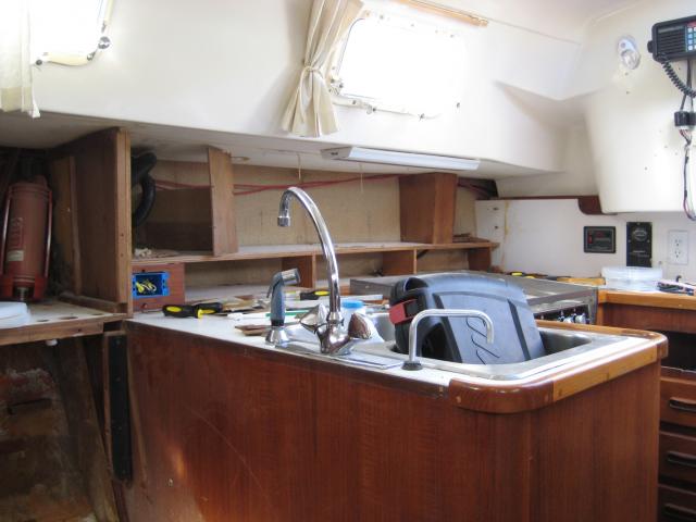

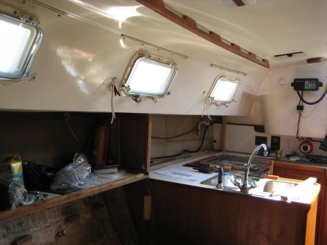

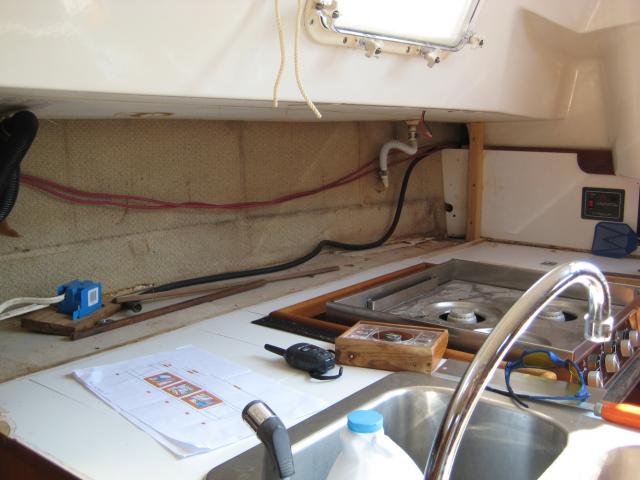

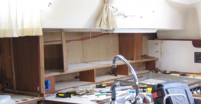

Hi
I looked briefly at my galley last week since I am also replacing the sole. The sole is under the sink cabinet. It looks like thats the only thing on top of that piece of sole. So far, all cabinets I have removed are held to the floor with cleats (1 x1 mahogany strips. not teak, much darker)
I plan to remove the galley and lower it 2 cm in order to install new granite counter top. However I am about 30 days from there. It all started when I decided to do a hull repair on the bow while doing a hull paint job. I removed the anchor locker cabinet. Then I decided to replace that nasty wall fabric with a white liner with teak battens (like the endeavour's cabin) That led to gutting the head and replacing the nasty cracked sink with a new granite counter top with undermounted sink. That led to removing the cabinets in the main cabin and rebedding the chain plates, That led to removing the old looking electrical panel and having my local engraver make a new one complete with digital meters. And on, and on. Well you know the rest.
I have so far removed the sole from the forward cabin, head and port side. I have found teak plugs on the sole but no screw under the plug. I wonder if they are decorative only. My sole was attached with some sort of glue/caulk. You can see the lines on the fiberglass when it was applied with a caulk gun. I started on a corner and introduced long cedar wedges I made from leftover shingles I had from a repair. This pulled the panels in one piece and can use them as patterns. I have calculated 3 sheets of sole @ 175.00 each plus freightof 125.00 I am also rewiring and re plumbing with PEX.
I plan to seal the edges and underside of the sole in order to retard moisture and delamination. My sole is 30 years old and you can pull the veneer layer with your fingers.
I am working all day sat and sun on the boat. I had it moved to my place of business and parked it in my parking lot. It's a lot easier to work on it.
I will take a better look at the galley and see whats involved. I will take pictures. I just removed the electric stove last week and sold it on Ebay.

Well Jose, you are certainly not alone. I'm in the end zone of a total interior refit which I started 18 months ago. This included starting at the bow and demolishing everything back to the Galley. I left the lower galley cabinets but removed the rest, nothing was put back in its original configuration. The sole; I'm just finishing a new one at present; I have managed with 2 sheets, although as I have extended the seating this enabled me reduce the width slightly and by using quarter round I was able to only use 1 sheet berth to berth, this left the other sheet for the forward cabin/galley/aft cabin. Once you take the cleats out of the lower galley cabinets and remove the sole it is possible to slide the replacement sole back under; it's quite flexible.
